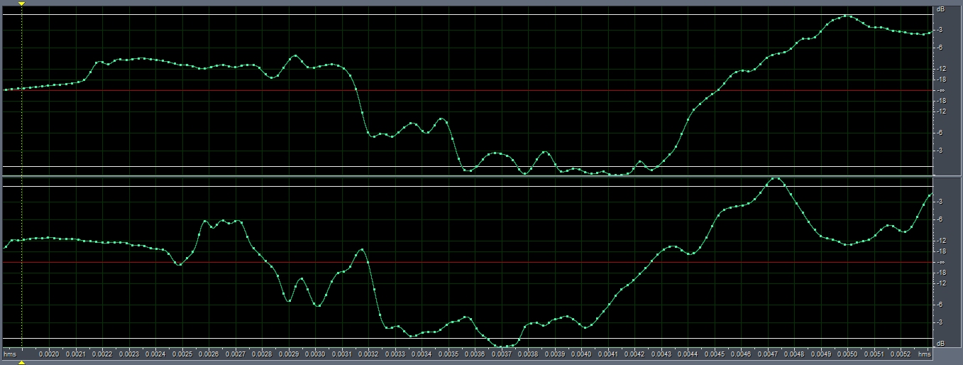

I define step function in the mathematical sense.post157,
looking at pic1 & pic3 I see a few very fast changes that approach "steps" in the signal.
Mr P
how are you defining step?
it looks like some people think that the initial hit of a percussive instrument looks like sudden (as in from sample "n" to sample "n+1") jump to digital max/min i.e. a need for extreme slew-rate.
if such extremely fast transients indeed existed in music, there would be reason to believe that sampling at a lower rate (44.1k) is not enough and that low-pass filtering at ~20kHz is audible.
attached is portion 22.311..22.314 from 3rd pic (tom) zoomed.
The cymbals hit with hickory sticks have a very steep attack. Not as steep as the math fuction thou
