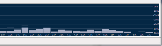

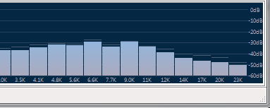

I don't trust RMAA too much anymore. Open the file in foobar2000. Activate the "Spectrum" in the bottom panel.The Krause-Plant track is one I bought from some HD site. I'm puzzled by it, tho. RightMark shows that it has content above 20KHz, but Audacity does not. Why?
This is what "Hells Bells" begginging does (quick PrintScrn from LP to 24@96k).
But witout a good DAC and some good headphones is unlikelly you will notice something. You didn't say what you have. I have now E-MU1820 and Grado SR60i (for PC).

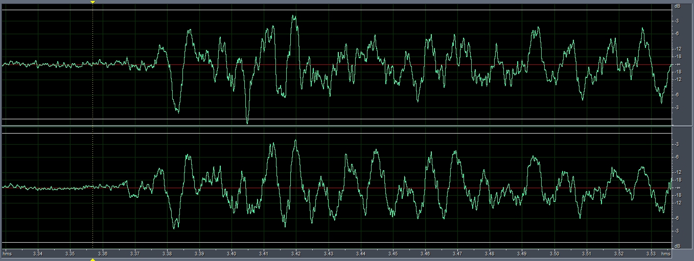

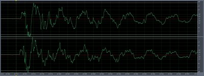

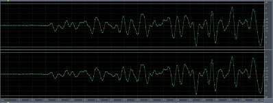

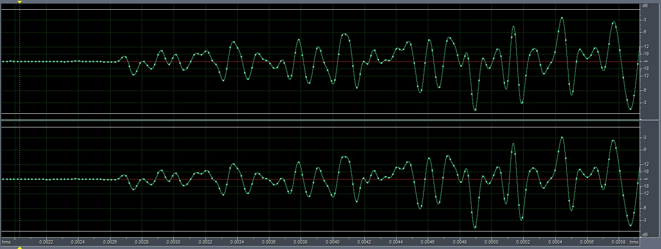

anyway since we touched on the transients issue a bit I thought about adding some waveform screen shots of percussive instruments. I'm not sure everyone looked at least once. I'm attaching a .zip containing the respective sounds so you can get an idea. kettle drum, tom and some unknown metal percussion instrument, all off audiophile recordings. the samples are ~1s each so I don't think I'm breaking any copyright. as you can see there's no "step-function"-like portion as some might believe. the reason "metal" is zoomed in more is that is has more high-frequency content (hitting metal object). "kettle" and "tom" are zoomed out so what looks like very sharp transients actually spans on many samples, you can see the different X-axis units. I selected these off tracks where the respective instruments are played independently (no other sounds except decay tails from previous note) so that the rise from silence is more obvious.
