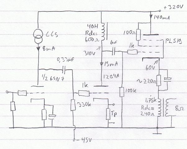

I have a pair of 3,5k/8 15W OPTs that I bought for the 808 project, now I´m getting curious how these would perform wired as 1,75k/8 driven by PL519 followers.
The transformers sounded quite good when i tried them in a tiny spud amp last weekend and they would probably sound even better with properly sized output tubes.

A CF on top of a mosfet CCS, cap coupled to an autoformer is something I´ll try someday.
Until then, the idea of a PL519 CF amp with my existing 3,5k (miswired to 1,75k) OPTs seems more and more appealing.
If done right it could be very minimalistic:

rdf: You´re right, we don´t need much of a driver tube to get 120V p-p. 1mA is much less than any plate current I´ve ever operated any tube at. I have this thing about high current, low Rp drivers...

By the way, there seem to be some confusion about the specs of my output transformers.
I bought them on Ebay a year ago and the specs says:
3,5k
150mA
20W
2kg each
Another guy is selling transformers that looks exactly the same but are speced as follows:
3,5k
90mA
10W
1,75kg
Don´t know what to believe, what bothers me is the DC current rating.
If the transformers only can handle 90mA they might get a bit upset is I push 140mA through them...

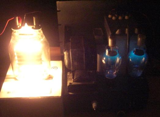

korneluk said:BTW, I still like the idea of a class A2 SE DHT cathode follower.
My two favorite kinds - blue mercury glow and thoriated orange glow. Just a little teaser shot before the holidays...
