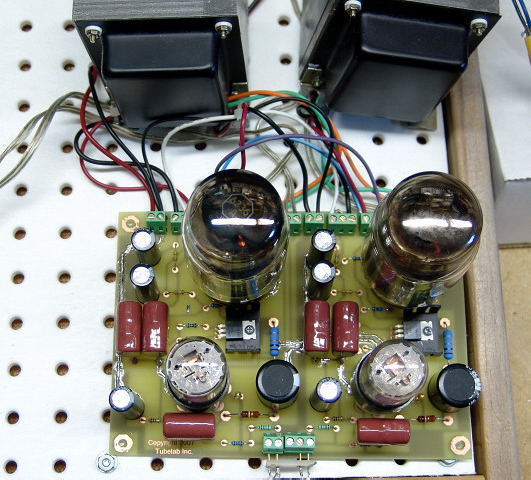

I have returned from 3000 miles in a 9 year old station wagon. While Sherri was driving, I laid out a PC board for the cathode follower amp. I followed the schematic that I posted previously (#22) except that I used octal dual triodes for output tubes. Both sections are used in parallel with independent bias adjustments for each section.

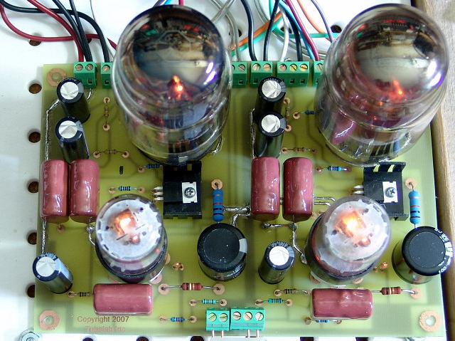

I cooked up a board yesterday, populated it last night, and fired it up today. I used the output transformers that I got from Jeb-D (post #34). I connected it up to two bench power supplies. It worked quite well from initial power up. I tried 6AS7's, 7236's, 5998's, and 6336's. My power supplies were limiting me from exploring the upper limits of power output. With one channel operating, using a 6336 at 180 ma and 275 volts, I was getting an easy 15 watts an 1.9% distortion. Clipping showed up at 19 watts with my power supplies current meter pegged.
I connected up both channels, but power output was limited to about 8 to 10 WPC due to protests from my power supply. I used the small Knight power supply for the driver stage but it only goes to 400 volts. The driver works best at 450 to 500 volts. I used the Fluke for output B+ because it will go to 300 mA. I set the voltage to 300, which dropped to about 280 under load (about 320 mA at idle). The sound quality is very nice. The amp is clean and solid. Bass is very good up until the point that the power supply goes crazy. I guess my next project will be a temporary power supply. Long term I plan to use a SMPS. The cathode follower has excellent PSRR, so this is the amp to use for SMPS experiments.
I made the PC board so that I would have a stable but powerful platform to try out several experiments on a cathode follower amplifier. I decided to go with the dual triode output tube because I had several different types to try that all have the same pinout. Now that it is working, I will go with it.
In my recent travels I went to visit a freind who just bought 20000 square feet of surplus. I brought back a few hundred pounds of vacuum tubes, including the well used 6336A's that are in the CF amplifier. I also found several E130L tubes. The data sheet says that these were made for cathode followers. With a Gm of 27000 and 27.5 watts of dissipation, these may be perfect. That's the drawback of using a PC board, you can't just rewire the socket and plug them in.
More experiments to follow, after I make a suitable power supply.
Next, make measurements to test the "Eastern Audio" OPT's.
Hi Tubelab ! The only E130L i ever saw were in BW video amps : 75 ohms load CF .
These look like typical sweep tubes, but the surplus dealer said that he removed them from "industrial power supplies".
What are you using for the ccs ?
I used the IXYS IXCP10M45S IC that I use in my other designs. I have used the Supertex DN2540N5 also, but it is only rated for 400 volts. I am running about 400 volts currently but I have had this board to 500 volts with the IXYS chip. The 6EM7 saturates at about 70 volts, so the chip sees about 430 volts with a 500 volt supply. IXYS makes a 900 volt chip, but no one stocks them.
Can you post a diagram of the mods to dual triode ?
I will post a complete schematic once I draw it up. The current PC board has no bias circuits on it. This will all be handled by another PC board in the final application. I am currently using a small PC board with several trim pots for bias adjustment.
