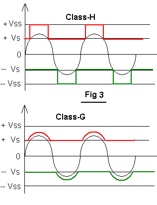

Re: Correction.
You Switching pattern is Step Square Envelope , its class-H not Class-G....
Class-G has Linear Step Envelope........
G.Kleinschmidt said:I made an error in my first post - the stepped supply rail switching is class G, not class H.
OK....I just dusted off my text books. I was right the first time round. Class H it is. I recently read some BS on the internet that called it class G and didn't check up on it. I designed that amp too long ago, and havent dabbled in anything but class A and AB since, and couldn't remember!
