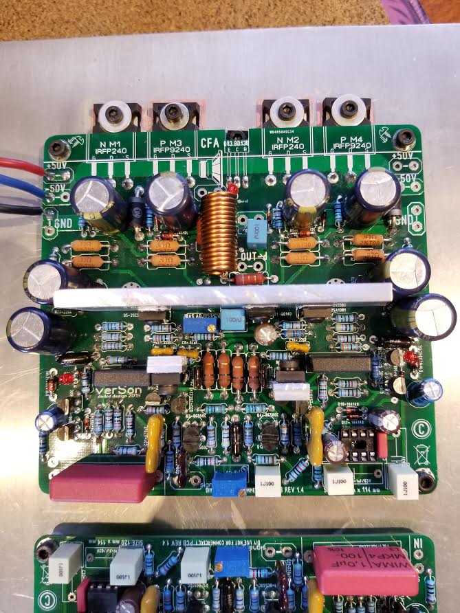

Hi Dadod,
I was able to complete soldering the OPS components today, including drilling and tapping the heatsink. That took some amount of time to get it done.
Hi Fred,
1. "Powered up and did the VAS measurement, (R14 - R52) started at .525 Vdc and keeps on rising till it reached .635 Vdc."
That gives 52mA to 65mA of VAS current and that is not good. I hope that your measurement is wrong (probably 0.0525V). Don't change R14 and R52, measure voltage drop R5, it should show 1.3ma to 1.4mA of a current.
2. "I also tried to set the transistor bias to .03 V or 130 mA but after a while it start to drop. What is the proper way of adjusting the bias?"
Thermal compensation of this amp is a bit overcompensated (just in case no to go in thermal runaway). Correct the bias current after some thermal stabilization.
3. "Maybe this is the effect of using BC559 instead BC560?"
It should not influence it, but I hope that you use a pairs BC549/559?
4. "The DC offset goes up and down 8.3mv to 15mv without the op amp. With op amp installed, -2.5mv to 6.7mv. Is the fluctuation on the DC offset normal on this amp? "
If you've got so good result of DC offset before the op amp inserted ir's strange to fluctuate it so much after the op amp was inserted, check that is all according to BOM.
BR Damir

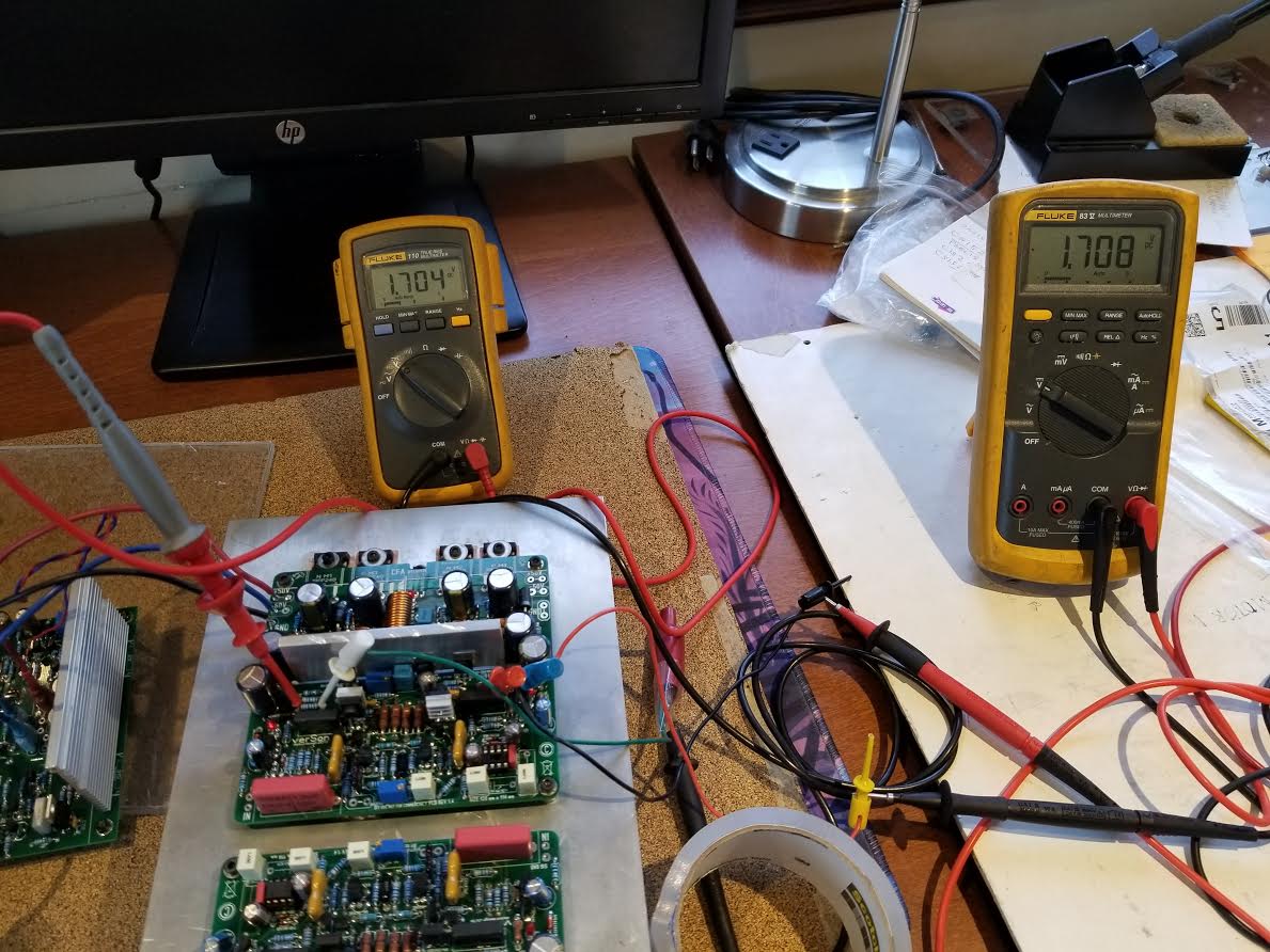

Hi Dadod,
Based on your assembling instruction on post #911. Current reading thru R14 & R52 should be between 4 - 8 mA. Which is V= .004 x 100 = 0.4Vdc, correct me if I'm wrong. Mine reads V = .635 Vdc which quite high. The R5 & R6 was 1.79 to 1.815 Vdc.
I just realize right now that you just change this settings to 1.3 to 1.4 mA instead of 1.4 to 1.5 mA. I don't know why I didn't think about this when I read your response this morning before working on the amp. But anyways, I increased R4 and R7, 909 and 887. I got 1.65 Vdc on R4 and R7 and .477 Vdc / 4.77mA on R14. I should have stayed on this setting. The Q6 and Q8 stayed cool. I thought 1.65 Vdc wasn't enough, So I change R4 and R7 again to 845 and 887. This settled to 1.73Vdc and R14 to .535 Vdc. Q6 and Q8 gets hot and also Q5 and Q7 heatsink. I double up the heatsink, see pic and also put heatsink on Q6, Q8. The temp on the VAS transistors settled to 46C. Monitored it for an hour and bias current stayed consistent from .535 to .540 Vdc.
I hope that you use a pairs BC549/559? Yes.
I checked all parts on the board, compared to BOM and didn't find anything wrong. DC offset now is between -2mV to 3mV with Op amp installed.
I was really curious how the amp sounds, even though it was only mono, I hooked up my laptop headphone output directly to the amp. It sounds good. It will probably sounds better when both channels are working.
I think I still need to lower down the IPS bias next weekend. What you think Damir. Any thoughts?

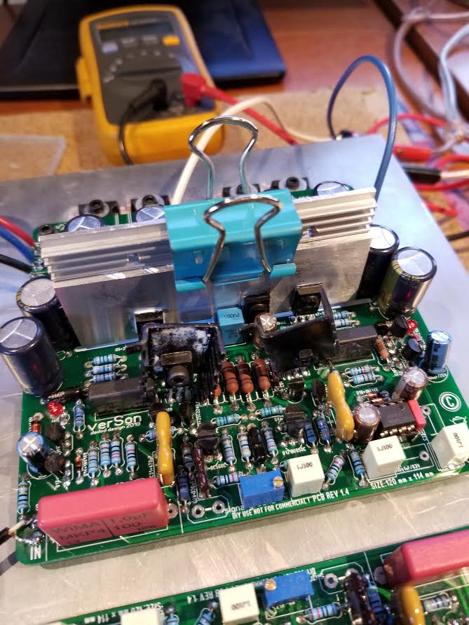

I got the time to play around again with my 100 CFA, just one channel. I lowered down the IPS bias to 1.62Vdc or 1.35mA, using 1K and 845 ohms on R4 and R7, thinking that it will lower down the current on R14 and R52 to 4.0mA. And I thought that it will lower down also temperature or the heat on Q5,Q6, Q7 and Q8, which on my previous post the temp of the transistors was hot. This time DC Offset is 12mV to18mV without opAmp. With OpAmp installed, -1mV to 3mV.
On the power up, (cold start) the voltage on R5 is 1.56Vdc and start to go to 1.62Vdc after 10 minutes. Same with the R14, voltage start at .343Vdc and goes up to .440Vdc. I was also observing the temperature of the heatsink at the same time of Q5 and Q7, as well as Q6 and Q8. After an hour, temperature rising to 47 to 48 degC. It seems like not normal to me. Is your amplifier doing the same?
I thought once the current is set, it should stay the same all the time. When I blow air to the heatsink of Q5 and Q7, the voltage at R14 drops to .368Vdc. I know that my heatsink on Q5 and Q7 is more than enough as on previous post.
I was able to play music and Im impress with sound quality of this amp. I just can't trust it right now. Then I have a disaster happened. When I was, measuring the voltage on R5, my test lead slip and shorted the zener diode D15. It pop and that's how my day end. I still have the other channel to play around.
Give me some feedback or any thoughts. Thanks.

Fred, it sims that VAS currents is OK, about 4.4 mA after some time. I don't know what you used for drivers heat sink, but 48 degC is not to high. Just in case check the value of R17, if incidentally is to low (it should be 470R) drivers will dissipate more and heat more.
If you blow air to the drivers heatsink that will change the bias setting as a half of the bias spreader is fixed to that heat sink.
I think that you worry to much.
