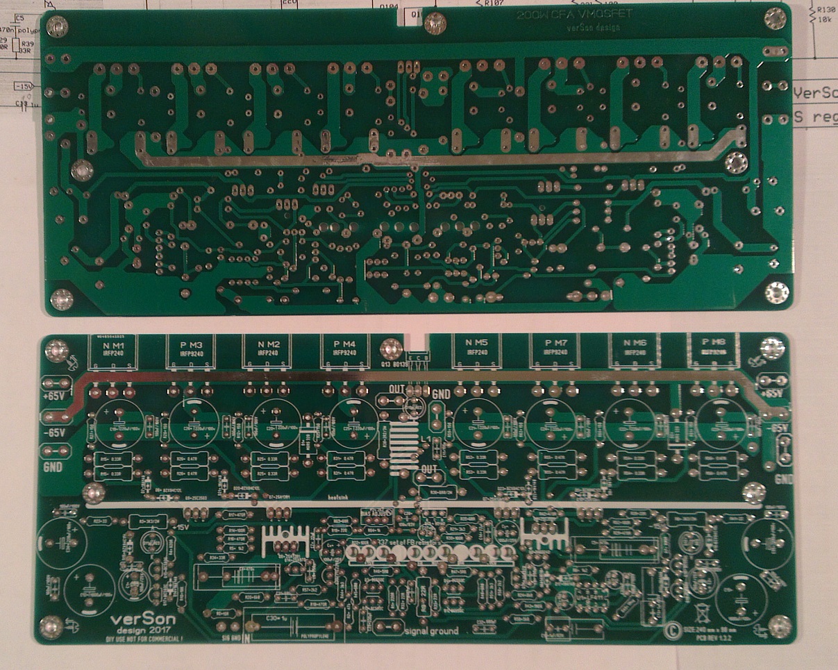

With regards to "Damirs 200W CFA", I may have missed this mentioned elswhere in this thread but who designed the layout of this amplifier. Secondly is the layout of RNMarsh's amplifier the same as this layout.
Is there a link to this PCB layout , is this pcb more than 2 layers.
Hello ATX,
I designed it, 2 layers. http://www.diyaudio.com/forums/solid-state/243481-200w-mosfet-cfa-amp-113.html#post5277626

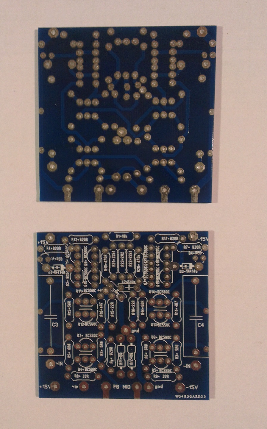

Today the boards arrived. I will send PM to those who accepted the price, I need the PayPal email address.
I have one spare stereo set of the boards for balanced input. With those boards it's possible to transform this amp from unbalanced to balanced inputs. If someone interested, please tell, it will go with one complete stereo set. This additional board is going instead small Feedback board.
mlloyd1 4 board
AVWERK 2 board
trebolo 4 boards
and Lbud4 4 boards but not confirmed
Damir

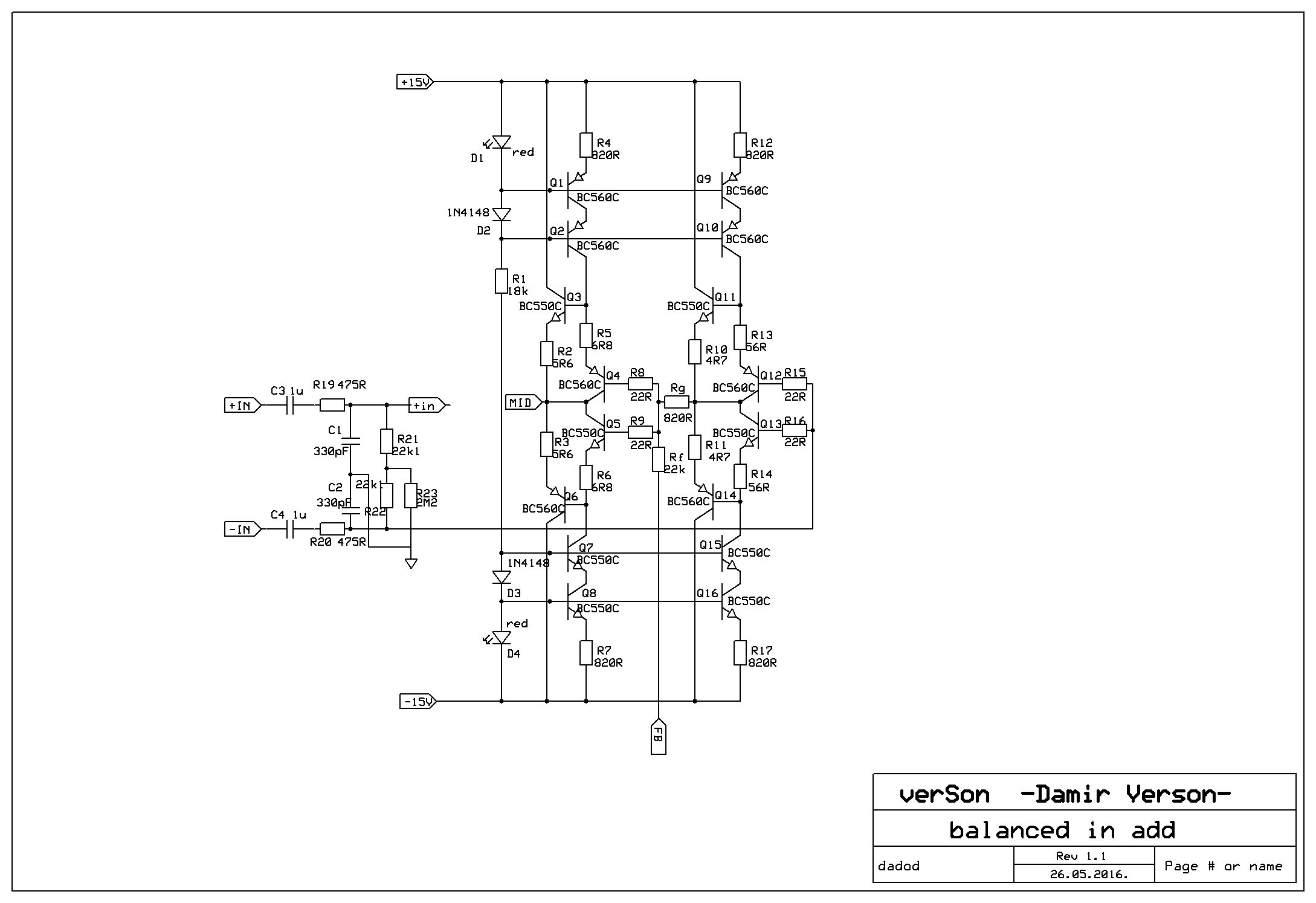

first - balanced inputs add boards schematic
second - actual balanced inputs add boards
third - main boards
forth - FB board

Hello Damir,
Is the following link to post 1131 the actual schematic of the CFA 200W mosfet amplifier. Is this the actual final production schematic version that you built the amplifer PCBs that RNMarsh and Astx are using.
200W MOSFET CFA amp
200W MOSFET CFA amp
Hello Damir,
200W MOSFET CFA amp
Yes, this is last version with some minor changes compare with the boards Astx used, RNMarsh has exactly this one.

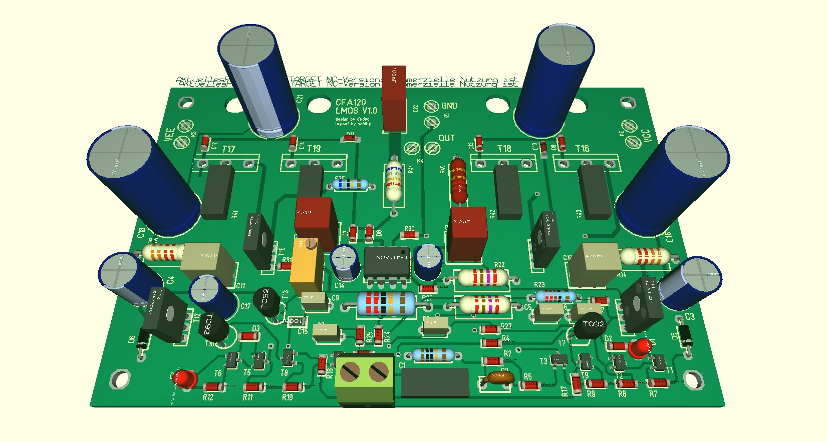

1st approach
This is my first attempt of the CFA120 LatMos version, changing the board size to 125mmx80mm, and adapted to TO-3p output stage (transistors are mounted on an aluminum plate (150mmx80mmx10mm) under the pcb). As always i will let it rest, and have a look over it for possible improvements in the next weeks.
Maybe also start a test order of 5 PCB in China for few Euros.

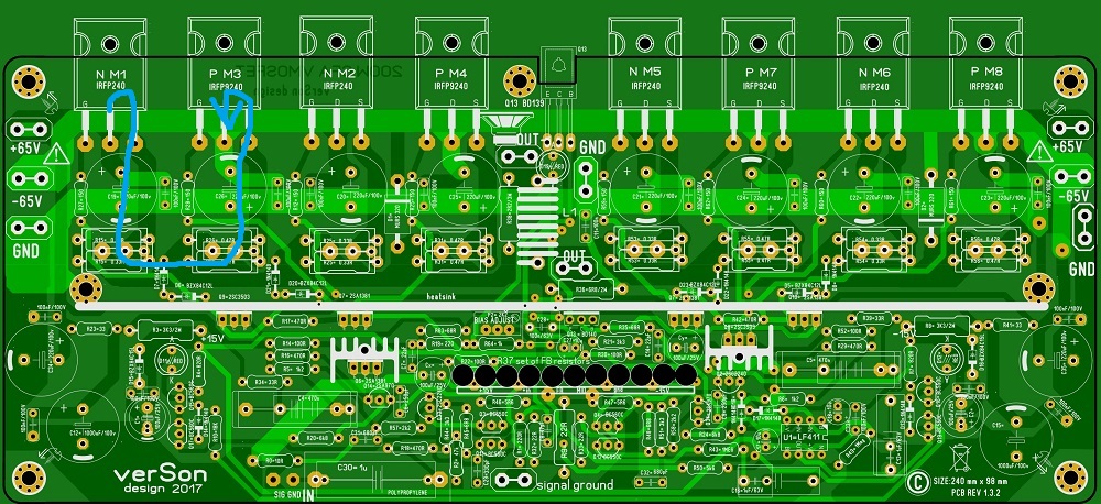

Hello Damir ,
Just about the PCB did you use any special layout on the output stage to minimize the non linear magnetic field caused by the half wave current of the class A/B output stage . I dont think I see any special precautions to minimise these problems.
Hello PHENIX,
I used a kind of interweaved connection of the output mosfets, one N and next one P channel and so on, not one type on one side and the other type on other side.
In this way the half wave current of the class A/B output stage is going in smaller loops and I hope les interfere with input circuitry. I would like to hear your opinion.
