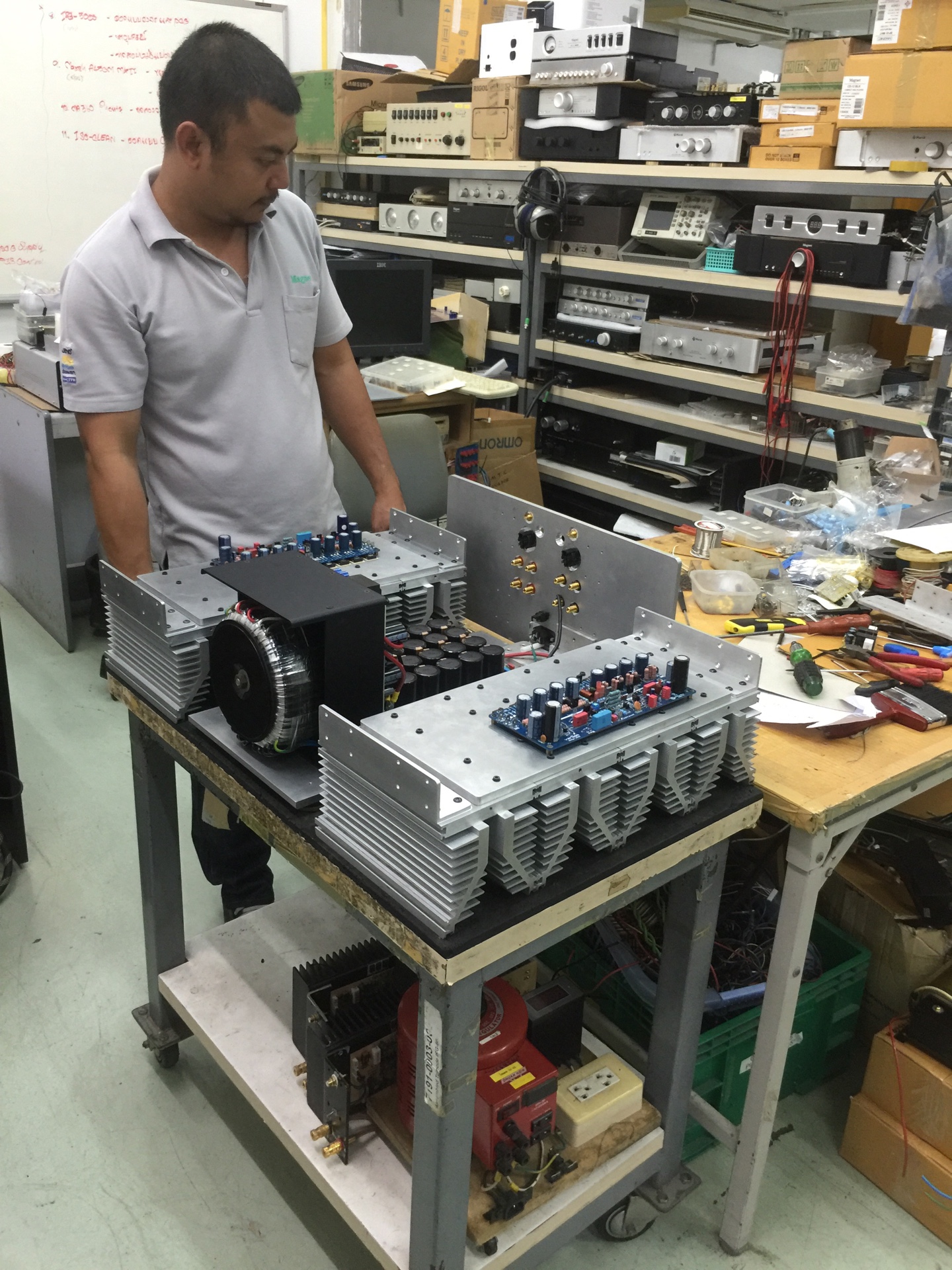

The DC PS uses many parallel electro caps to divide the current sharing and to lower Z. Also, dual pri windings.
The new transformer has great current output capacity.
We will do IMD soon. Wiring isn't finished but I will show interior of finished amp also. Not sure you will be able to see all wire routing, though.
