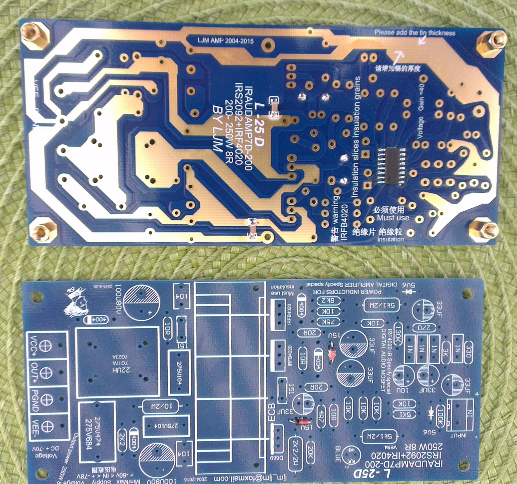

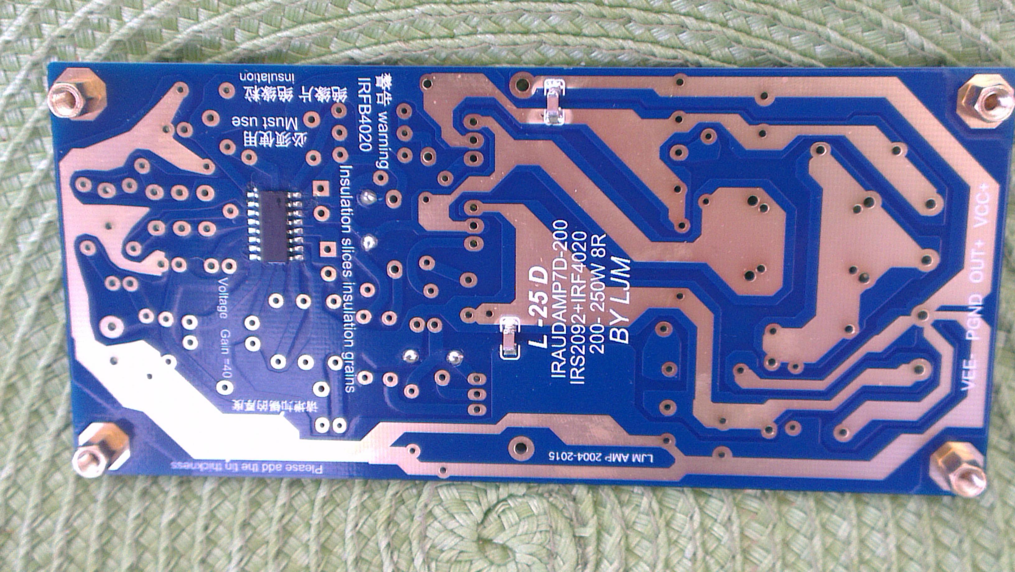

This is the PCB I bought, it's standard one on Ebay.
BR Damir

The power amp I will use is modified 100W CFA and 200/400W Class D amp. This CFA is quite similar to my Class AB amp but the output MOSFETS are biased to Class A and power supply is only +-6V with middle point not connected to the ground but to the Class D amp output. Both amps should have the same gain.

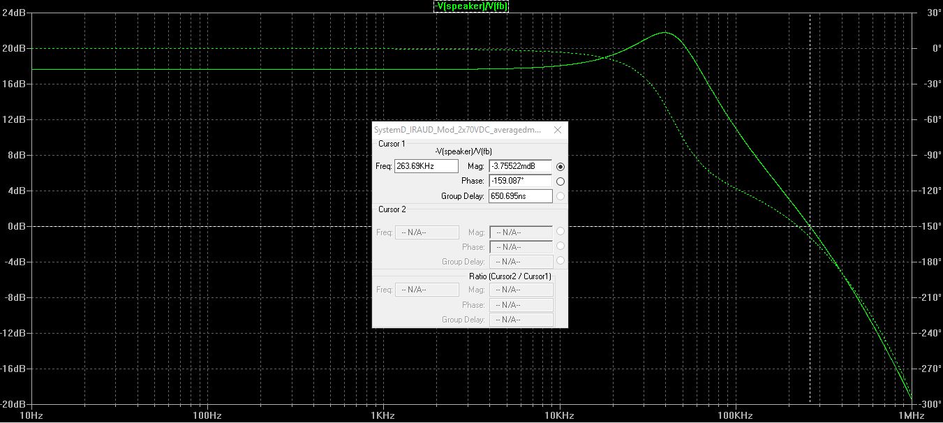

The files as shown are heading for constant loop gain and phase over
the entire audio range. For this the C2 (name acc. simulation) is shorted.
Optional you can use the C2 = 1nF without short and will get
growing loop gain below 10kHz.
Frequency adjustment in this set up can be done by small variations of C6 (name acc. simulation).

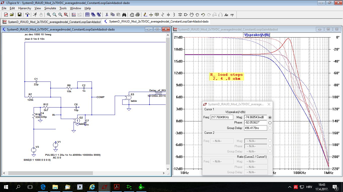

I was quite busy lately around house, no to much time for audio.
Before to completely assemble the PCB I did the loop gain simulation.
Here is my tray with the loop gain. I get best result removing C6 and C7. The gain is set to around 28 dB as I will use it together with my Class A of the similar gain.
I am not sure yet with this Class D simulation and I would like you opinion.
Damir

It took pretty some time until someone started to ask these questions.
True. C7 & C6 are doing no good in terms of transfer function.
Unfortunately I still needed them in real life.
At least 1nF from COMP to GND is needed according data sheet.
..and yes, the data sheet is right. Without this cap the OTA tends to
fall into a MHz oszillation.
Furtheron please note that without this cap my simple model will anticipate an OTA with unlimited speed and will not properly reflect the real IRS2092. Especially when you remove C6 & C7 then the simulation will strongly deviate from real IRS2092.
The cap from COMP to OTA input is one of the 'lower impact solutions' to control the switching frequency.
Which switching frequency do you theoretically get from your set of values? Must be pretty high, I guess.

Thanks you for explanations.
I get about 500 kHz, a bit to high, isn't it?
...I see you also massively increased R8, which lowers fs...
500kHz is not generally impossible. With the intended choke, MosFets and dead time this is more or less at the limit which still allows reasonable ZVS during idle.
But heat of the IRS2092 would need to be double checked.
And at high power the intended power stage will sweat already in a way which reduces reliability.

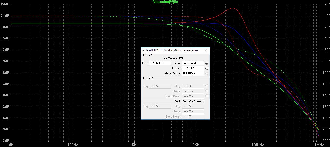

However I see that you did not readjust E3 according to the reduced size of the carrier signal at the COMP pin.
Attached the sim with readjusted E3.
==> Some more db loop gain. ==> Less margin.
Nevertheless - if the IRS2092 would have an ideal OTA your adjustment would be attractive.
With a real IRS2092 your proposal will suffer from instable OTA (unpredictably changing between nice operation and faulty MHz oszillations), and also fs and phase margin will be less, because without any external cap the internal pole(s) of the real OTA, which are not modeled in my sim, will become relevant.

In your previous loop gain simulation you used 18k for R8, and I actually decreased it to 15k.
Just to summarize:
C7 is needed
C6 10 pF is OK but could be stable without it? simulation shows increased phase margin without
..sorry for confusion, somehow I had memorized it different. :warped:
Yes, I am using C6 not for stability.
Actually it worsens stability of the global loop - fully agree to your findings.
In most versions I am using it to control fs.
In the 40V version it was additionally part of the fine tuning process of the shape of the carrier in order to get lowest THD.
