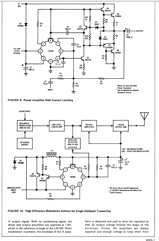

It is an idea that has been around for quite a long time: see for example this app-note from.... 1968!
Here, the switching regulator drives a linear modulator, but it could be an amplifier as well:

I believe there was a Technics/Panasonic with this type of scheme. (Class B or C amp driving low voltage supply for Class A stage).
Also similar, but different is the Carver Sunfire type amp - Best description is each supply is a class D amp with +7 or -7 Volts of DC offset. Great for high powered subs - probably needs tweaking to run full range.
...and Yamaha EEEngine...

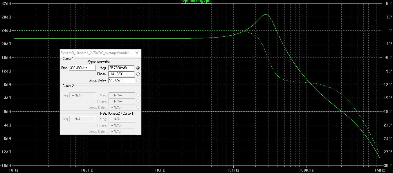

I bought the IRS2092 kit and want to move the nfb point after output inductor but as I am no very familiar with Class D amp I need a help. What I need to change more to make that amp working?
Damir

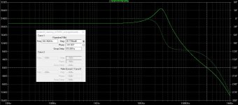

After some discussions in the LiteAmpThread I guess you would prefer a more constant loop gain and phase over the entire audio range.
Here a postfilter feedback version which would serve this design goal, however it will have much higher THD.
But I understood THD is not your concern, because the ClassD amp will only move the supply rails of the ClassA amp.
The attached version should be easy to mod from standard designs with IRS2092.
I have chosen low resistor values in the small signal area. From perspective of IRS2092 you could go for approx 3 times higher resistor values and 3 times smaller capacitances if your layout is good enough.
