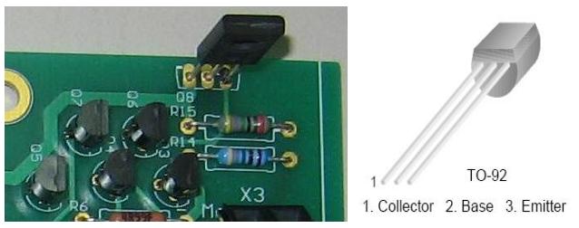

Re: Tech support Please
Webby I'm sorry but I can't tell you whether those resistances are OK or not- I'm working off Algar's schematic and I'm not sure I understand the way he has the adjustment section drawn. Also I don't know which of the six pins of the switch is which (I've never built Algar's version).
Can you re-check your measurements on Q7, it looks to me like you have labelled emitter as base and vice versa.
Assuming that is the case measure the voltages at pins 2 and 3 of IC4 when everything is connected and (not) running.

Webby:
Checking IC3 pin6 i get 5v when sw2=up sw3=dn, is this ok? Yes, SW3 (charger On/Off, to Off=DN), SW2 (Circuit On/Off, to On=UP). IC3 is the 5V Voltage reference chip, its output is pin6 = 5V, so it is Ok.
For the transistors pins identification, just download each datasheet from the net. Q7= BC557. The transistor body should match the pcb silkscreen image printed on the PCB. See the included image. It is also included into the documentation. BC557 pinout is C,B,E, see image.
Your Q7 voltages don't make sense. If you put IC4, pin1 to ground, Q7 base should be Zero, not the collector. Check again.
If Q8 is shorted, you won't have any voltage on your motor. Q6,7 and Q8 form a shunt regulator, shorthing more or less voltage to ground to control the motor speed. Q1,Q2 are a serie regulator keeping the motor's voltage constant even if the battery voltage drops while using the controller. The Motor voltage will also be different for different motor current because R4, is a current shunt sensing element and will control Q2 accordingly.
I don't have an actual PCB myself. Just my first own version that is different from you own PCB.
Also make sure that VR1 multiturn potentiometer is not set to zero ohm, or you want be controlling the motor at all. A good starting pot is to set it near its middle range, lets say 20K. Measure it between IC4 pins 6-7 (with the power OFF).
What is your setpoint voltage (R11 input voltage)? This is the voltage controls by the front speed pots and DIP switches. Also if it is 0V, your motor won't turn. Make sure it is set to maximum, around 5V (the same 5V reference IC3, pin6)
testing circuit
Hi All, Sylvain,
Received the replacement pulley, thanks for sorting this out, great job!
I have the battery at last, so have checked the charging circuit etc, this appears to be charging ok and supplying power to the circuit from battery, good!
Still cannot get the motor running.
Have changed Q8 and Q6, just to see, no change.
VR1 is set to 20K
IC3 pin6 = 5v
R11 setpoint 5v
VR2 & VR3 = 5v
I have all the datasheets to confirm IC`s and transistors,
I have rechecked Q7 and am still getting c=0 b=12.7 e=3.5 and the orientation is correct.
I think the first problem is Q2, shouldn't the collector be putting out 6v, looks that way on the diagram.
Are the reading from Q1 ok?
q1 c=12.6 b=13.1 e=13.7
The rest of them.
q2 c=0.1 b=12.5 e=13.6
q3 c=.6 b=.3 e=0
q4 c=1.8 b=.3 e=0
q5 c=13.7 b=.6 e=.3
q6 c=0 b=3.5 e=0
q7 c=0 b=12.7 e=3.5
q8 c=0 b=0 e=0
Could someone with a working circuit give me their transistor readings please, would be very grateful.
I am not sure what to do next, so any ideas?
The rest of them.
q3 c=.6 b=.3 e=0
q4 c=1.8 b=.3 e=0
q5 c=13.7 b=.6 e=.3
q6 c=0 b=3.5 e=0
q7 c=0 b=12.7 e=3.5
q8 c=0 b=0 e=0
