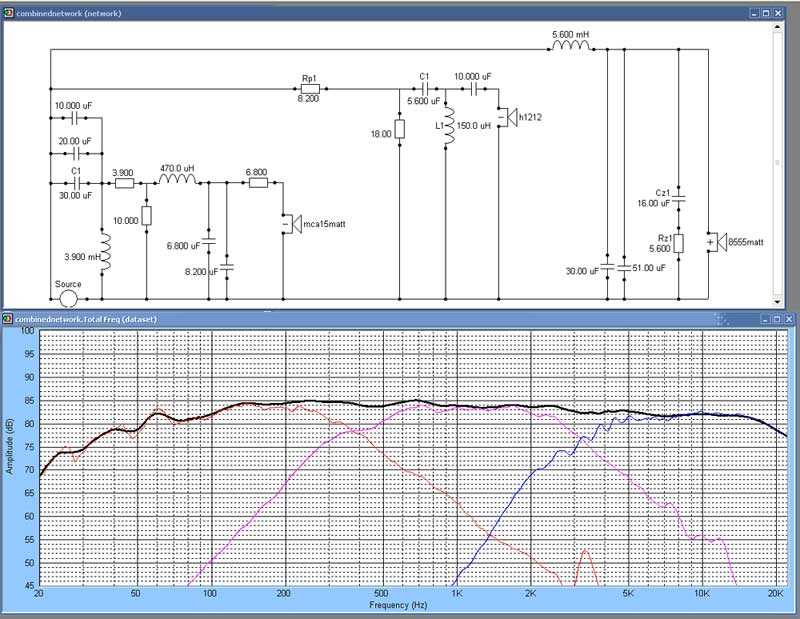

The time alignment thing seems to have lots of different pros and cons. Moving the tweeter back in relation to the mid would create lots of diffraction effects taht may be more detrimental to the sound- also the importance of it is discussed here: http://sound.westhost.com/ptd.htm
I amk designing the crossovers using speaker workshop- it has a setting for the acoustic offset of the drivers, which i have measured as if the drivers were mounted on the same baffle- and used in the program. The response looks flat across the crossover points, and gives a deep, symetrical null when the polatity of the mid is reversed. The flatness of the summed curve changes if i alter the offset of the drivers, so am i right in thinking the offset of the drivers will be compensated for in the crossover?

i don't know exactly as i don't know speaker workshop. But there are two options as long as i know : Either you didn't entered the parameters of the accoustical center of each driver, either you used an assymetrical slope and then the crossover is compensating for the driver offset
this promises to be a veery good speakers. I insist on time alignment because of the article you linked to (that i already read and that is very good). There are two way to read this article's conclusion . The first one is yours. The second is to see that Rod, that is not easily falling into the hype, to say the least,is convinced that time aligning drivers is the way to go if you can deal with the drawbacks
Rod states :
what i understand from this little extract is that time alignment is not done easily without drawbacks, but that it is possible. The most elegant solutions in my opinion are either :
- Assymetrical crossover
- Slanted baffle as in the Jmlab Utopia for example
- Accoustical Waveguide
The waveguide, even if it has lots of advantages, do not seem to be easily blendable into your design, so the two other possibilities remain.
the slanted baffle is difficult to implement, but the very aim of your design seems to be taking advantage of the construction method you will be using, wich would allow a kind of slanted baffle pretty easily, even a waveguide if you wanted to, anyway, being able to shape the cabinet into very organic shapes, you are able to overcome very easily the diffraction effects Rod is reffering to
then i admit that it would need a redesign stage that you may not want to go through . if it is the case i strongly advise you to compensate in the crossover network.
just my 2 cents !

thanks very much for your comments- 12 months ago I knew nothing about building and designing loudspeakers so I'm learning all the time.
It turns out that one of the solutions you have mentioned- asymetrical slopes- I have done, stumbling on it just by trying lots of different ideas in speaker workshop to see how they model. I found that using a third order slope on the tweeter, and a second order slope (electrical) on the midrange gave the deepest reverse polarity null with the acoustic offsets entered, which having thought about it would give a higher phase shift on the tweeter delaying its output. Im sure i have entered the offsets correctly.
However, the design pictured above is the initial concept, which I have just handed in for assesment last week. In 2 weeks time I will have to redesign out any problems in the design (partly why I started this thread, to get ideas), so your comments are very helpful to me.
I have ordered some parts so try out some crossovers using basic test enclosures, but sloping the baffles may well be included into the design if the crossover has to be changed significantly.

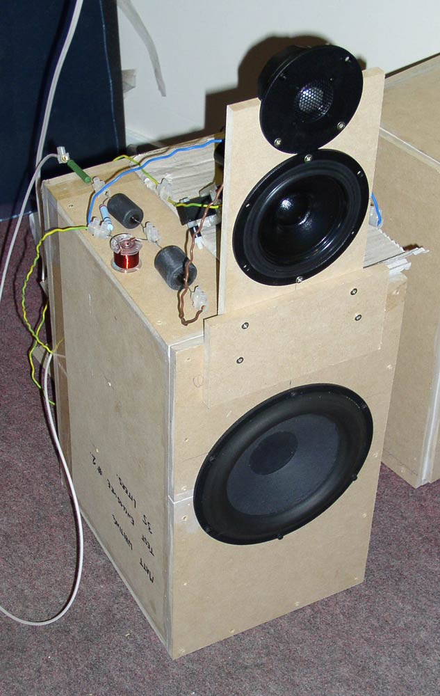

Well having finished my last exam ever, I got back to my room to celebrate- by screwing together the big box of crossover components I received from germany
With only basic tools to work with i fashioned a baffle from a scrap of MDF and screwed it to the top of one of my test bass enclosures. Workshops are shut until next week as its inter-semester break, so I cant make a test cab for the midrange just yet.
We spent an evening listening to the "ugliest speaker in the world" which actually sounds quite nice. The upper midrange seems a bit hot so I might have to change some cap and resistor values, but Im very pleased considering its the first crossover i've designed 100% from scratch. The clarity is really good and the bass from the sealed scan 8555 is quick and punchy, even though its being driven from a cheap PC soundcard.
I'll leave any adjustments until after ive built a full test enclosure, as the open-baffle nature of the mid must have a huge role in the slightly odd sound, but heres some pics for now:
