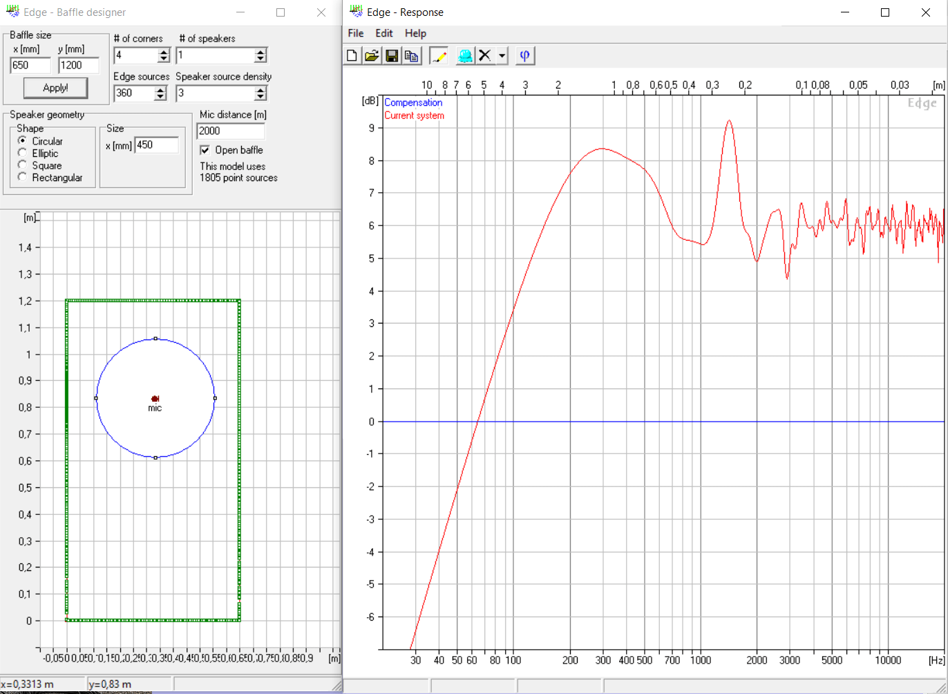

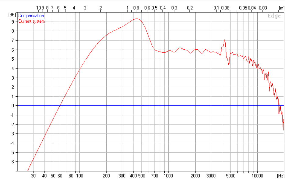

More long wings is not a good idea because
You will have quarter wave resonance.
I noticed you can have store energy between the dipole dips : it ruins the midrange. But directivity might help to avoid a too perfect dipole behaviour of the speaker . If you can trace the CSD, it can help.

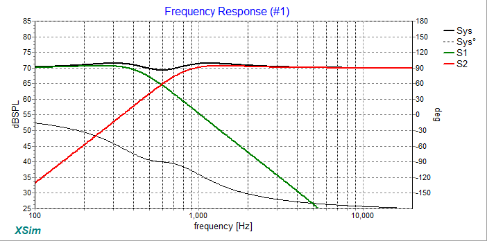

In simulation an 80-90Hz LP on the woofer flattens its response and it then has an approximately 2nd order roll off at 420 Hz. Slope Q about 0.9. If the compression driver is high passed circa 800-850 it should sum correctly near 750Hz.
Of course real life is messier than that, so it will take some tweaking. The passive crossover we had in 2008 was better than my attempt yesterday, but I got close.

True about the wings, but I would never go too deep. No more than 8"- 20cm. One could go deeper on a single side if that wing were tapered or triangular, which would help spread around the baffle peak.

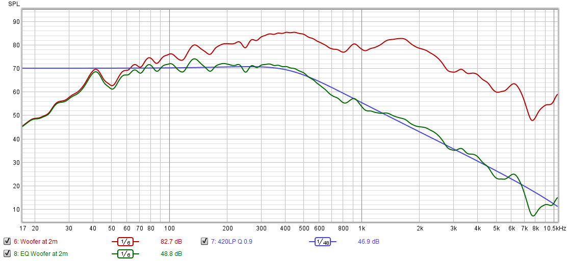

What creates 2nd order LP on 420 Hz on woofer?
Here is what I mean by the LP at 420 Hz explained in a graph.What creates 2nd order LP
Above we see in red the woofer response on OB taken at 2 meters from the baffle. The green line is the response of the woofer after the application of a 1st order low pass filter @80Hz and some PEQ to tame the peak around 1550 Hz. In blue is the transfer function of a 2nd order low pass at 420 Hz. The filter has a Q of 0.9, which is a steeper shoulder than Butterworth. The rolloff of the woofer now looks very much like the 2nd order Q=0,9 The baffle peak circa 450Hz has now become the shoulder of the LP rolloff.
Of course this is both driver and baffle dependent, and perhaps influenced by the room.
Here is that 2 second order filters would look like summed. The crossover point has a little ripple, but it's not horrible.
Note that the crossover happens at about 600Hz, while the LP is @420 Hz and the HP is 830 Hz. Spreading them apart makes them sum fairly flat.
I don't think that the compression driver is going to be molded into that pretty high pass shape, but it gives me an idea of what "could be."
Looks like you need more EQing and a real crossover, not just a 6dB/oct. Is that with or without the 90hz LP in place? In either case, that much 400hz never sounded good to anyone.

No worries. Once low passed, the woofer has no more 400Hz than anything else in the pass band. Getting the horn to match is the difficult part.
Having built and heard many, many OB speakers with just a big inductor on the woofer, I know how well it can work. Most people don’t understand OB crossovers, which is why so many of them sound bad.
But it took me an entire year to understand OB crossovers - a year of making bad designs, because I was so used to “normal” crossovers. Now I’ve spent years on this forum explaining how OB bass works because most people aren’t familiar with it. In fact I have an entire thread about it, with well over a million views. The aggressive 1st order LP on the OB woofer works extremely well. It worked 15 years ago on these drivers.
