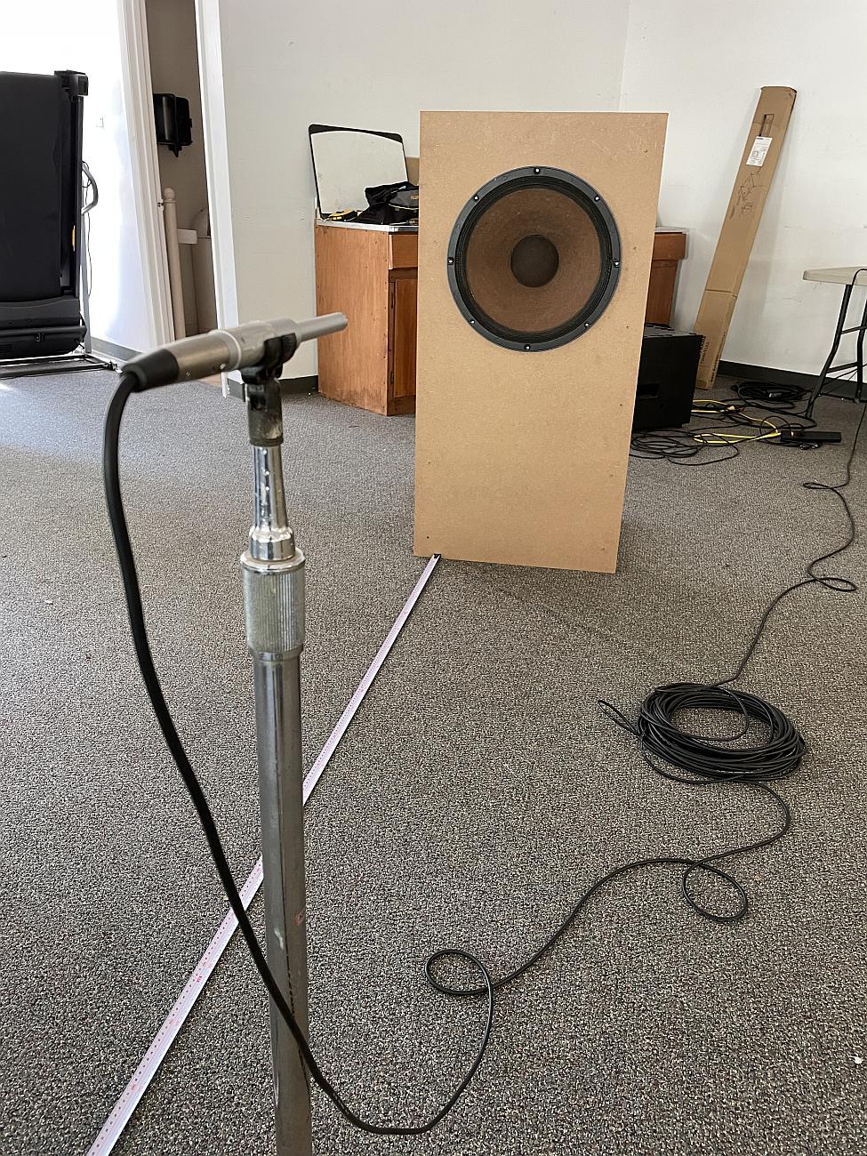

Today I made a couple of crude test sleds to get these up and running again. I wanted 30mm OSB,for the baffle but that didn't work out. So I have 13mm MDF (yuck). Here's hoping that the 2x4 braces add some rigidity to the baffle. Might need to add a cross brace below the woofer. It will get wings once it's up and running.
These are the biggest coaxial drivers I know of, and no longer made. They have substantial frames and weigh 17 kg each! The 18" cone serves as a horn for the 1.4" compression driver. This allows an acoustical crossover point of around 750 Hz, which this compression driver can do on this cone/horn.
I'll be using two QSC pro audio amps with plenty of power, and DSP active crossover because I have it, and because it should be fast to implement. Crossover work will begin tomorrow.

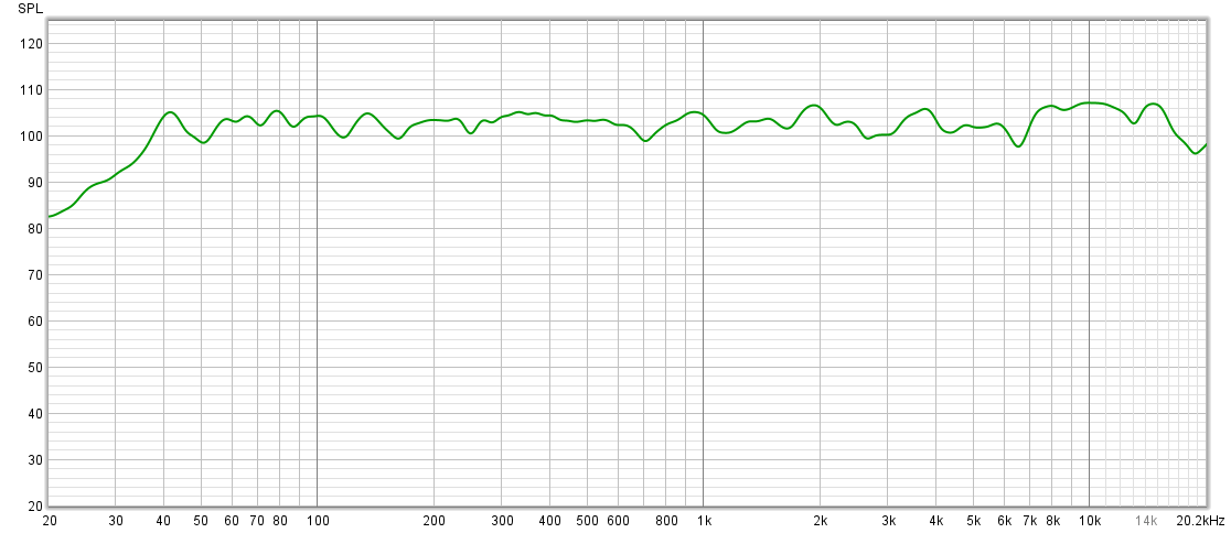

This my first try at a crossover, no wings. Yes it has EQ.
Basics:
  • Woofer LP @90Hz 1st order
  • Woofer EQ -4dB@155Hz, +3dB@50Hz
  • Horn HP @750Hz, 2nd order, polarity reversed
    Horn EQ -5dB @1600Hz
This is measured at 2 meters from the baffle. The corner you see behind is 4.4 meters from the speaker. Side walls about the same distance.
The room is very big, 16.5x9 meters, ceiling at 2.75 meters. I haven't listened in stereo yet.

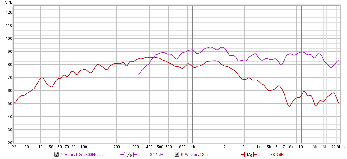

Here is were things started out at 2 meters from the baffle, no EQ, no crossover. Same voltage to each driver.
So far the bass sounds full, more so than I expect for mono. I need another XLR to get the stereo rig going.
From image I presume woofers first dipole peak is at about 400 Hz, so there is also reasonable to cut it with LP filter.
