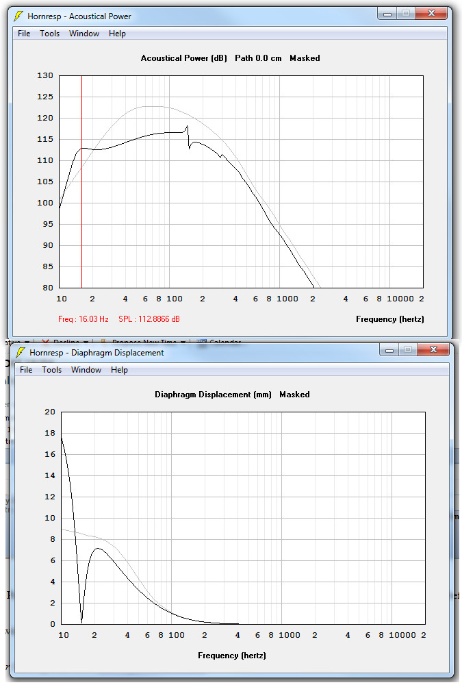

I had a look at what Dayton has on offer, and couldn't come across a driver with that Fs. However this one comes close: Dayton Audio RSS460HO-4 18" Reference HO Subwoofer 4 ohm
Have a look at what that looks like in a large box vented to 16 Hz
This seems like a very good idea to me; probably better than my suggestion.
The image I've attached is a half-space simulation, showing two of the RSS vented (Brian's suggestion - dark line) versus my suggestion (pale line).
It looks like a pair of the RSS drivers would:
- be 4 dB louder (at 16Hz) than my suggestion
- be only $520 for a pair; about $100 cheaper than the quad I suggested
- have less excursion above ~12Hz
Better performance for less money is a win. The downsides seem relatively minor:
- would need a filter to reduce content <12Hz (but any option will need filtering)
- slightly harder to move (bigger boxes)
- slightly more complex build
- less modular (you can't put 2 cabinets in 4 locations)
The last one is probably the only point that matters, but I have zero experience with what Art is talking about, so I don't have any sense of how important it is.

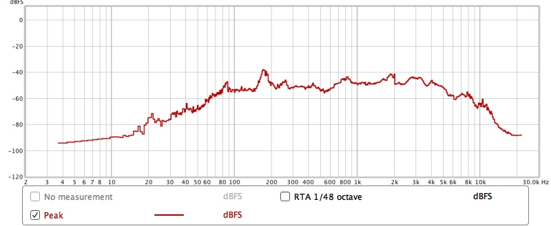

I have also run across a friend of mine that is playing the 1927 4/32 (4-manual and pedal with 32-ranks or pipes) WurliTzer in Grace Baptist Church in Sarasota, Florida. He is playing the William Tell Overture. Please listen to this through your best audio system and NOT through headphones as you will not hear the LFs in the recording. I hope this helps.
Bill Tell Overture peak RTA.
B.
