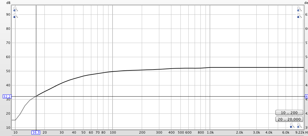

My guesstimate was 90 dB to 100 dB based on my little test system here.
Attending the annual Halloween organ bash in Toronto (see posts), I recall getting maybe 95dBc on my old Radio Shack SPL meter. And they are trying real hard to be loud on a big organ. But it is down quite a bit in the low bass. See calibration below.
The "test" for loudness is how easy it is to whisper to your neighbour at a concert. Even at the loudest concerts, that's no problem although not quite applicable to the power present in very low notes like at an organ concert.

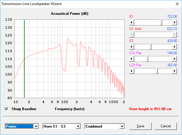

A few reasons the OP (original poster) may not need massive volume:
He references an organ enthusiast named Owen Jones building a (roughly) 600 litre TL (transmission line) with a cheap 18". The driver is relatively humble, and the design isn't the most efficient use of 600 litres, but it was good enough to keep Owen happy.
As Art said in post 45: it only needs 100 dB to make walls 'flap' at 15-20Hz.
As Ben says in post 61: 95dB at the listening seat may be enough.
The most favored of the options thrown around in this thread (post 6) is the DTS-10 tapped horn. This was a kit that got great output, for a fairly low cost ($975 USD). It seems like a great option for someone who:
a) needs 16-60Hz outdoors (maximum 16-100Hz)
b) has the expertise to build and eq the system
c) can easily move a single, huge object
...but that doesn't really sound like kiaya611, does it? He:
a) needs 16-100Hz (and I bet he wouldn't mind if it was usable to 200Hz).
b) is a novice
c) can't
Hence I'd consider making four sealed boxes loaded with 1 cheap driver per box (rather than one huge box). The driver from VFM audio that Owen Jones used would be OK. Parts Express has a cheap 18" (4 for $480) that looks better.

No chance of 120dB at 16Hz with 4x18" sealed, unless you're going for top-of-the-line drivers.
You can play around here:
Piston Excursion calculator
Edit - the reason I suggested car subwoofers is that they often have more excursion than PA drivers, so you can get similar output from a smaller cone area. A 12" needs 2x the excursion of a 18" to produce the same SPL in a sealed box.
16x 12"s with 10mm one-way travel will produce 114dB at 16Hz. You could get that SPL from 16x 18"s with 5mm Xmax, or 8x 18"s with 10mm Xmax.

If you want to use sealed boxes, you need a lot of displacement. Whether it's a single 18" with 42mm of Xmax (110dB at 16Hz) or 8x 12"s with 12mm. Both will cost quite a lot.
Tapped horns are a good way of getting more output for your money, but to get high power at frequencies this low, you need a lot of cabinet.
So,
- DTS10 - big, cheap.
- 1x top-end 18" - smallest cabinet possible, very expensive. Something like this Data-Bass in a sealed box would manage around 109dB at 16Hz on its own. That driver is $2500.
- 8x 12"s - somewhere between the two. I'd suggest something like the JBL GTO1214, which come in around $100 each. Start with four, add another four. I'd build them as columns with wheels at one end so they can go through narrow doors.
A compromise might be a passive radiator solution. A pair of the 18" Dayton home-theatre drivers with a quad of passive radiators might be worth simulating, though could work out as expensive as the driver tested at DataBass.
The DTS10 will likely win out on efficiency over any of these designs, so you could get enough output with a couple of hundred watts per driver. The sealed or passive radiator boxes will need an order of magnitude more power, which could be a problem if we're on a budget.

Have a look at what that looks like in a large box vented to 16 Hz (or an offset TL that resonates at that frequency). If it has a smooth, downward-sloping passband, that can be fixed with a little EQ. Build one, measure, then build multiples if you need more output (every additional one driven by the same amount of power will add 6dB to peak SPL capability when they're stacked together)
Here's an idea to start off with - a ~260 L offset-driver stuffed TL that meets the bandwidth that you're looking to achieve (with a bit of EQ), using the driver I mentioned above. A 1kW amp should be enough for it. The design needs some refinement (for example, it might not need all of that stuffing, and I'd probably adjust it to have a proper flared vent) and of course it has to be folded into a box, but then I've got design spreadsheets to assist with that :).
