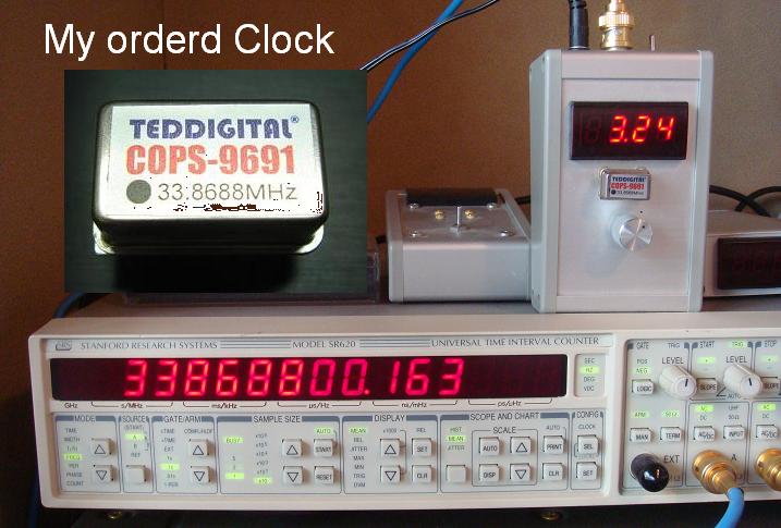

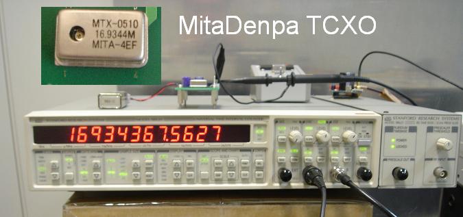

Nonsense Measurement of Clock diviation No.1
This is so called "+/-1ppm TCXO" MTX-0510 MitaDenpa clock diviation.
If you would like to tuning frequency, please use +/-5ppm trimer controll. But room temprature must fix.

And if you change X'tal oscillator of DENON DCD-S1, please be careful not to be wrong part.
This is failure example of clock exchange.

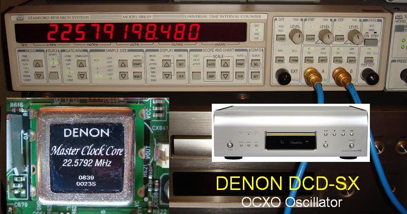

Nonsense Measurement of Clock diviation No.2
This is so called by DENON "+/-0.5ppm OCXO" XO6501GG EPSON/TOYOCOM clock diviation.
This OCXO output frequency is controlled by u-com in DCD-SX DENON SACD player.
It is fine diviation! Always it is only slip under 1.5Hz!
And in case of this model, even if you do not worry about room templature, it is all right. Because this is OCXO.
But....
What is the purpose using oven heater controlled OCXO?
I don't hear heater noise.

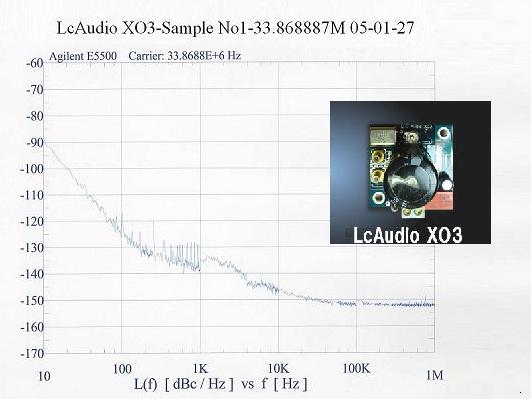

Nagae san,
Very interesting measurements of absolute frequency deviation. As you yourself and others wrote before, this parameter is irrelevant in audio.
However, you mentioned that you measured the phase noise (which parameter IS relevant for us) of several oscillators with HP (Agilent) E5501B test set. Do you have such graphical output of the phase noise vs. frequency in the 10 Hz to 100 kHz range from the oscillators you measured? I am very interested in how does it look like for a "good" audio quality oscillator. Unfortunately very few manufacturers specify the phase noise at 10 Hz from the carrier. They specify at least at 1 kHz or 10 kHz if they do it at all, and I haven't seen such graph over the audio frequency band.

nagaesan,
Do you have such graphs that can be seen on the computer display here?
http://www.home.agilent.com/agilent/product.jspx?pn=E5501B
I don't have access to such instrument, so I can not measure phase noise.
Can you recommend a commercialy available oscillator, that has very low phase noise at 10 Hz distance from the carrier?
Re: Post #15
dear Mr Nagaesan
As far as I see, you are measuring the absloute accuracy of the clock
This is no indication of the sound quality
please understand this, this is one of the biggest misconceptions in digital audio I have ever seen
It makes no sense to measure absolute frequencies

I measured clock phase noise also diviation.
My opinion seems like same yours.
nagaesan said:In case of SACD player, the phase noise is important.
Because if clock purelity was worst there are spurious related playback music energy on phase noise, D/A converted analog signal have I/M distortion.
The frequency diviation is not important for audio equipment.
Because if D/A conversion fs frequency shift about +/- 1000ppm, D/A converted analog signal was fast or slow, but human ear cannot notice.
I checked MTX0510, MXO183S and XO3 phase noise with hp E5501B.
oshifis said:nagaesan,
**** My question.******
Why 10Hz?
I think 100Hz to 1kHz band phase noise is also important.
If the clock unit GND is shaken servo noise of CD player, it will appear these band.
And if the clock power supply has big ripple noise, it will also appear 100Hz to 10kHz band.

Re: I measured clock phase noise also diviation.
see measured results from my 33.8688 MHz XO, looks a bit better (much cheaper, sorry, couldn't resist)
best
Guido
best
Guido
Re: Re: I measured clock phase noise also diviation.
Can you explain better why it is better?
Are we looking at how low the noise is at low frequencies?
How quick it falls of as frequency increases?
etc?
etc?
