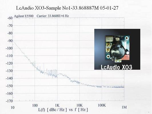

Jitter = phase Noise
Dear oscillator researchers
clock deviation ..... +/-1ppm, = not jitter
clock purity.............C/N, phase noise,-130dBc@100Hz = Jitter
I measured several crystal oscillator's Phase Noise with hp E5501B.
Attached file is LcAudio XO-3 jitter.
It is very nice jiter than usual SPXO and TCXO oscillators.
Crystal oscillator produces undesirable phase noise near the output frequency.
�@Phase noise is measured in the frequency domain, and is expressed as a ratio of signal power to noise power measured in a 1 Hz,10Hz,100Hz,1000Hz, bandwidth at a given offset from the desired signal.

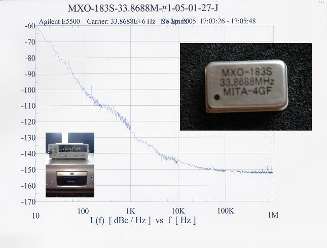

nagaesan said:
This is one of SACD clock, that product company called High accuracy master clock oscillator, to suppress jitter & noise.
XO3 has respectable jitter level at IMPORTANT band between 10Hz and 100Hz.
The one used in SACD player is pretty much useless and good for nothing at all!!!
Boky

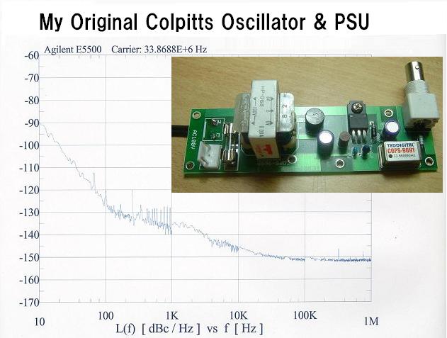

Re: I orderd low jitter colpitts oscillator
nagaesan said:
X'tal oscillator case size is DIP14pin, compatible that SACD player's clock.
Power unit is independent SACD module PCB.
That clock oscillator looks good - same as XO3 (!!!) Make sure that you use a separate, very low noise power supply.
There is another important thing to consider and implement: ground the whole power supply / clock oscillator combination only at one point on the main PCB - find the one with the lowest noise (hint: it is far away from the microprocessor chip!)
Good luck,
