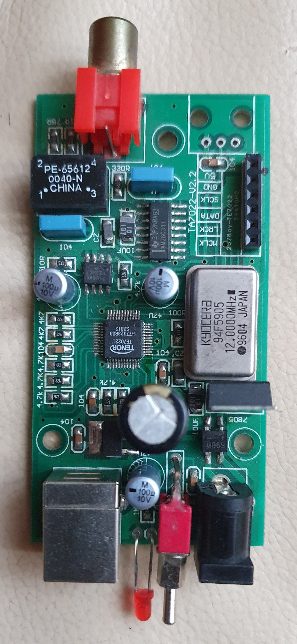

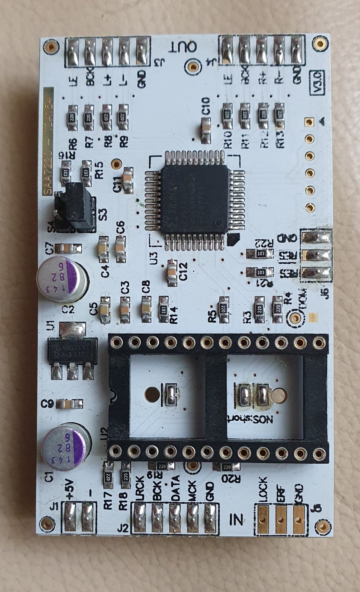

BTW I have this USB/I2S board and I2S splitter that I plan to use. Bur I never tried the I2S splitter, I am not even sure if it outputs offset binary. The marking is www.cdream5.com on it. Has anybody tried it?

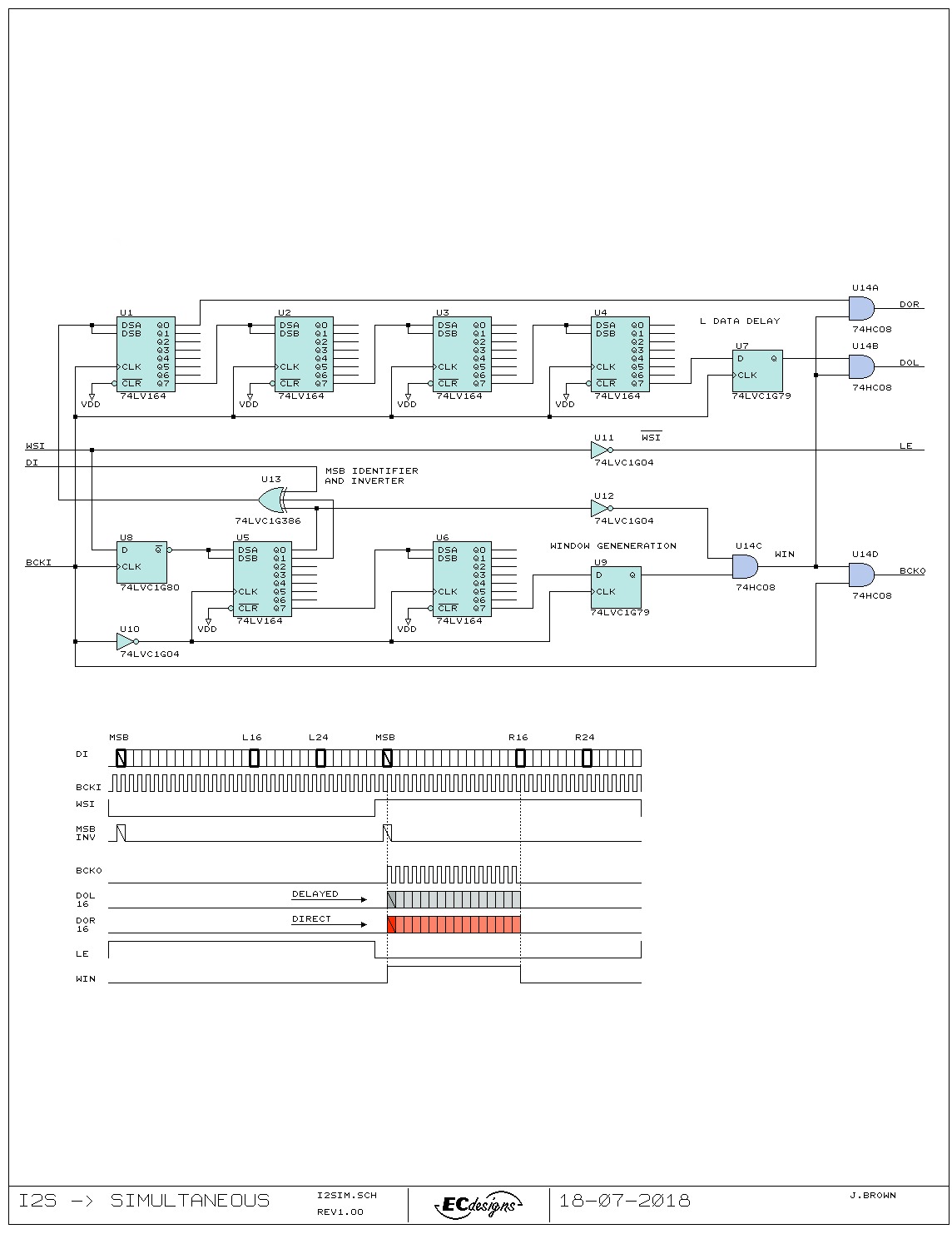

Have a read there https://www.mvaudiolabs.com/digital/tda1541a-reference-dac/, the I2SoverUSB does not work properly in simultaneous mode , as the Ian canada board too it is an 15 bit board , it has been discussed somewhere here on the forum
The only reliable way to go I2S to simultaneous is the John's glue logic ;)
Why do you think that the only way is Johns glue logic? I created free CPLD for all and also glue logic for TDA1541A and also CPLD for TDA1540, you can find everything in my threads. All is tested and checked with data analyser. CPLD is best way for TDA1541A and it can be easily modified to balanced.
