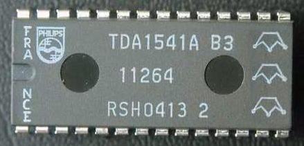

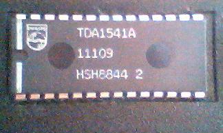

1541 / 1543 wake up !
How can you know the date of production of a 1541?

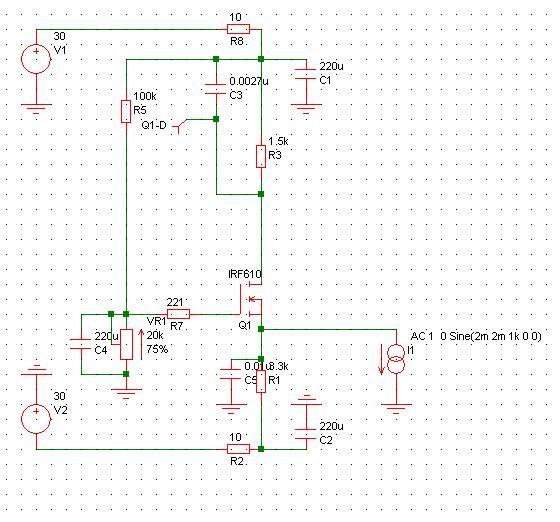

stefanobilliani said:
For now the answer is yes , and I do not use the buffer (source follower) either .
Pratically it is one fet, 4 resistors , 1 trimmer ,3 caps par channel .Very simple.
In the future I will implement a balanced version and 2 TDA1541A.
I would be interested for this version. I have a such a DAC waiting for an outputstage.
Any plans for making more than one pcb ? :D

jean-paul said:
Correct of course, it was late when I posted. 1988 anyhow. Yes Till, Reichelt and all others sell chips that were produced 16 years ago ( + or - some years ).
TDA1541A is like Telefunken E88CC. A lot of variations and production dates ;)
Do you know when the production started/stopped?
My datasheet for the TDA1541A is from 1991 (1985 for the non A), but I don't think that it's the beginning

Bricolo said:
I think he built this:
It lacks the output capacitor , but the circuit is the right one . Also with irfp044.
