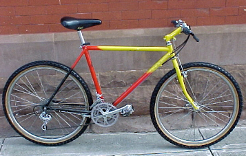

don't be "afraid" of a "hybrid". Since you've asked this question , I've been looking at my unfinshed bike in the garage, an old, 1986? Gary Fischer Montage, high end steel, odd pressed in "Fisher" bottom bracket and 1-1/8" Ritchey headset. I rebuilt it several years ago for my bro, who rode it for 3 years and got hit on it. I salvaged what I could. I had had the frame powder coated a "royal" blue...Thankfully my brother wasn't hurt, but his rims/components took a beating, and the driver's insurance company bought him a new bike (Fischer Hoo-ko-hoo-eekoo).
I think you're mistaken about the headset and possibly the date of that Fisher.
A: Gary Fisher "invented" the 1 1/4" Evolution headset (and the 73mm BB shell width and the ill-fated offroad tubular tire:dead:) So he most certainly would not have used a 1 1/8" headset, let alone a Ritchey labeled one.
B: Oversize headsets, both 1 1/4" and 1 1/8" did not appear until around 1988 IIRC.
maxro...
not looking for an arguement but...did a little more research on the old Fisher. it appears that it is a 1988 Montare SC. Originally it had been an ugly yellow colour. Apparently only used on 1988 Montare SC.Fischer specs
and Ritchey did make frames for Fisher. This frame has a Ritchey Pro Logic headset. Fisher press in 88mm bottom bracket (try to find one of those now--or even re-bearing one).
I will say that the early history of mountain bikes is pretty cloudy as to who did what for whom. Gotta remember that all these guys were/are friends (I'd love to be a fly on the wall when or if all these legends get together and have a few wooblies between them)....

I think that Fisher and Ritchey had a parting of ways before that time...agreed about the fuzzy history though. Sorry, I wasn't looking for an argument, just clarification.
I will say one bike that I'd love to own is a Breezer, any year, any model :)
Well, my shop currently has a used 1991(?) blue and white Breezer in stock. I can find out the size and parts spec, if you'd like. I think it's an 18 or 19" with LX.
Oh, and if you want an 18" fillet brazed Ritchey frameset with aforementioned press-in BB, we've got that, too.

but please check on the $$ for the Breezer. The "Sky" was the "low model". One of the first bikes I'd ridden that did most everything "right". I ended up buying a Bridgestone MB4 (Ishiwata tubed, thumbshifted ) in green. Have the old Fisher(thumbshifted, Tange tubed) as well, a Kuwahara Tange "Infinity" tubed LX bike (with Ritchey Vantage sport wheels and thumbshifters), a Nishiki Timbuk ll/Marzocchi shocks (thumbshifted, with Tange "ultimate"? tubing , or "presige" ), an old Norco Monterey road bike and a Mielle roadbike....
