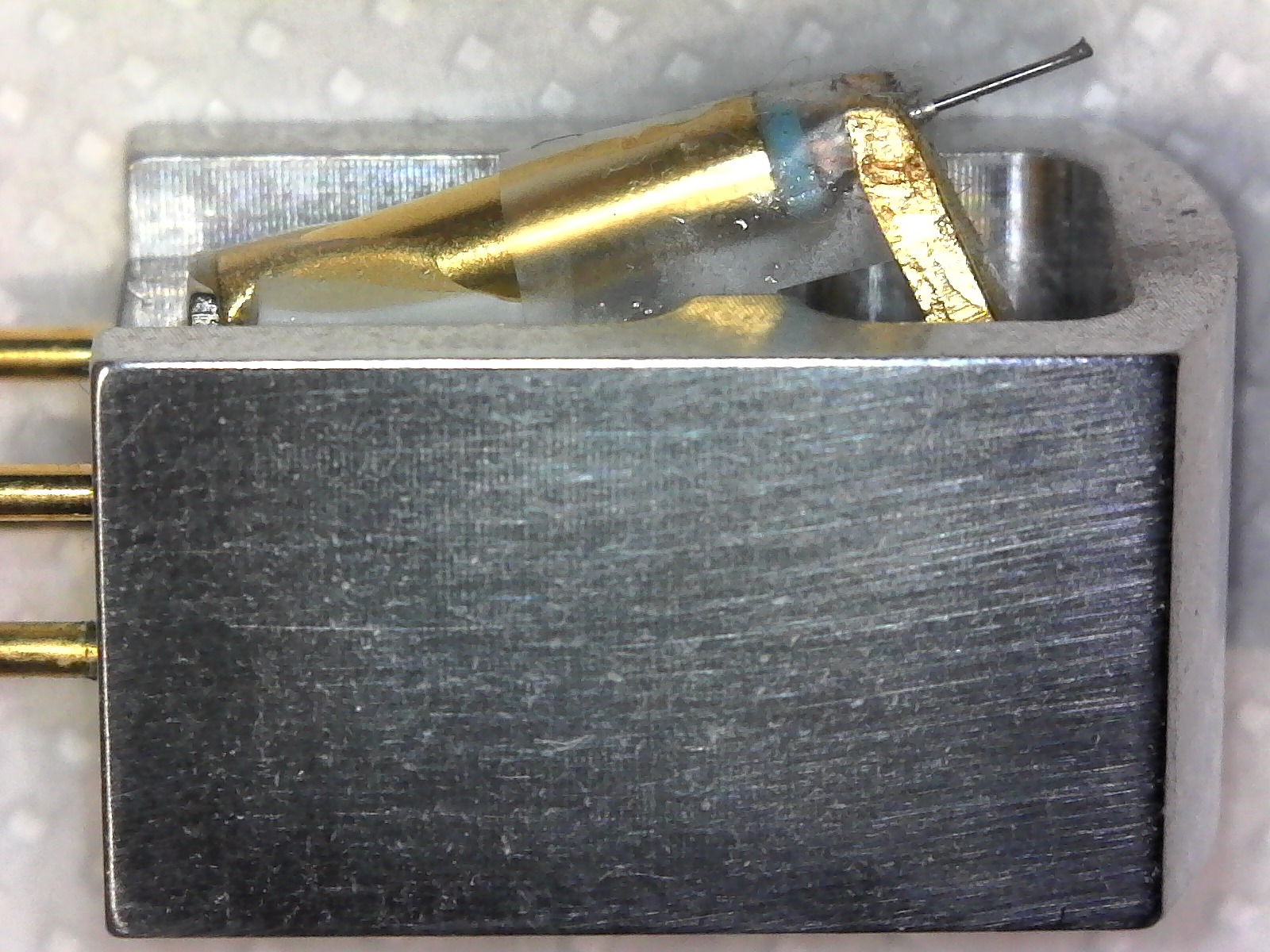

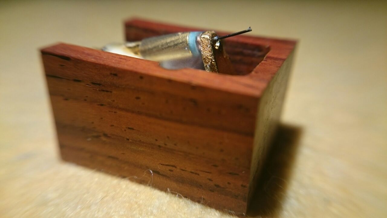

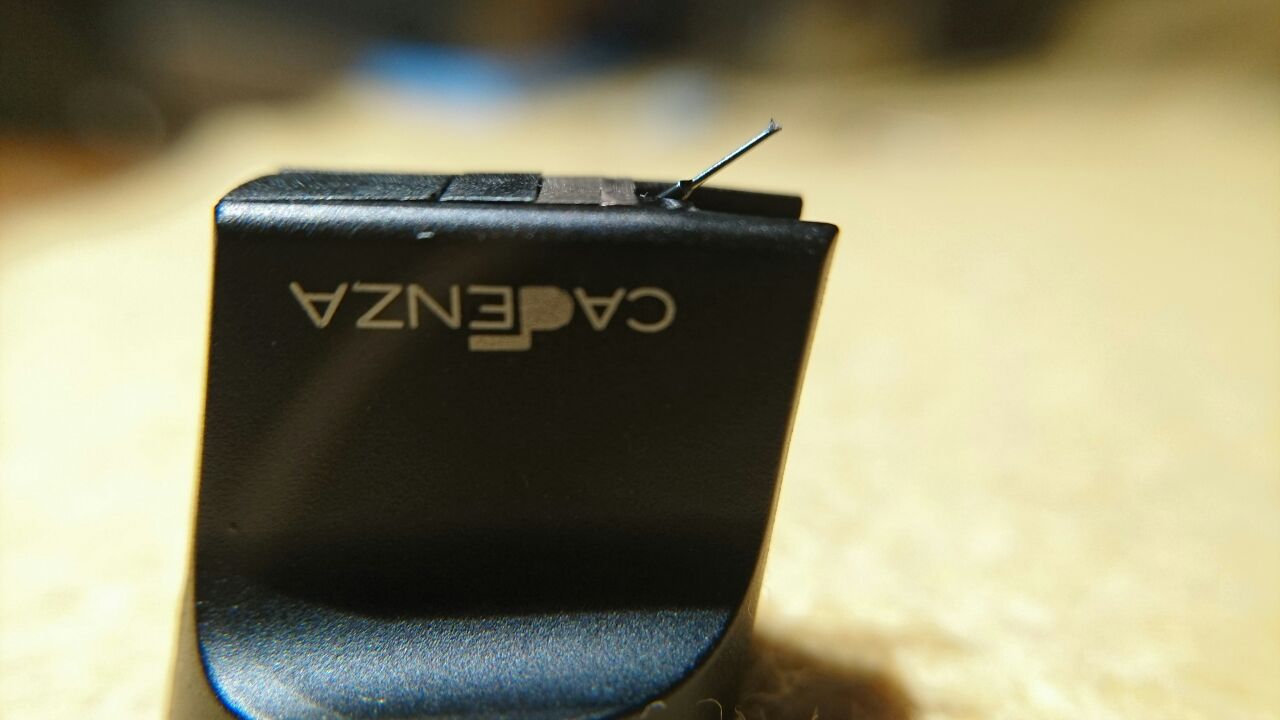

Niffy,
I have previously had my broken Cadenza Black fixed with a JICO SAS/B (boron cantilever and microridge diamond), but unfortunately the diamond fell off the cantilever a couple of months ago. So, I had to have it retipped with a Namiki microridge diamond (without changing the boron cantilever). It should arrive any day now from abroad.
I had done the same upgrade with two of my DL103R, which were sonically boosted very significantly. However, the upgraded Cadenza is at an even higher level than the upgraded DL103R.

Niffy,
as you probably know, the DL103 has a spherical tip, whereas the 103R has an elliptical one. Changing the plastic body, as well as the cantilever and the tip with something more sophisticated, take the 103R to a wholly different level.
Then again, as I've said, the upgraded Cadenza Black is even better. I bought it with a broken cantilever and had it... fixed.
The DL103 is the most upgradable and upgraded cartridges out there. I'm not sure which version of the DL103 I heard, it definitely had a metal body but I don't know about the stylus and cantilever. It might have been a Zu. Still a bit over romanticised for my tastes.
