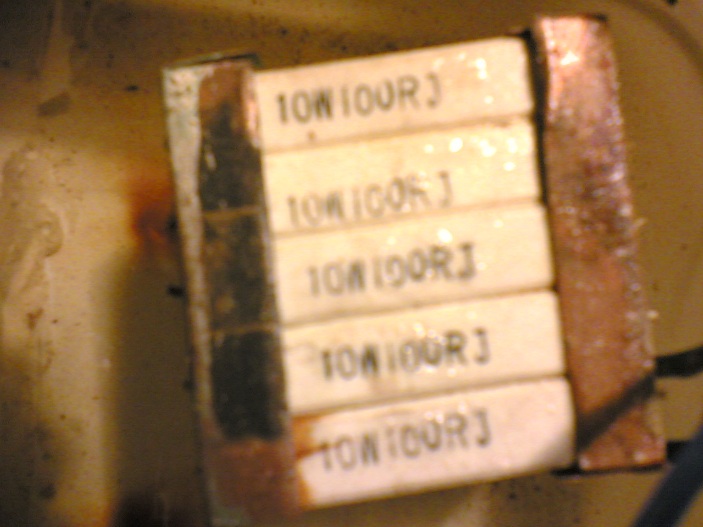

I have conducted some more tests last night and this is what I noted: Ambient temp = 26°C
Eva was right in what she said in a previous post. The battery voltage at 100A is 11.5V. At the input to the CT on the transformer this had fallen to 10.76V. The volt drops were measured and apportioned out to the cabling, connectors and fuses respectively.
I ran the amplifiers at 252 wrms for 6 mins continously and observed that the transformer after this time had reached 82°C and the heatsink 55°C. By this time the battery had almost completely drained as the voltage at the terminals was 11.2V @ 82A of current drain. The input to the CT was then 10.24V and the under voltage protection had then kicked in.
The amplifiers all the while were fan cooled but not the PSU.
Any comments on the data above will be most valued. I need to know if the transformer temperature is too high.

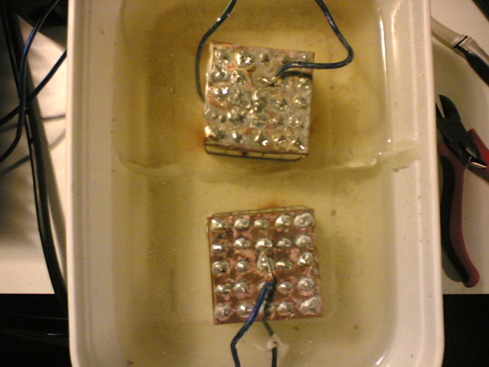

No I havent. I have played it with a sine wave at 1kHz into those resistor loads continuosly. At that point after 6mins the water in the container was almost boiling.
I dont have 4Ù speakers that have an rms rating over 250W.
I wonder if there are any car speakers that have such a high rms rating apart from subwoofers.
My intention is to drive an 8Ù 600W subwoofer (that I hope to acquire shortly) in bridge mode
