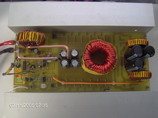

I have made a new board and this is what it looks like:

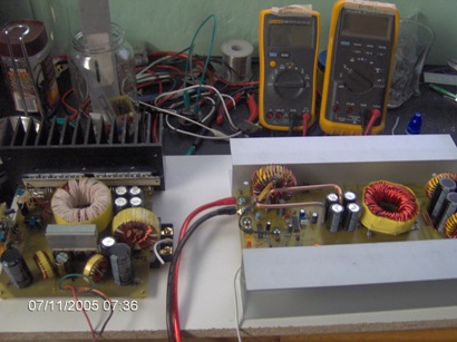

This is the old board compared to the new one:

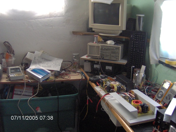

This what my setup looks like in my miniature lab
I have yet to populate the board completely but initial testing of the PWM chip and protection circuits are good.
Will post and update as soon as I have completed successfully.
The older prototype is working (was made about 1 year ago) but is the one I described that had the problem maintaining +/-63V at over 660W drawn from it.
In any event this board started out as a 3 x FET per side PSU and eventually after realising that the heat generated was just too much even for such a big heatsink and not to mention blowing up several sets of FETs with spectacular fire and smoke displays I then chopped off the part for the FETs and gate resistors and etched a small board the same size with 5 FETs per side. This worked quite well but the board was rather flimsy (epoxied) and not to mention ugly with all the late additions, soldering and desoldering etc.
I etched the new board last Sunday and I have completed drilling and now am slowly populating the board. I have tested the PWM chip and the protection circuit and everything is looking good. I need to mount the FETs and diodes and then begin testing. I need to juggle a full time job as a DBA and this unfortunately means I can only do a little at a time.

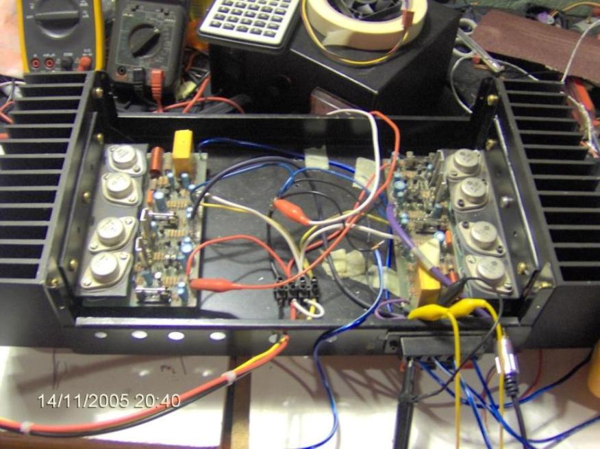

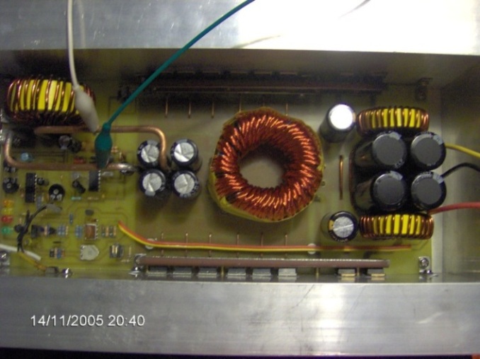

Tests conducted this weekend proved satisfactory yet there are some issues I noticed:
1. The ringing frequency is in the order of 5MHz which required 15R and 680nF cap is series across the primary winding. This seemed to have squared off the waveform but their is still slight ringing noticeable at a 10% duty cycle. Is this normal ?
2. The output voltage regulation does not remain constant at 63V with no load but seems to decrease slowly to about 58V. Something I noticed was that the opto ILD55 seemed to be running a little hot as well as the resistors.When I kept my thumb against the case of the ILD55 the voltage went back up and seemed to stabilise. Any ideas ? Could the series resistors be too low a value ?
Update:
I have tested the converter with both channels connected and measured (33.34V/4R =>276Wrms per channel clipping. The output voltage from the converter held up pretty well considering that the Batt V fell to 10.5V measured at the bus bars in the converter. The total current pulled from the batt was 107A measured with the clamp (yes I know "Its not accurate") but the 2 x 50A fuses are still intact. The transformer though ran hot to a point where you cant keep your fingers on it for longer than 5sec. Heatsink for the converter was cool though. This test was conducted for a full 3mins (amplifier heatsinks was extremely hot).
In real music terms however I doubt any piece of music could place such a tremendous stress on the converter. I also doubt if anyone could sit in a car that has 540+Wrms of sound
A BIG BIG thanks goes out to Perry Babin, Eva, Pierre and others for their valued input. I think my initial problem was transformer saturation due to high flux levels.
There are still a few bugs to iron out.
Like when the power is removed from the remote-on the voltage jumps up for a split of a second to 80V + and then diminishes.
