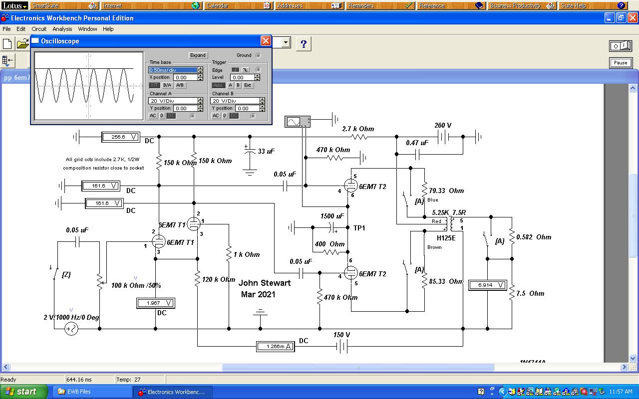

Hammond 125A is much better for low power / high impedance application. It has 15 H primary and sufficient power capacity.
Attached the simulation with 125A at 11.6k to 8 ohms. Output level >600 mW.
That looks a lot better, 3dB point looks to be well below 100Hz and Hammond only specs it for 150Hz anyway. I still think it would be worthwhile for someone to actually measure the inductance of a 125 at 20Hz because then the sim would be more realistic.

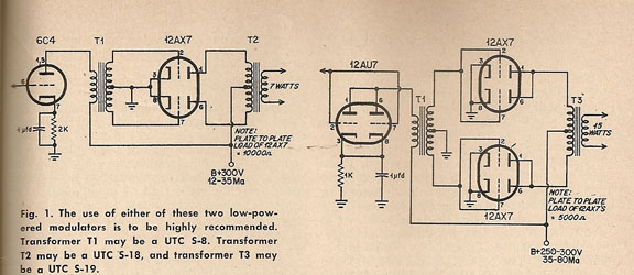

Lots of distortion, predominately 3rd Harmonic. But typical of driving a 10K load from a triode source of about 15K. Doesn't anyone check the old electronic text books anymore?
PP 12AU7 makes a good modulator for a low power transmitter. But not HIFI. Same goes for a PP 12AX7.

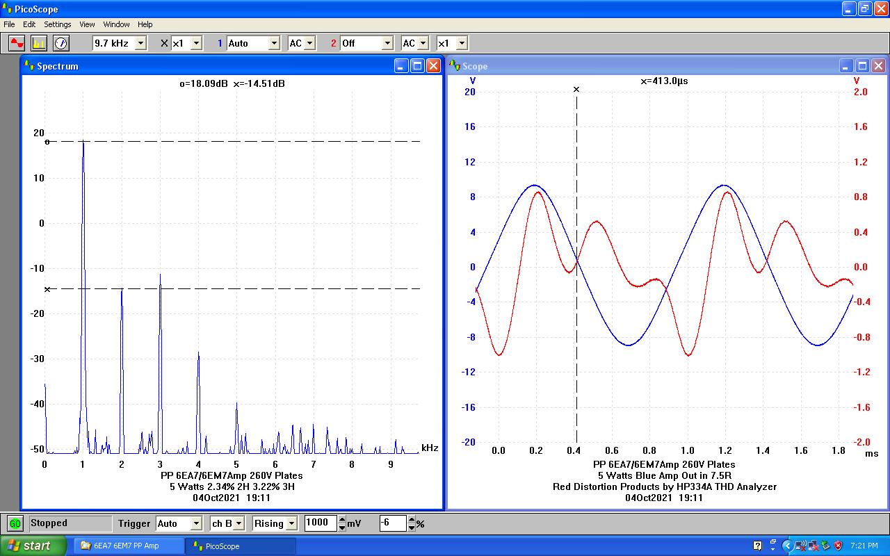

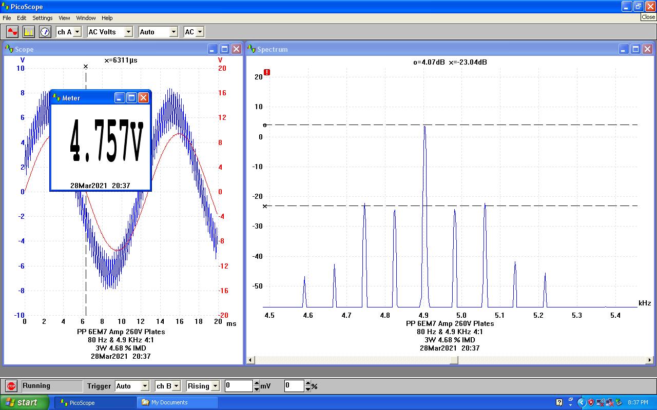

My most recent project is an experimental PP 6EA7/6EM7 amp. It clips at about 7W. The test results are very good.:)
Many experimental amps on the shelf here. Not sure what to do with them, now at 89 yrs.:)

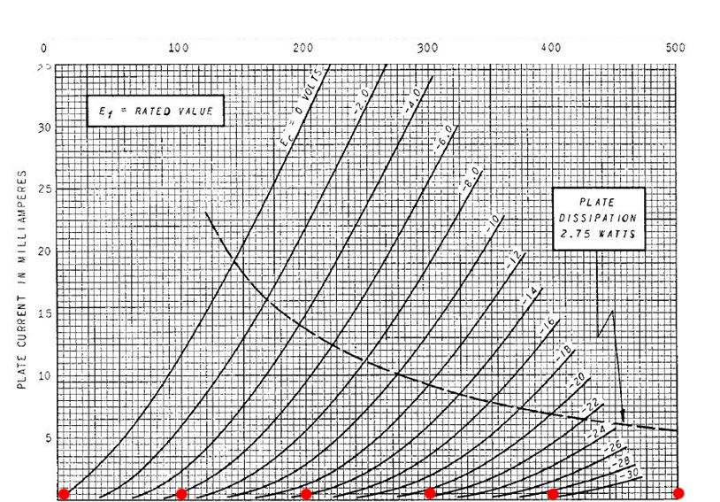

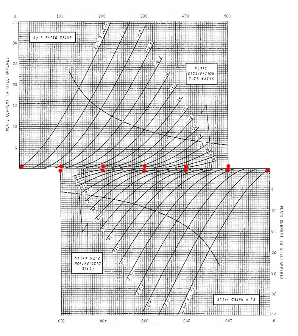

Here is the real answer for all to see. Looking at the 12AU7 plate family we see that the grid voltage curves are closer together at the RHS of the graph than at the LHS. This is the prime source of even order harmonics (2H, 4H, 6H.....), It is also the reason that as signal increase the DC plate current also increases. Some people call this rectificationThatIt is also the Zeroith Harmonic, just another even order harmonic in the Fourier Series created by operation of the tube.
By rotating (not inverting) the plate family & lining the result up with the original we have the composite family, the push-pull version. We can construct on this any loadline we like as long as it passes thru 300V on this example. Other constructions for other operating plate voltages are possible.
The same grid voltages are still squeezed as before but they are now at the center of the loadline. So Odd Order Harmonics a caused by the same triode property as in the SE case.:D
Everybody got that? There might be a test after this!:eek:

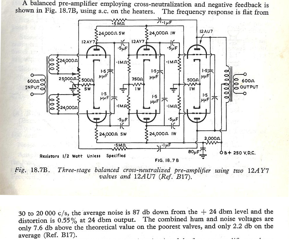

!2AU7 used in Broadcast Line Amp
Lifted from RDH4. Uses low noise 12AY7s in the front end.

THat is very much the kind of thing I had i mind when I said I had seen PP 12AU7 stages in broadcast mixers from the 40s/50s.
