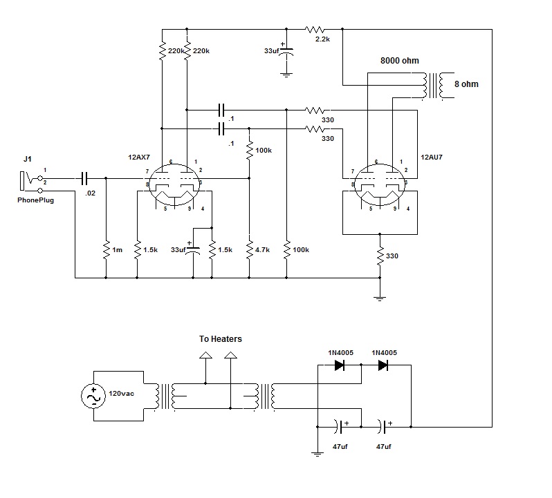

I'm taking a shot at a mini stereo amp. Per-channel it uses 2 dual triodes to make the PI (12AX7) and output (12AU7) stages. I'm using a cheap $5 PA matching transformer for the output transformer. A couple cheap 12vac transformers will make my power transformer. I'm stepping 120 down to 12 to grab heater power then stepping 12 back up to 120 with the second transformer. A voltage doubler provides me about 300vdc. My output transformer has an 8-ohm secondary and quite a few taps on the primary.

I'll use the 4000 for my center tap and 0 and 8000 for the 2 phases. B+ will be around 225~275v to the 12AU7 and 200v to the PI.

I'd suggest changing to "floating" paraphase inverter for better balance.
If I knew what it was.
Also you're throwing away 2/3 of your voltage swing at the 12AX7 (220K plate load and 100K grid resistor).
As far as I know the 100k on the output tube's grid is to match the PI's voltage divider (100k+4.7k) on the other output tube.
And 2K is the center-tap...
So 2k center tap, 0 and 8k for phases? Why is that? Shouldn't they be equal impedance?
but 8K is pretty low for 12AU7s

Thanks. Lots of usefull data there. It still doesn't answer why I'd want a difference impedance for the 'push' then I would for the 'pull'. :confused:
The impedances are the same (symmetrical), but by using the centre tap you end up with 4ka-a rather than the 8k you expected.
For small-signal valves you really want one of those really small line OPTs, the ones that offer you several primary taps up to about 1W (usually 0.1W, 0.25W, 0.5W, 1W). That way you can get impedances up to 10k, which are more appropriate.
Right. So wouldnt I want 0-4000-8000 with 4000 as the center tap? That leaves 4000 in each direction. Tom said 2000 is the center tap. How can that be? That makes 0-2000-8000. I'll have 2000 on one phase and 6000 on the other.
OK this is how I'd explain it..
What you really want is an equal number of TURNS on both sides of the center tap. Think volts not impedance.
So the number on turns from one end to center is 1/2 the number of turns from end to end. Doubling the number of turns increases the impedance by a factor of four. Remember impedance is proportional to square root of the number of turns. So the center tap to end is always 1/4 the total impedance in any transformer with a center tap.
Try this experiment: Connect a signal generator to 1/2 of you output transformer and look at the volts on the secondary. (Use a 12V heater transformer or wall wort for the signal generator if you have to.) Then switch the signal so it is across the other half of the OPT. You should see the same volts on the secondary (give or take a few percent) if you have the "correct" center tape. This way you can pick the correct tap even without having too understand this. Just pick whichever one give symmetric results.
