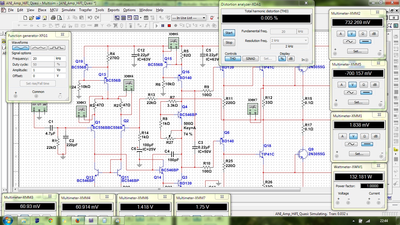

Hi Hadighorbani,

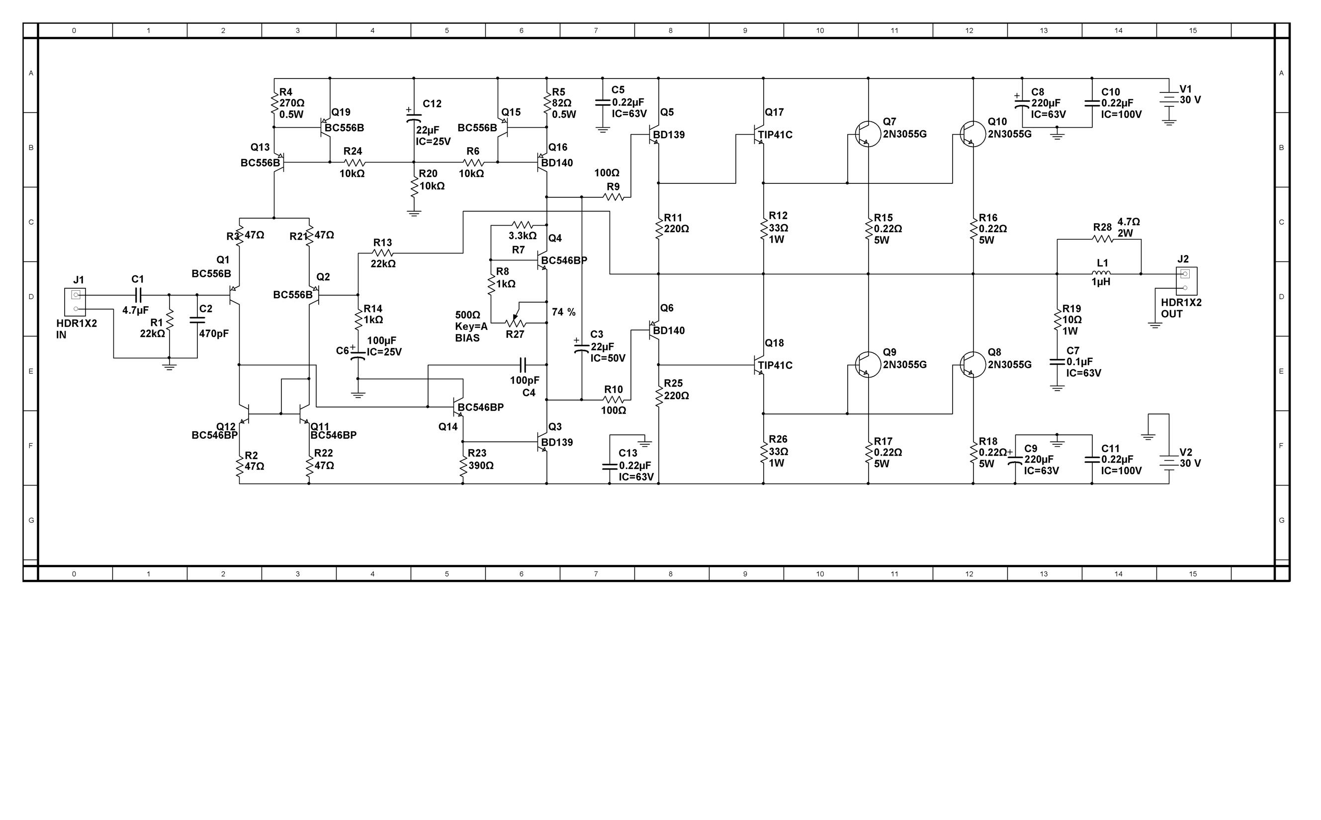

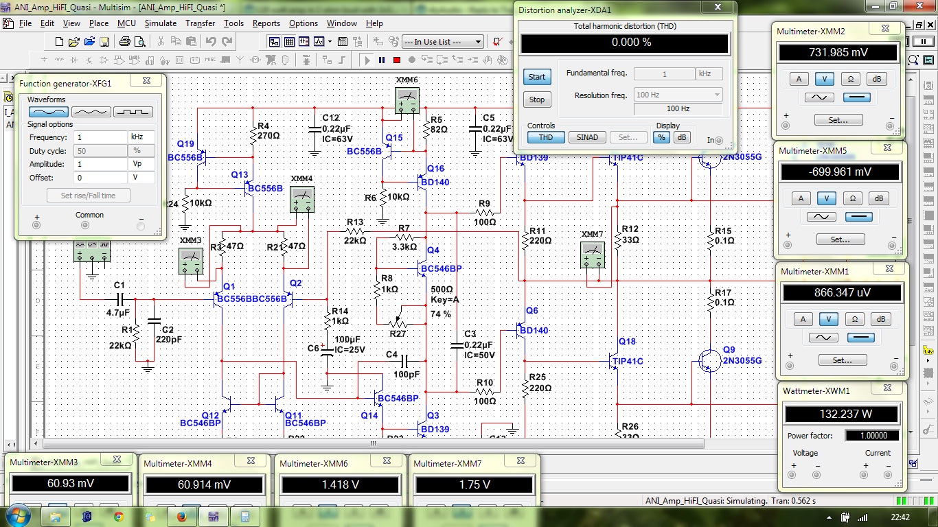

Quasi's Nbip amplifier would also serve your purpose well. A number of schematics are already proposed earlier in this thread. Your load is 2 ohm, so i assume that you need a subwoofer amp or for low frequency amplification.
So here's my try for the components you specified. All BC556/546 for input stage, BD139/140 for VAS and predrivers, TIP41C drivers and 2N3055 outputs. It's TEF configuration, LTP runs at 2.5mA, VAS at 8mA, drivers at 20mA and +/-30V supply. It's based on Self's blameless amplifier and is very stable in simulation. THD figures are 0% @100Hz, 0%@1kHz and 0.005%@20kHz 130W into 2R.
Aniket

Hi Hadighorbani,
Aniket
thanks friend
do you have pcb for test it with ?
