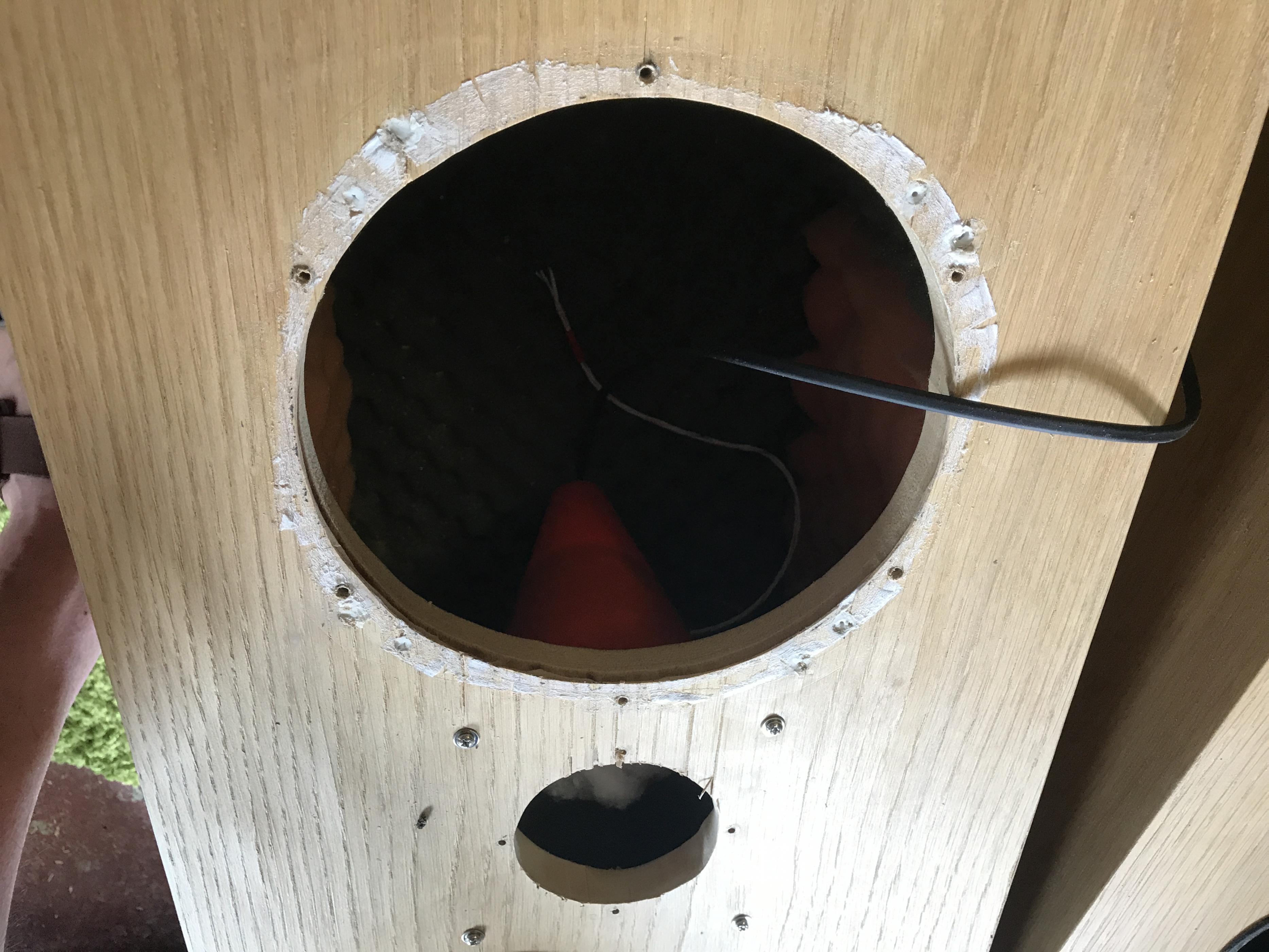

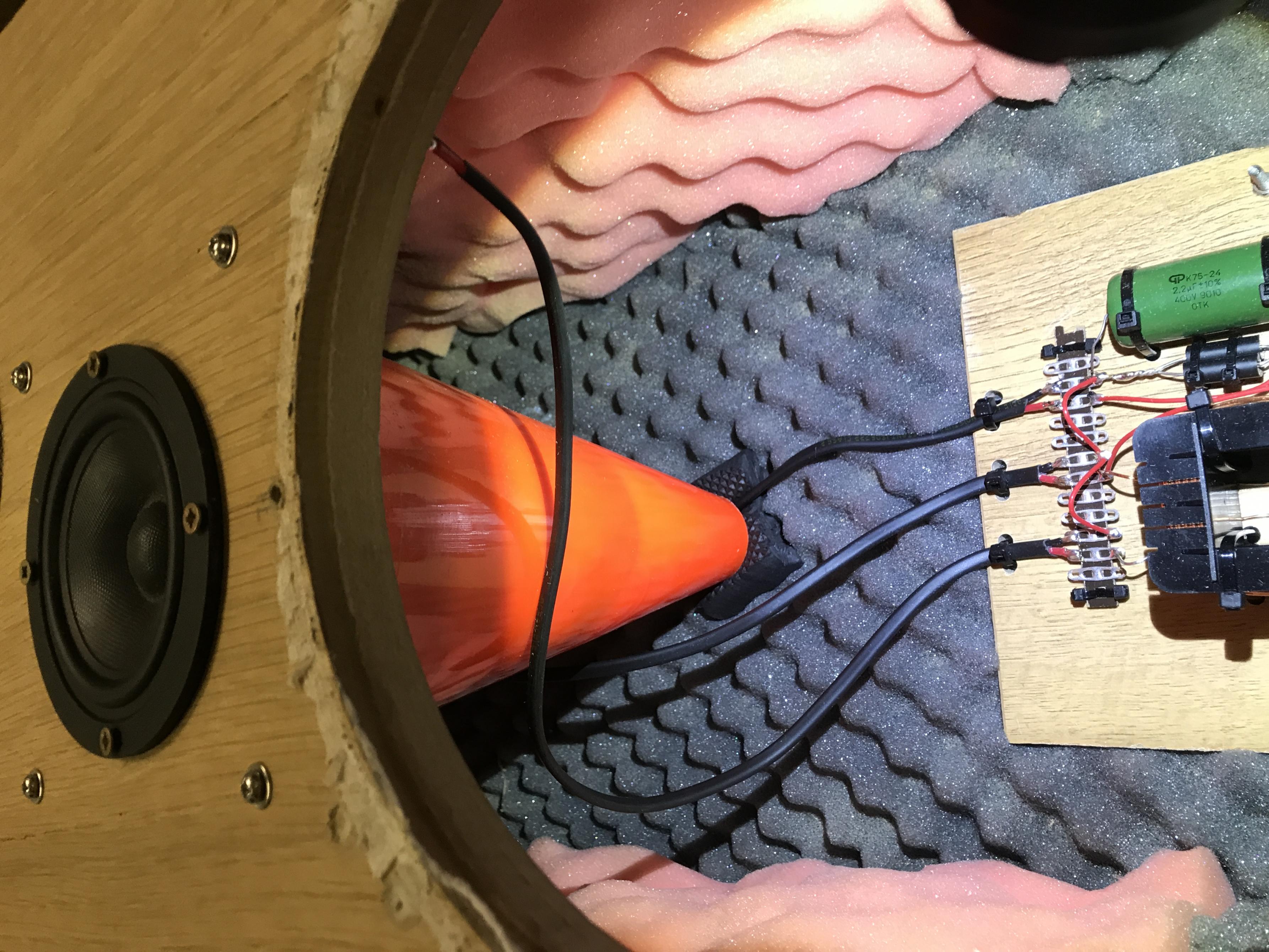

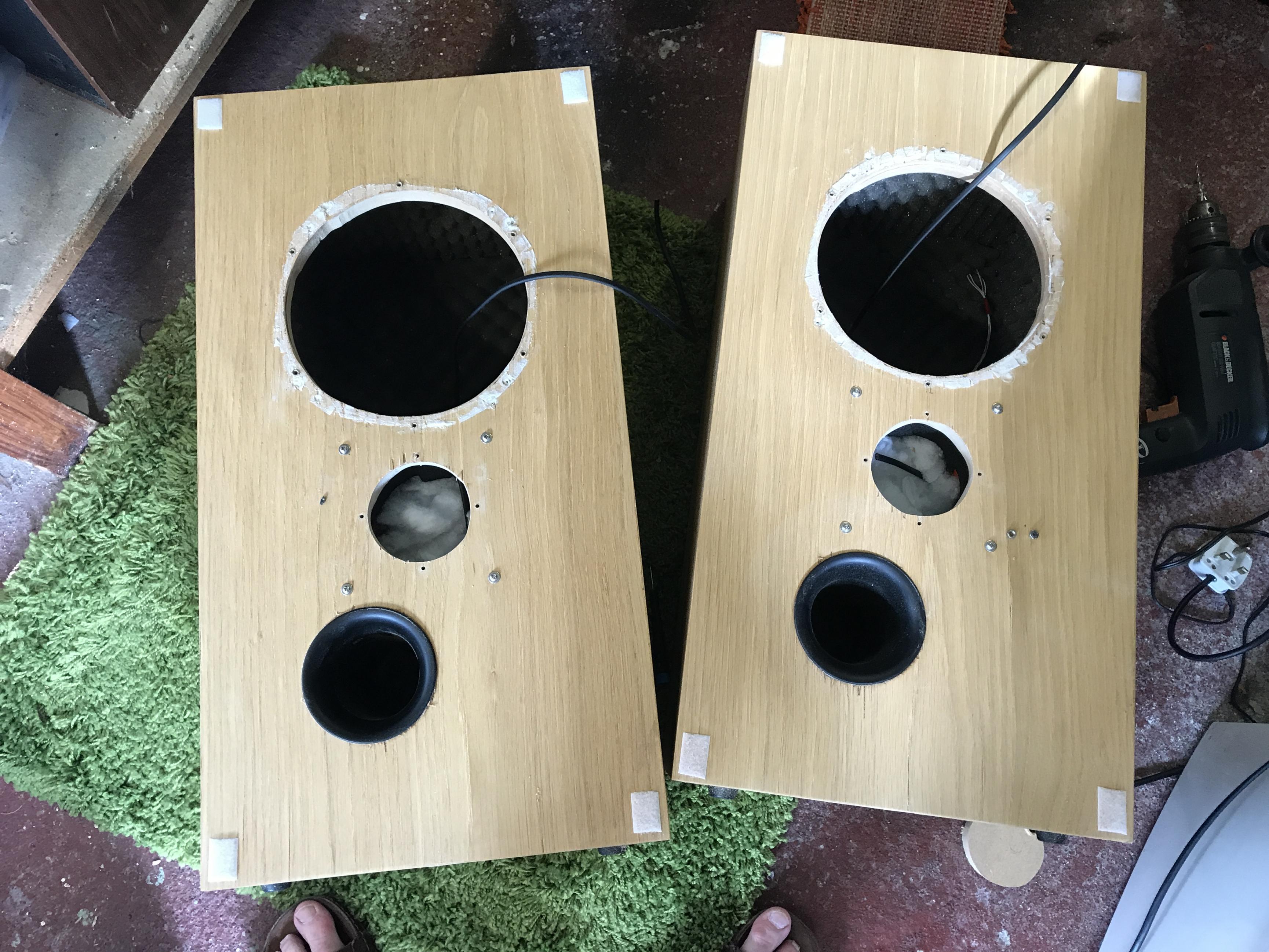

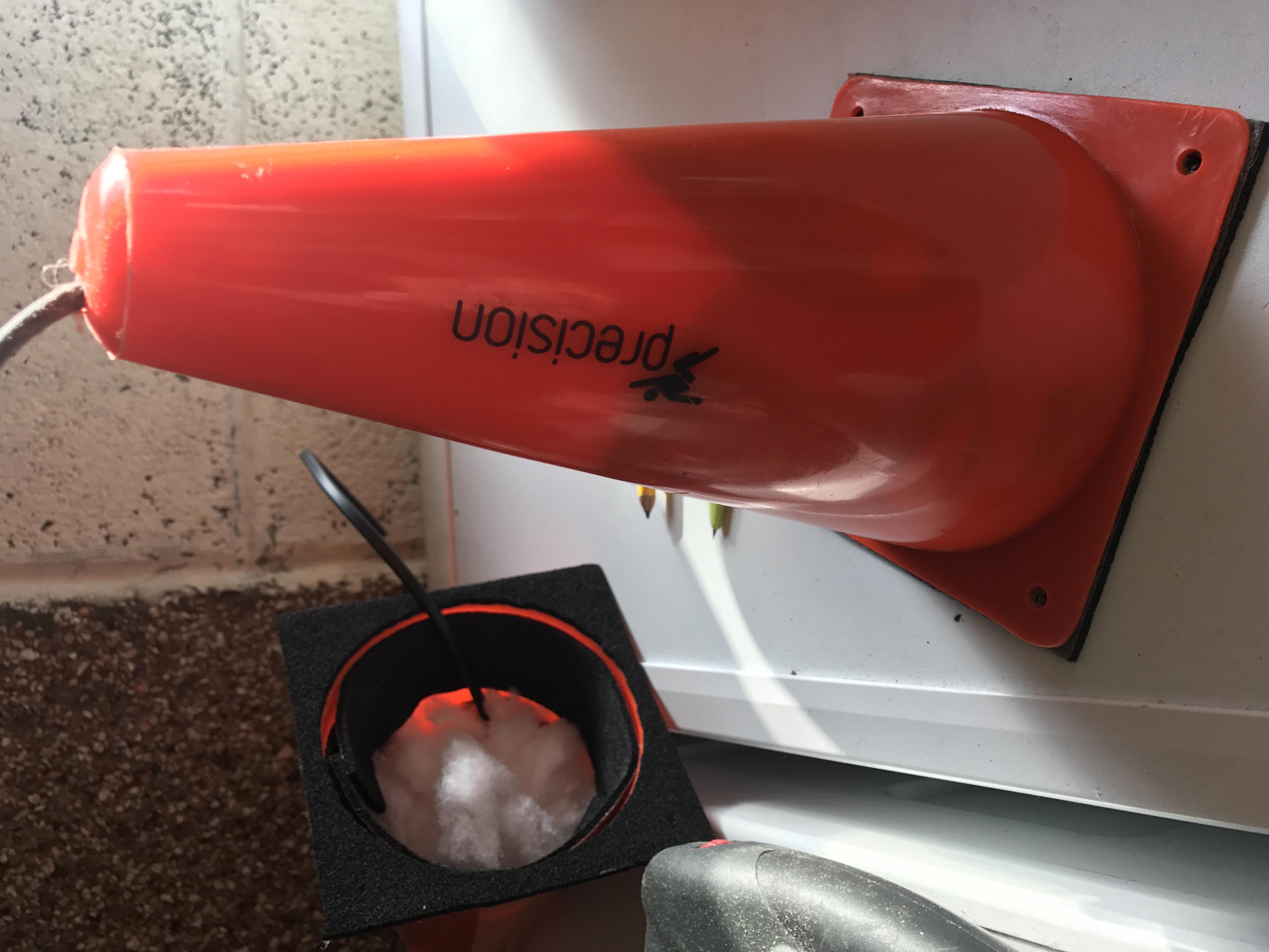

I'm finally getting close to finishing my version. I managed to get both pairs of divers (10F/8 and RS225) cheap on eBay, apparently lightly used. I already had spare 45L vented cabinets cut for an 8" driver - I changed the port to suit the RS225 (from memory -3dB around 40Hz or so - it was a while ago). Inspired by XRK971s dagger, I've used two stacking sports cones for midrange enclosures. These are made of some softish plastic and seem very damped, which should be beneficial. Internal volume before damping was around 1.1L.

You can joke, but the cones 'seem' to be pretty good They are made of LDPE and have that soft rubbery plastic feel (like they are designed to be squashed and regain their shape, to a degree). This means they don't really ring/resonate in any way I can perceive when tapping them. Once bolted to the inside of the main cabinet they seem pretty dead. I lined the inside with adhesive foam used for reducing sound from a PC, then some filler from an old cushion.
You can probably tell I'm building these out of odds and ends I have lying around. It's not a scientific venture in any way. I've had the cabinets for years (originally a failed EBS cabinet for a Fostec FE207E) and paid very little for the drivers on eBay. I've got tons of decent crossover caps (motor run, Russian military, ampohm all in oil etc), some unused 4mh inductors, plus a stack of 10ohm resistors.
The nice thing about this build is that I'm not precious about it in any way. I haven't spent a ton of cash buying in parts. I'll use my intuition to throw it together in the best way I can (no iterative testing & measuring) and if it sounds good, woo hoo!

Make sure you don't have a leak from woofer chamber to mid. You don't want the woofer to pressurize the back of the mid/tweeter. Although I think you are doing a center bottom so less pressure on the Dagger than a sealed.

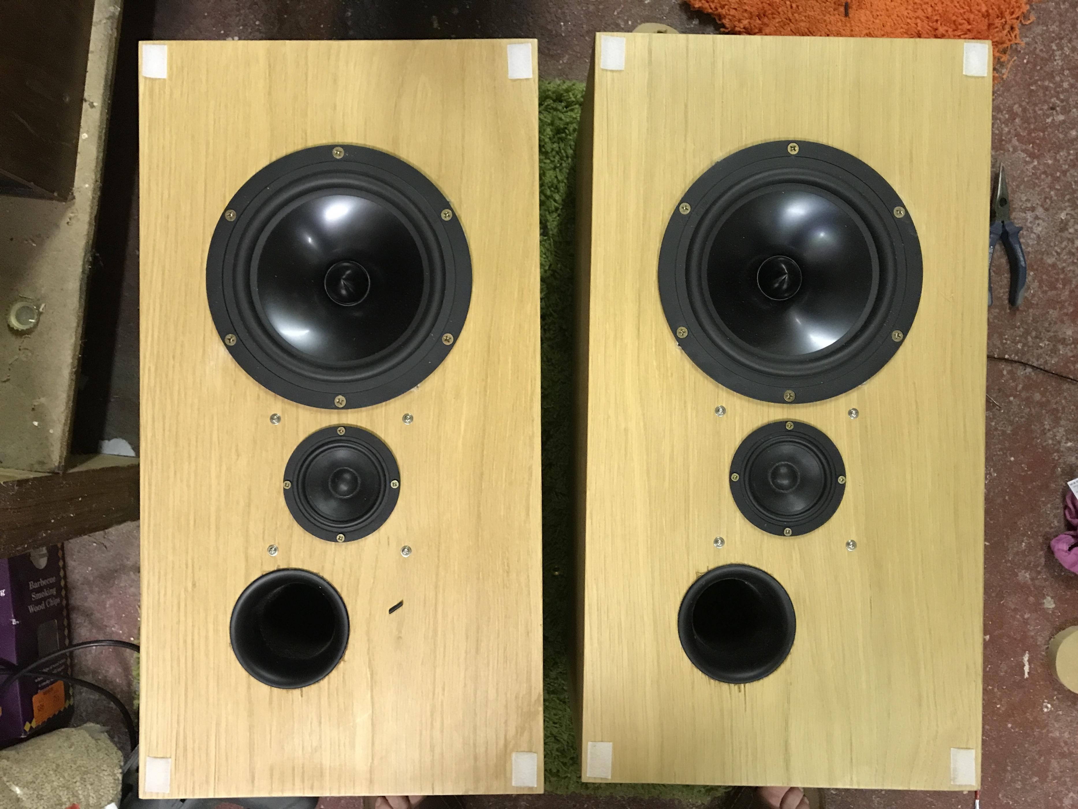

Build finished (for now...). The speakers are up and running in my garage, and sounding as terrible as every other speaker in that environment. I'll give them a couple of days of radio then bring them into the house. Thanks again to X and others for sharing the design and advice - beers on me next time you're in Scotland

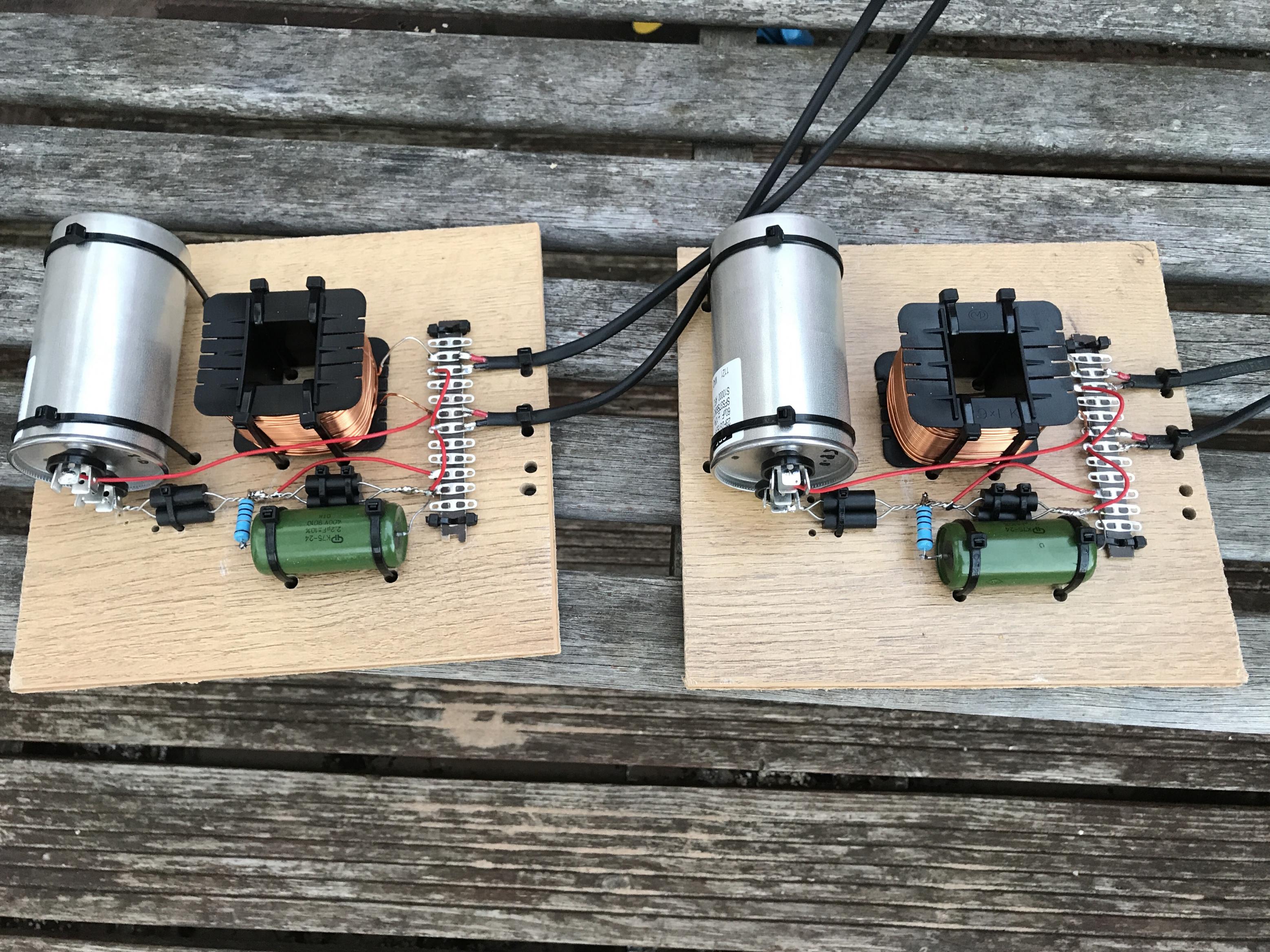

Nice crossovers! Those look like 50uF oil filled motor run caps. When you say they sound terrible in your garage - is that because the space is big and reflective? Indoors and with a good 100w Class AB amp, they should sound very nice in moderate size room. The woofer on top is the correct way to go for transient perfect response. Is it sealed or ported?
The motor run caps are a matched pair of 60uF GE polypropylene in oil (actually both just over 58uF). Resistors are Ohmite WN except for zobel 10ohm, which is a 1W metal film. Zobel caps are matched K75-24.
My garage is 9.6m long with solid concrete floors and walls. I have a workbench on one side that supports the system, so speakers fire across the garage rather than down the length. It's a horrible acoustic environment and all speakers sound hollow and chesty, if that makes sense. I'd be worried if they sounded good in there! I'll move them into the house soon hopefully.
Please put the speakers on stands for best sound. There will be a bad floor bounce cancellation if left on floor. My stands are about 30in high and driver height (10F) is at about 39in above the floor. Place about 3-4ft from back wall for best imaging. You will hav emaximum baffle step loss this way as it is basically floating in open space. However, the soundstage and imaging are superb in this configuration.
