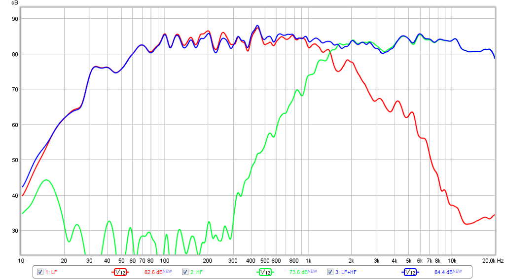

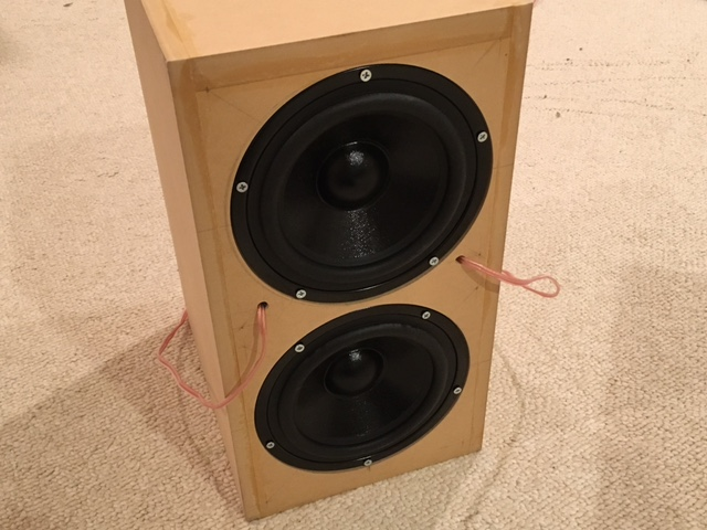

I am sort of going that route with an RS180P and two passive radiators on the back. Much more compact box, but I am making it a 3-way transient perfect with B80 mid and an RS28F in a waveguide tweeter. It's not done yet - the trouble with not having a real woodshop and trying to make wooden speakers. My initial tests are promising but like the adage: "There is no subsititute for displacement" (whether talking about car engines or woofers). A 7in woofer just doesn't move as much air as an 8in. Ideally I would go with 12in even. So good for a smaller room I suppose. RS150 is too small for a balanced FAST in my opinion.

Backside with two PR's:
Some fun with miniDSP as a 2-way speaker (sans B80 hole-filler):
