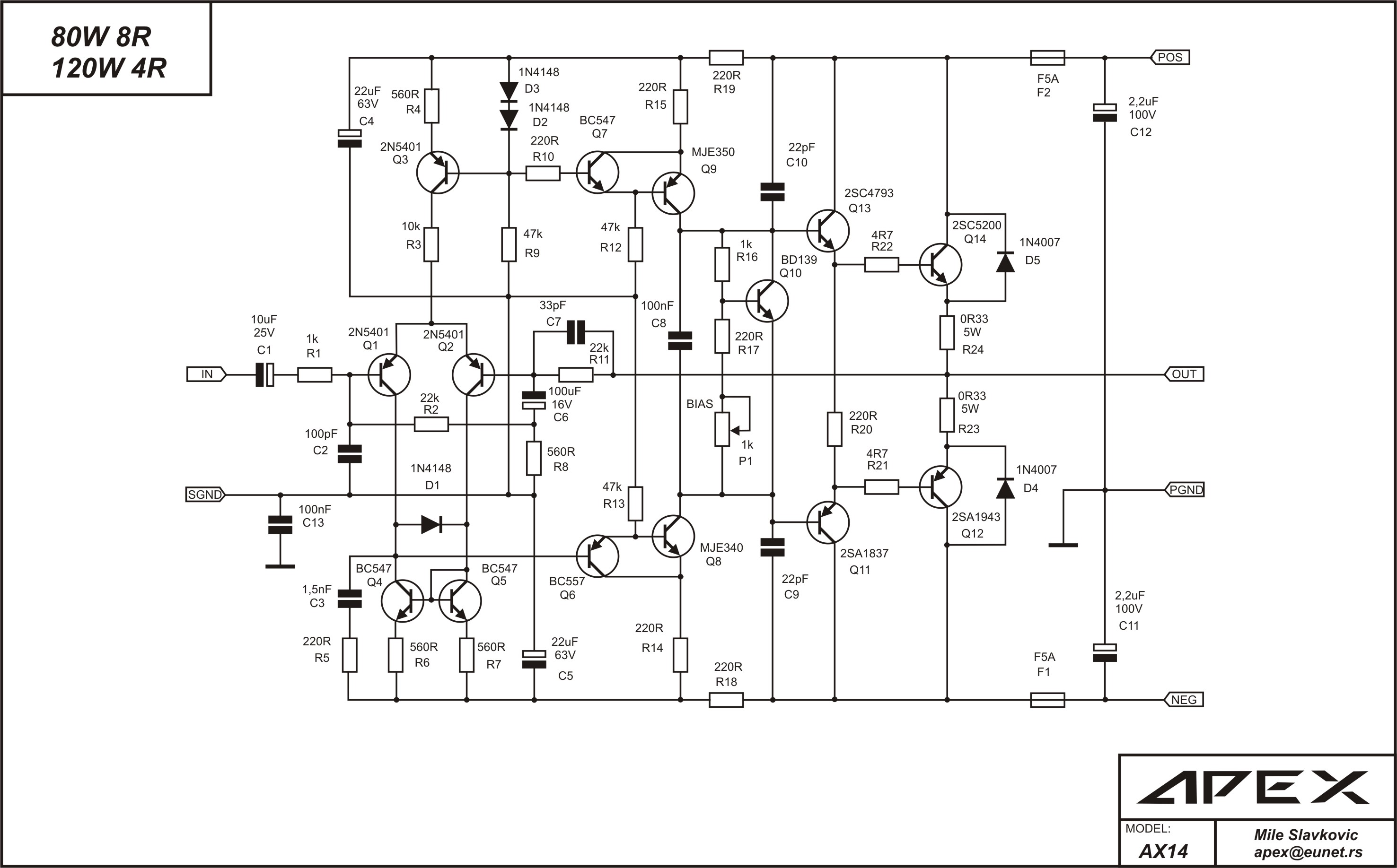

No need for any capacitors.
Almost all apex amplifiers are to be connected as on next picture:
(the SGND (signal ground) from pcb goes to input conector and from input conector it goes to power GND . that is how it goes for both(all) chanels in amplifier chases,each for it self. this is a scheme for AX12 but the same principle is used in (almost) all other APEX amplifier wireing)
hello sir I made AX-14 amp
Is I should connect 0.1uf capacitor from power supply ground to input ground

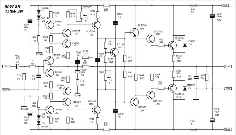

Nazir,
follow the circuit schematic. It tells you the voltage at the base of the -IN transistor.
Look at the emitter of the +IN transistor.
Follow the DC current route through to Signal Ground (SG).
From this route all the current flows in the same direction from emitter to SG.
The emitter and every component MUST be +ve with respect to SG.
Now look at the base of the +IN and compare it to the base of -IN.
Thye voltages at these two bases should be IDENTICAL if the two transistors are IDENTICAL.
The base of +IN MUST be +ve with respect to SG.
Learn to read the schematic !!!!!!! READ !!!!!
Or C6 is incorrect. But I think we have discussed this many times in the past and because there is very little voltage across C6 it doesn't really matter. I would like to see it corrected so it can become an accurate reference for future builders.

thank you sir can u suggest any bass treble board for ax-14

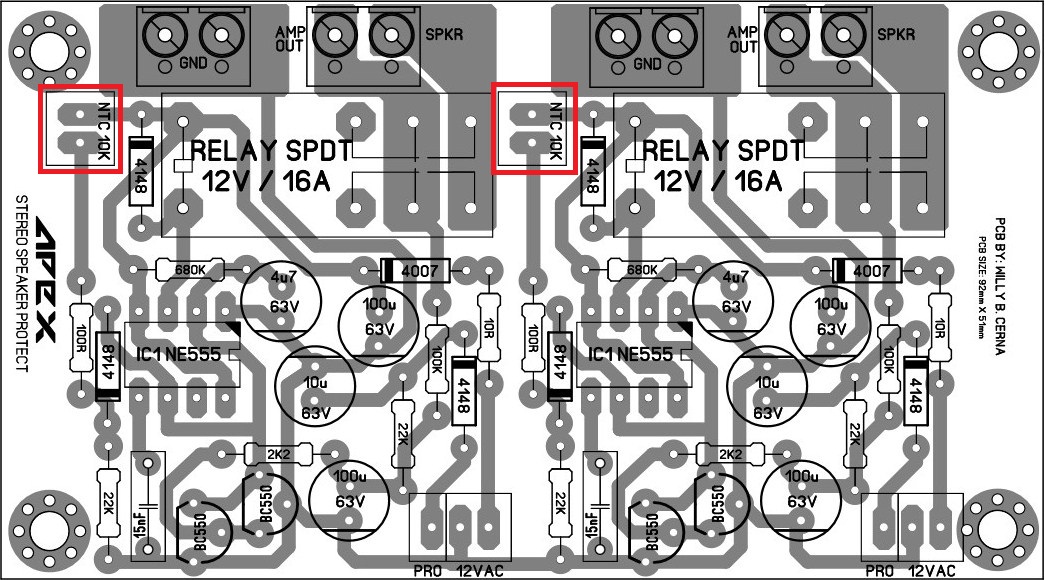

Mr. Mile,
NTC 10K is not available in my place, what are the recommended value can be use instead of 10K??
Willj78
Use 10k resistor instead 10k NTC.
Regards
Regards
Thats Great!!! Many thanks Mr. Mile.....

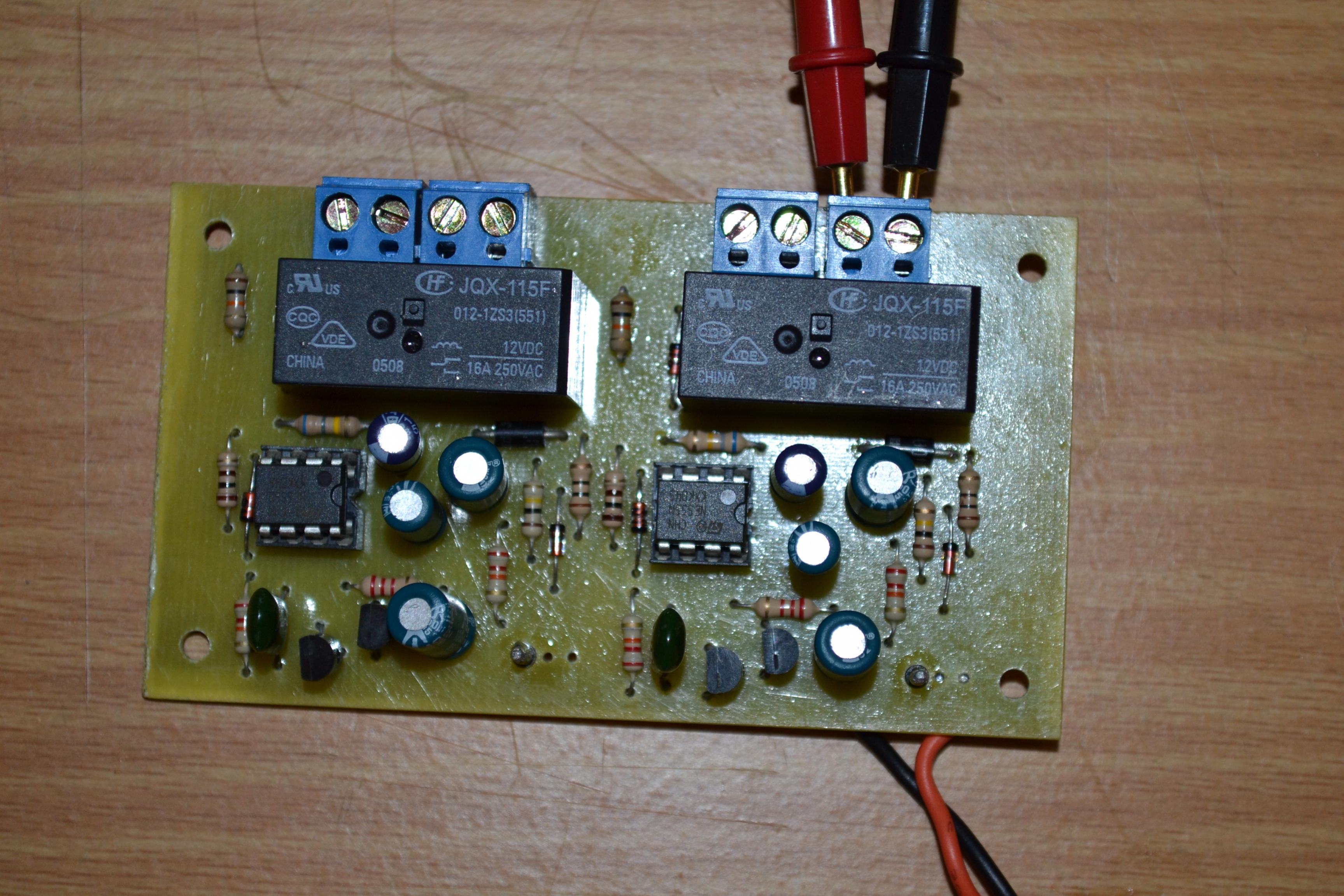

APEX Protect using NE555
Mr. Mile,
This Protect works perfect for my needs, pcb is very small, compact and very useful.
Thank you very much for sharing...
