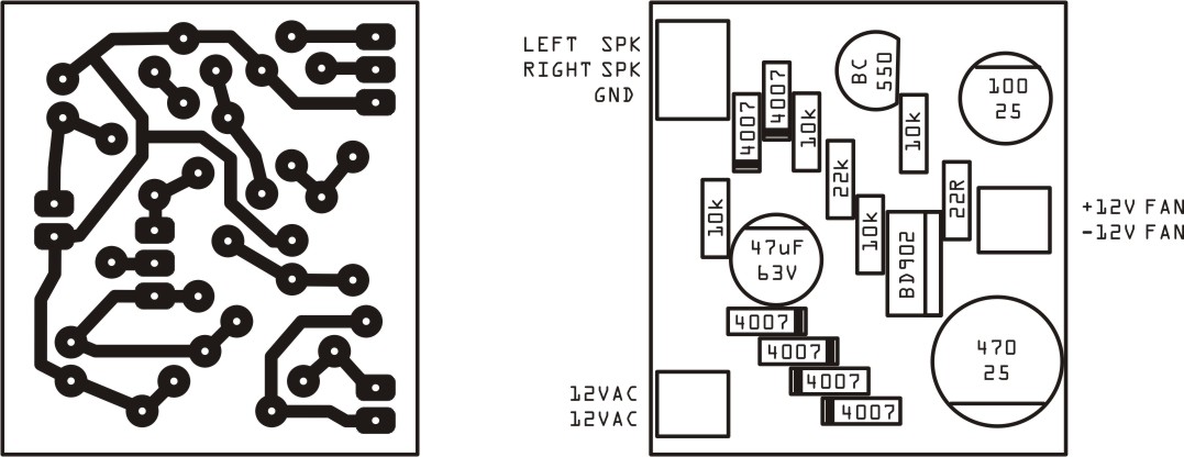

Hello nazirdigi,
Very nice!! and I like your fan controller, can you share???
PCB for fan controller.
This is perfect Mr. Mile
Many thanks for sharing,what is the PCB size?

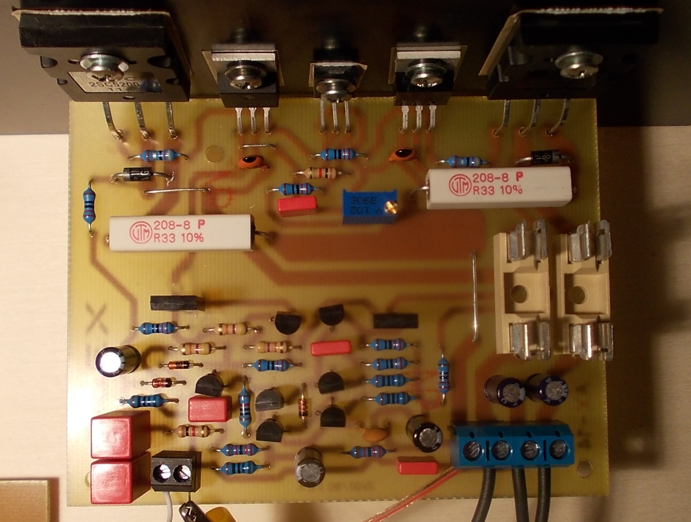

Hi All,
I have finished my first AX14-module. It has nice clear and transparent sound. I like it!
regards, Olaf

Nice work
Regards
oh wow that look really nice and neat good mister olafk congratulations!

I hope you have already the PCB which you are working for AX-14. Olak have done it with parallel input capacitor.

Good to see you here. Can you render a PCB of Apex AX14 with a size of Vishay RN60 series resistor (L-(8.74 ± 0.79mm) W-3.68 ± 0.38mm) and a parallel input capacitor (Wima 4.7uf 50V 5mm pitch). Olafk has done his own PCB. I have done APEX AX14 with his PCB and the sound is very good.

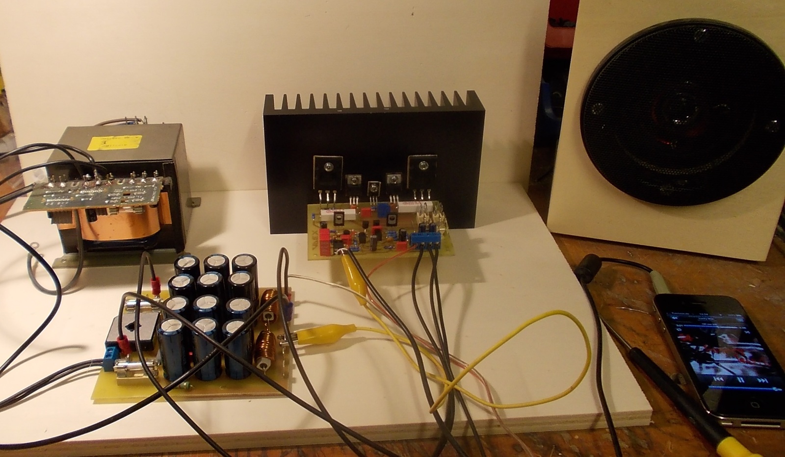

apologize in advance if my english is not good. hopefully can understand and willing to help me.
This my apex ax-14...
(help in correction and give an explanation.)
problem if the volume at 12 o'clock opening his voice so hoarse / burst like over input and output are not able to handle. but if the volume is open until 10 o'clock sound awful. mid clear, crisp treble but not much bass.
Please HELP!!!.
and how to check the bias and dc offset on the ax-14. any parts that need to be checked. to plug in + / - at avo directed to anywhere. and how biased standard ax-14. thanks and sorry if many questions.

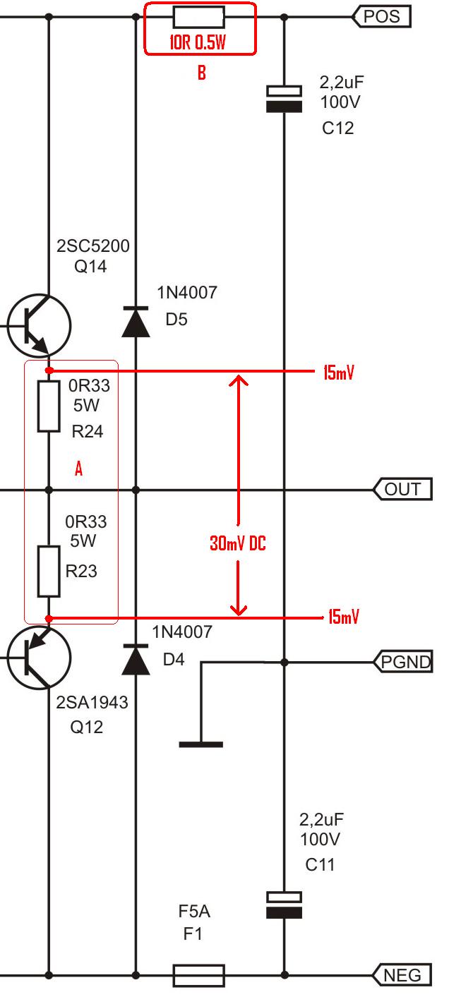

Output transistor must be mounted on heat sink even for testing.
Place 100R/10W resistor instead of fuse.
To check DC out: Connect input GND to PSU GND and place your DMM test probes black to PSU GND and red or positive probe to Speaker out (reading should be in mV DC).
Bias setup: Place your DMM negative probe to Gnd. and Positive to R33/5W or Emitter of 2SC5200/2SA1943 and adjust 1K trimmer to 15mV DC.
Hope this will help…

aku pakai tegangan 45VDC mudah2an gambar bisa membantu.
