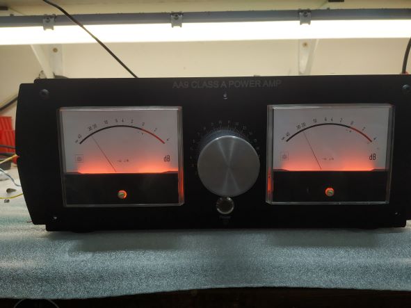

And mostly cloned Prasi's AA9MD board without fuses.
Thanks for sharing Prasi.

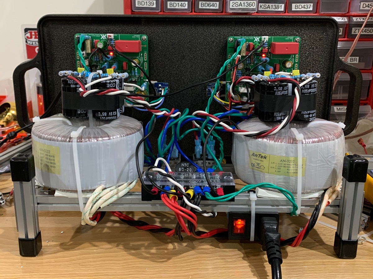

Yes, I had the Bimo Mod FX8 and the FH9 side by side. It’s very apparent the difference. It’s only an extra TO126 and a pot plus a few resistors. The FH9 is really something special. You might want to give it a listen. I’ll even send you some PCBs of the FH9HVX if you are up for it. This is the 100w version.
Here it is on my Griddle Amp:
849179d1591003996-cast-iron-griddle-amp-budget-conscious-heatsink-solution-griddle-amp-final-01-jpg
@kozard, I am not sure if more has been done to the FX8, but I believe the Bimo mod was the latest and widely agreed to be excellent. I have even run the Bimo mod in full Class A. :)

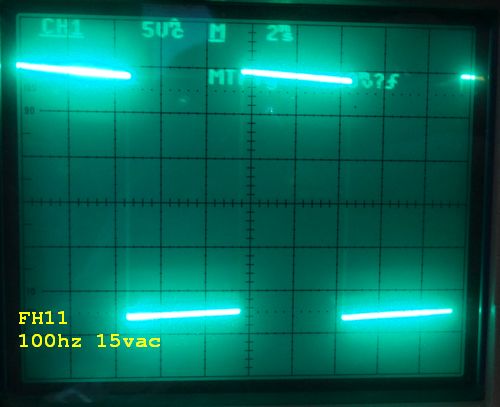

Funny, this is the best looking 100hz square waves I've ever recorded and they are on the FX8. I guess I will have to build a FH9 to compare.
Did you actually build and test a FX8?
Yes, regular FX8 and FX8 Bimo Mod.

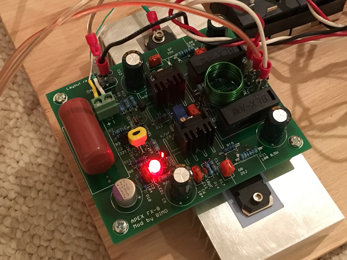

FX8 built about 5 years ago in this thread Post 6918:
FX8 Bimo Mod:
831567d1586286113-100w-ultimate-fidelity-amplifier-fx8-bimo-class-ab-test-closeup-jpg
A square wave doesn't show bass authority as well as measuring damping factor at 50Hz between the two amps.
Lateral FETs typically have RDSon circa 1.5ohm and hexFETs are typically 0.06 to 0.1ohm. So the amp output impedance will be much lower, and this translates to better bass authority.
Did you measure the damping factor of the two amps?
