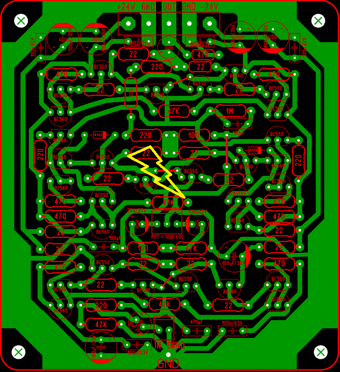

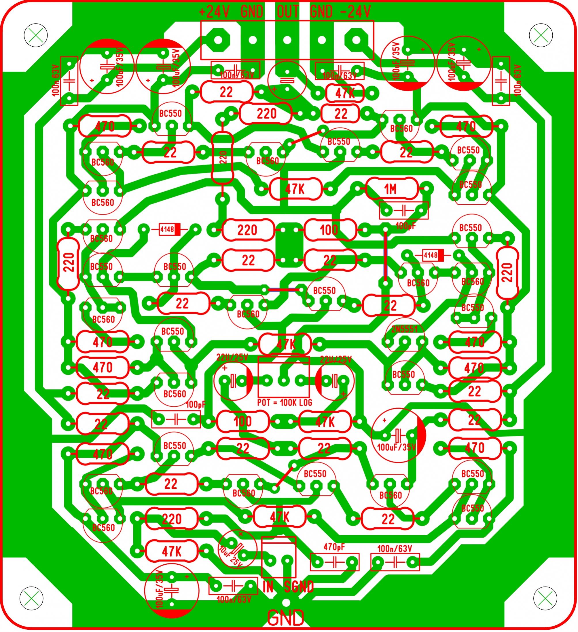

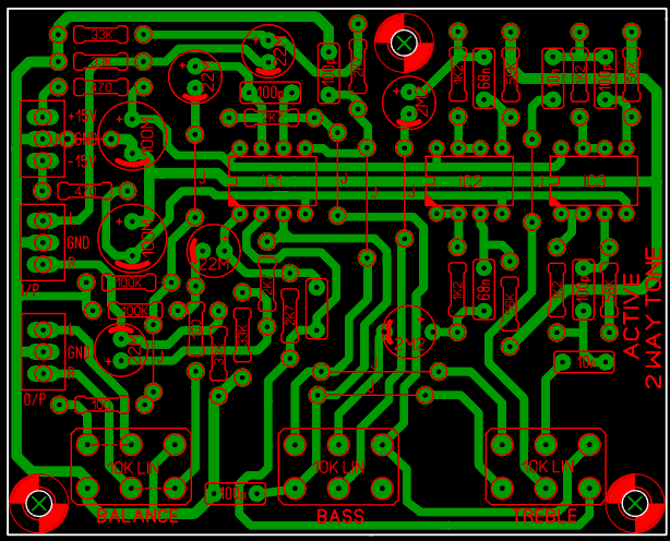

Does anybody have the LAY6 files for the APEX P30? I tried printing and ironing the pcb layout I have, but having a problem with the tracks being a bit to close on the sides. Would appreciate it.
Thanx guys
Here you go.
One pin of the resistor is not connected anywhere.
Terribly sorry. Here is the corrected file. If you already have the sprint file you can just add the missing track.
Didn't see any modification..can you please highlight ?
Hi..
TB3 Modified
Hi..
TB3 Modified
Front hole areas are overun by traces... it will create shorts unless one uses plastic washers/standoffs from bottom....
