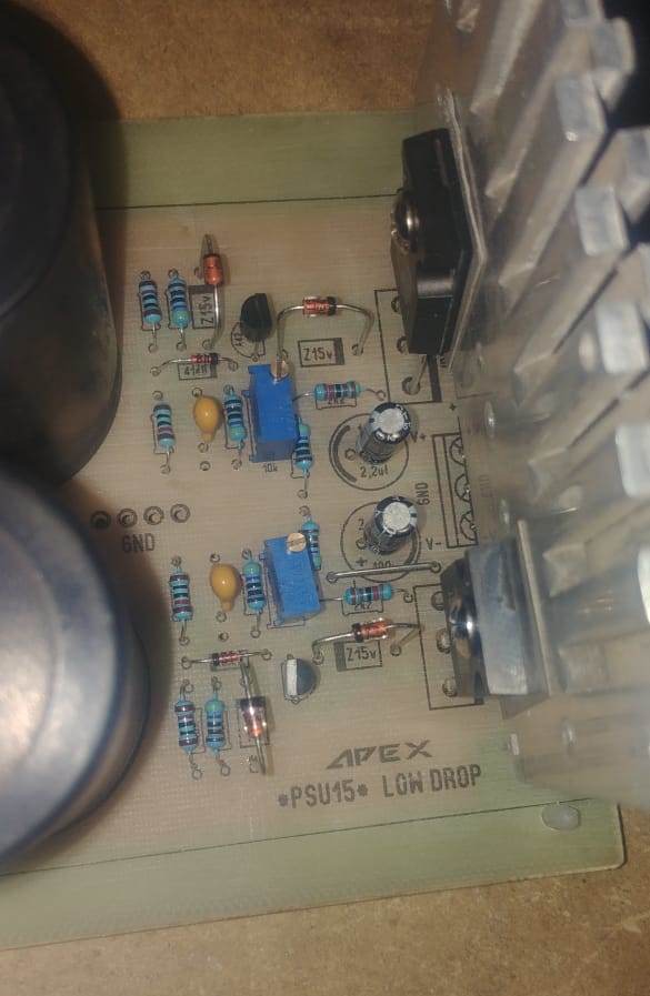

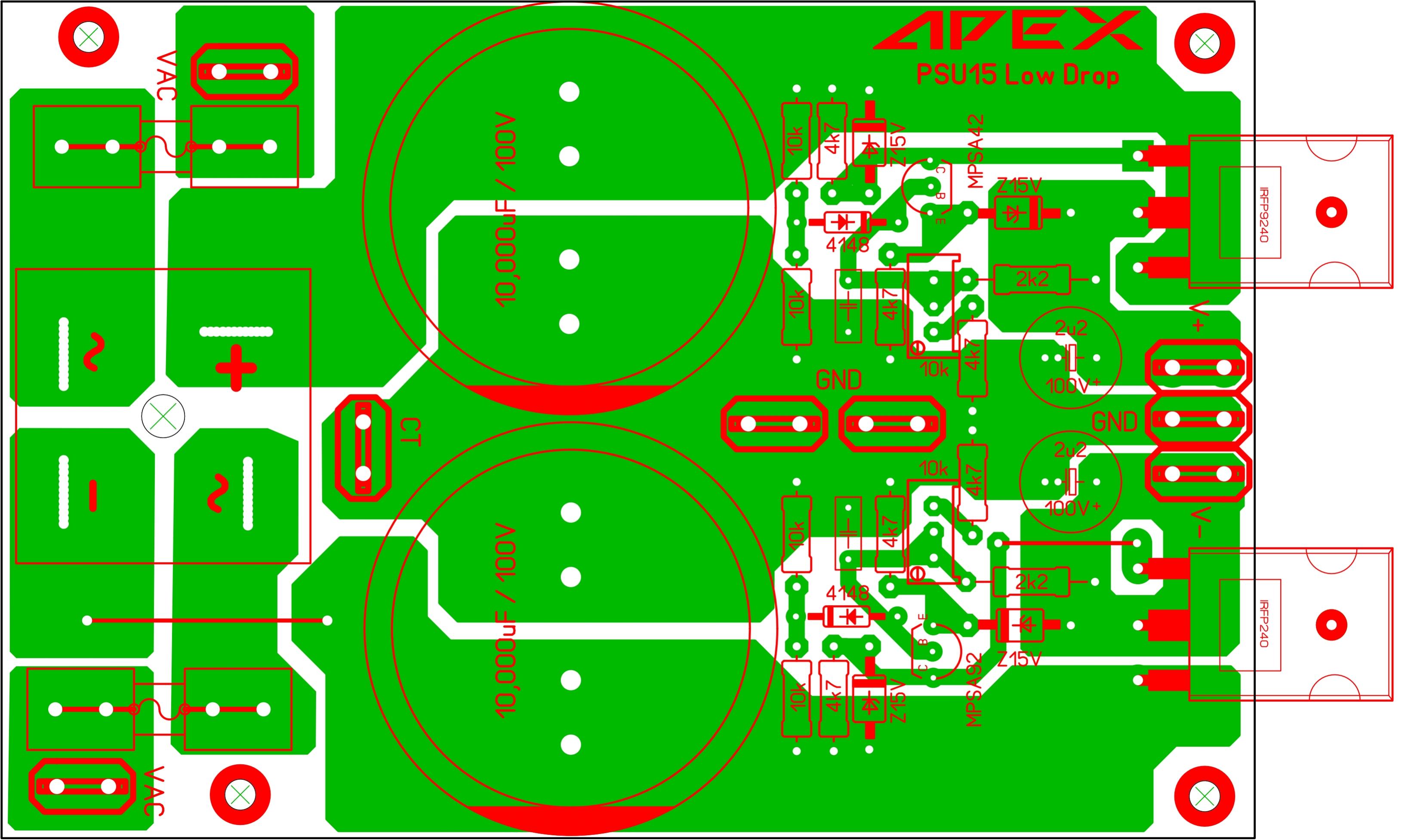

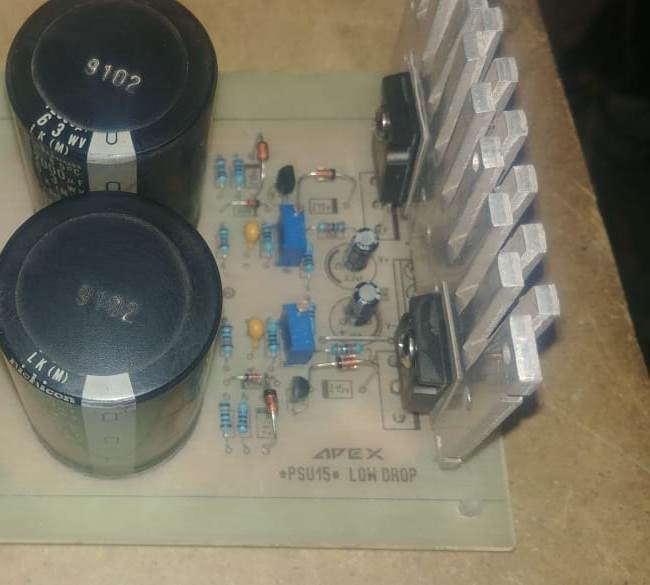

hello sir mile e made the psu15 low drop but at the output I can not regulate the voltage I have a 55vdc transformer and tested with zener 15v-12v and 8v and nothing and designed the prasi version any suggestion sir to be able to regulate the voltage like in psu5 or psu10

Terry has built it and works fine; he reported the pot value should be 5k or 3k.
+ check other things also.

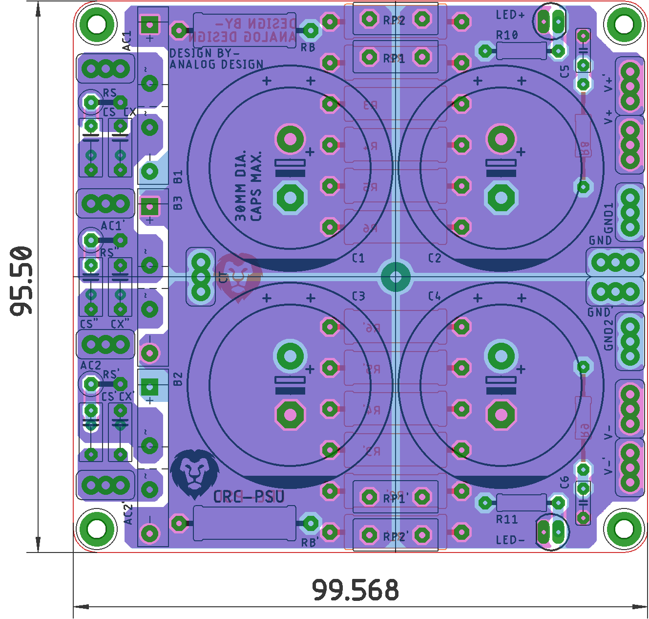

1. using on-board rectifiers b1 /b2:
cs/cx , cx', cs' and rs , rs' are the quasimodo snubber components (optional).
2. off board rectifiers:
connect the off-board first bridge rectifier's +ve WIRE to the B1+ terminal towards the top AND rectifier's - wire to the B1's - terminal.
connect the off-board second bridge rectifier's + wire to the B2's + terminal and then rectifier's - wire to the B2's - terminal.

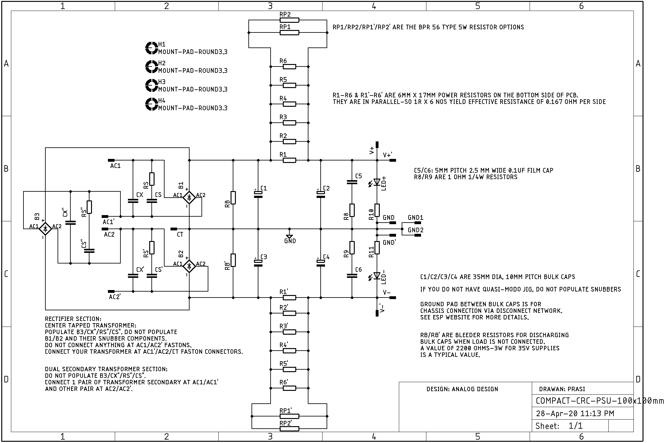

RB and RB' are the bleeder resistors...
R1 to R7 on positive and R1'-R7' on the negative side are in parallel...
So you would be better off using 1 ohm , 1W to 2W resistors.
I will make a 3D on how to mount components...
edit: 3-d pics attached

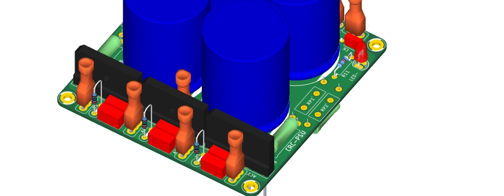

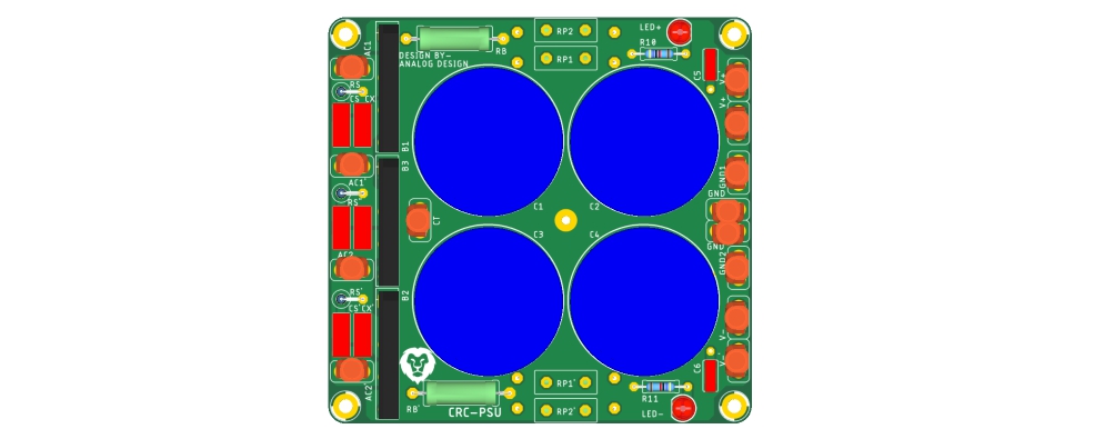

here is a version of above quoted crc with either CT trafo or dual secondary trafo. though slightly larger at 95 mm x 99mm, it can now take up 35mm caps, 6 x 3W resistors or 2 x 5W resistors.
The center bridge to be used only when CT trafo is to be connected.
regards
prasi

Have you measured across the trimmer? I had a solder bridge that shorted the trimmer and locked my output at 42V. I know this circuit works because I just built one for the Apex AX6 Retro amp.

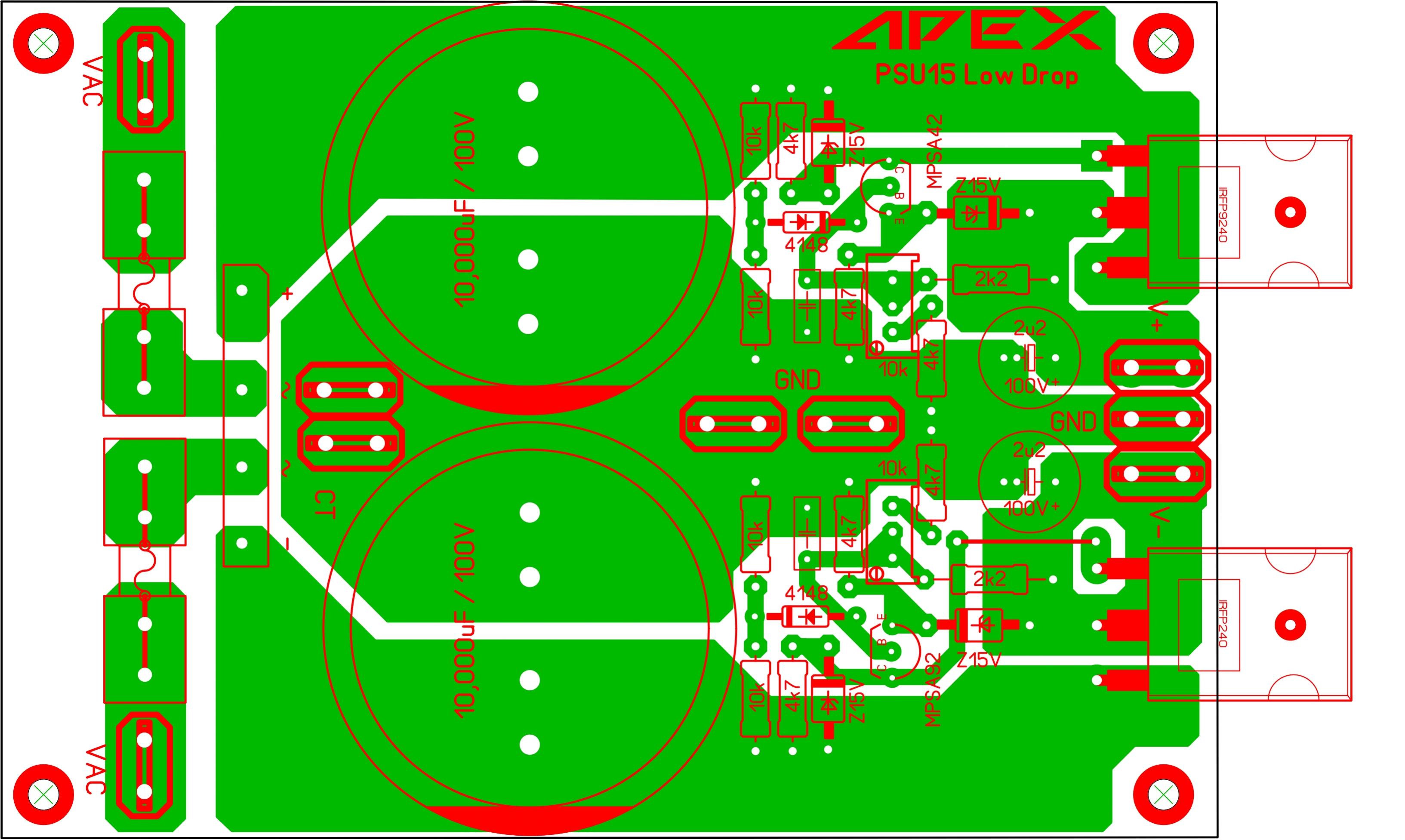

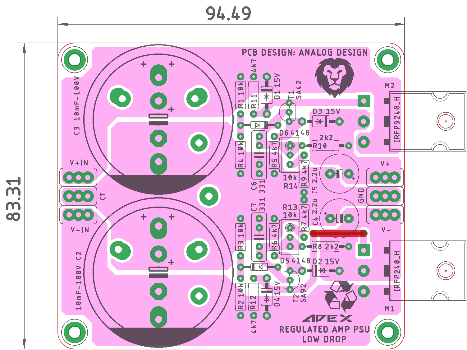

Transformer must be 2x55V AC and there is no bridge rectifier on the pcb... post picture with complete wirenig.

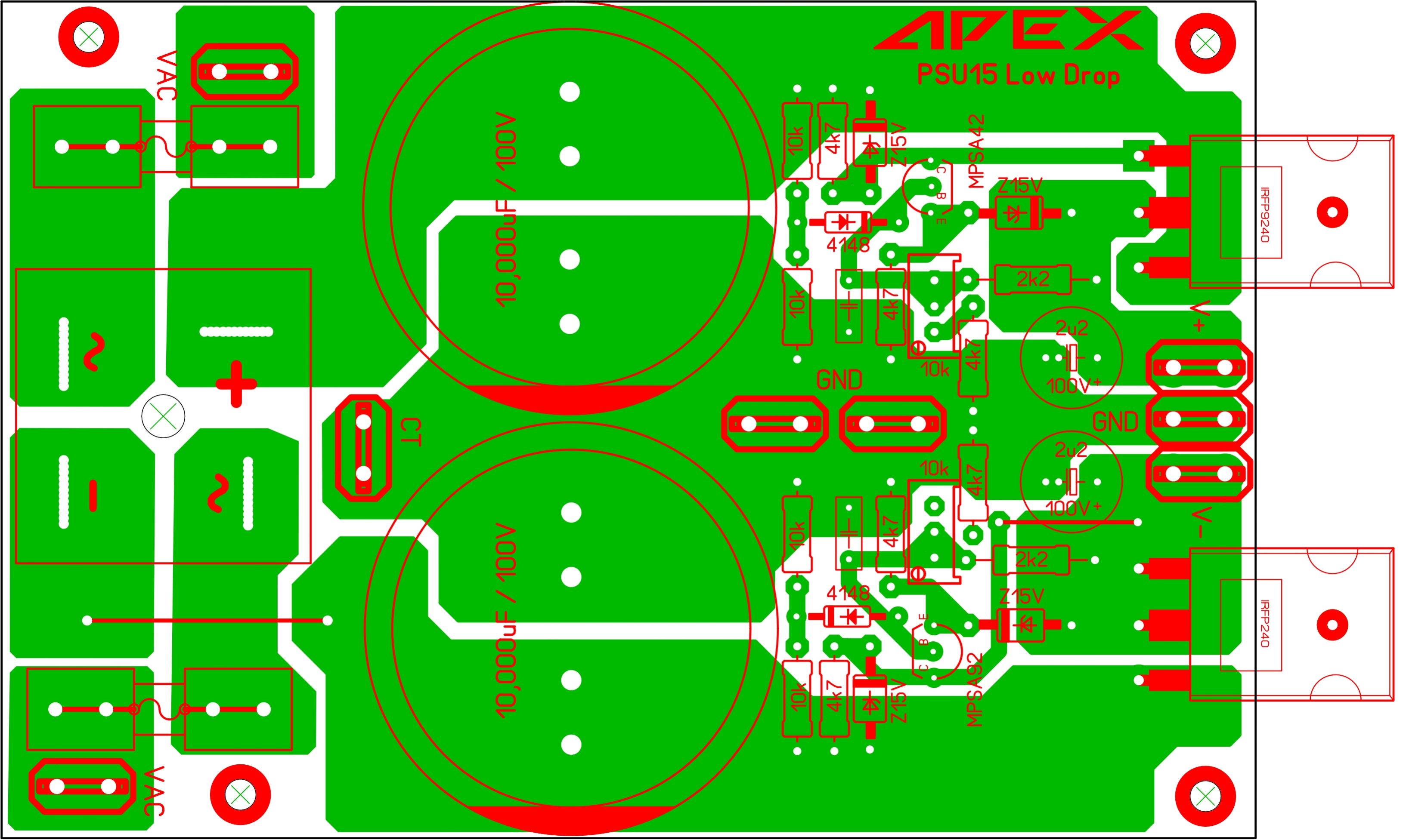

I modified Prasi's layout to add a bridge and fuses. Please check for accuracy.
Also trimmer and 4k7 are unconnected.
These should be better.

GERBERS and SCH for the CRC PSU. it can be used with either center tapped transformer or dual secondary transformer.
