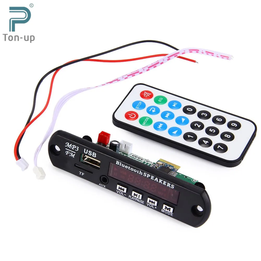

i have used the same wiring but the problem is with mp3 module when it is driven with 5v regulator it gives noise even with filter. i tried to use 5v bulk converter but still the same issue. i have atteched the image of mp3 module and bulk converter i used.
https://ae01.alicdn.com/kf/HTB1nxbU...-Decoder-Board-Panel-Audio-Module-Support.jpg
https://www.elprocus.com/wp-content/uploads/Buck-Converter.jpg
Show me an image with the amplifier inside? What PCB amplifier did you use?

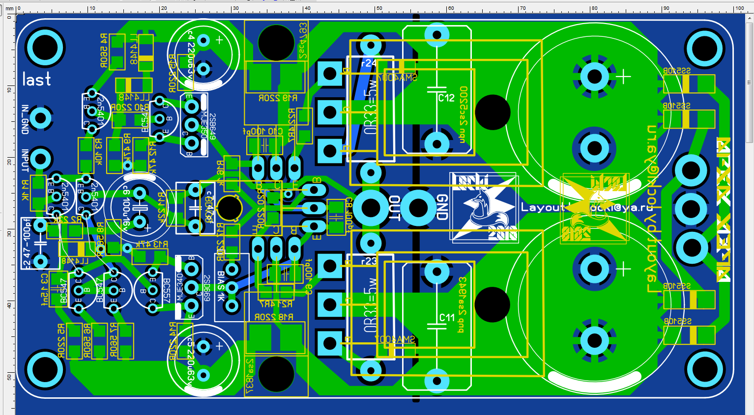

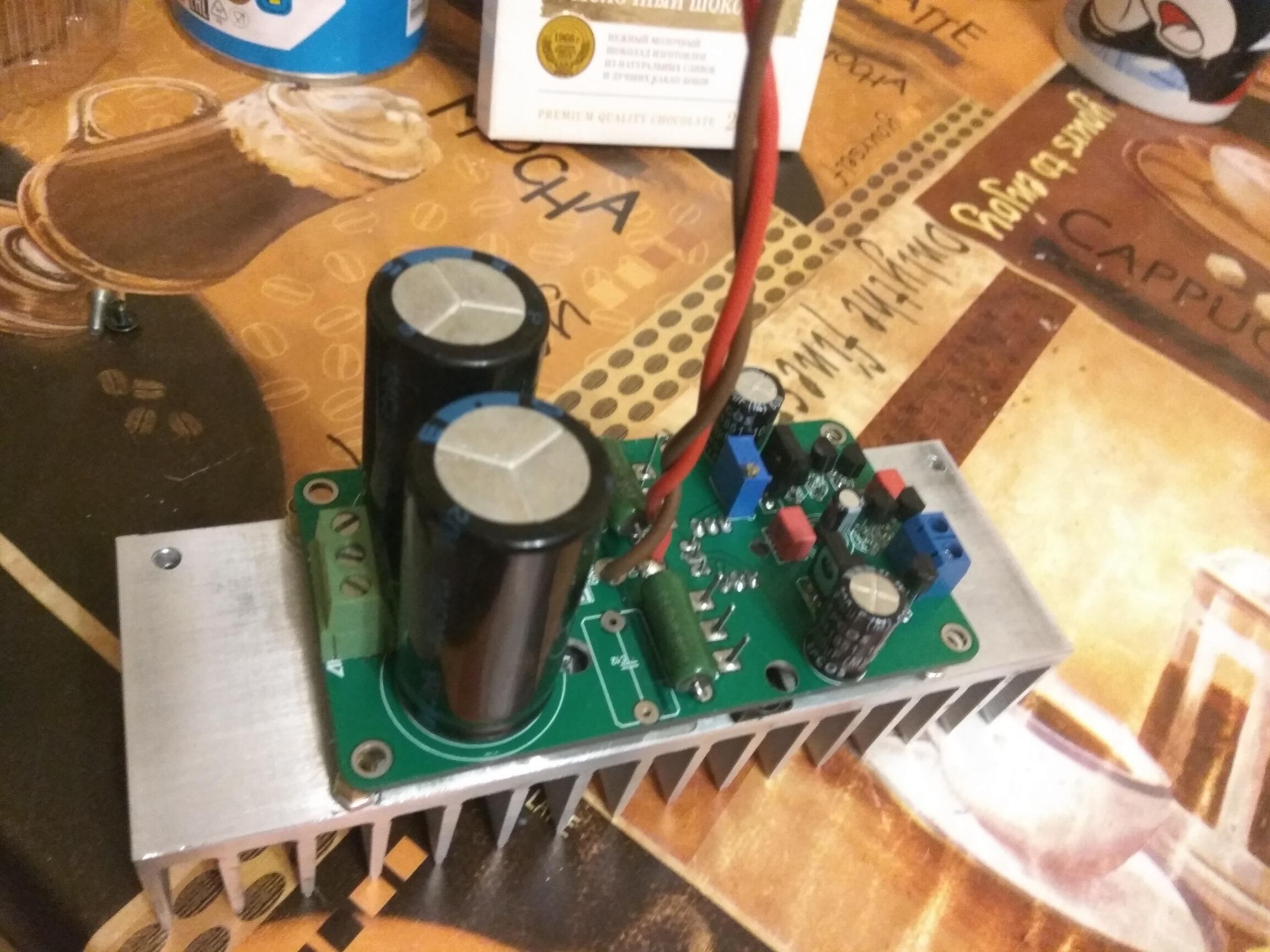

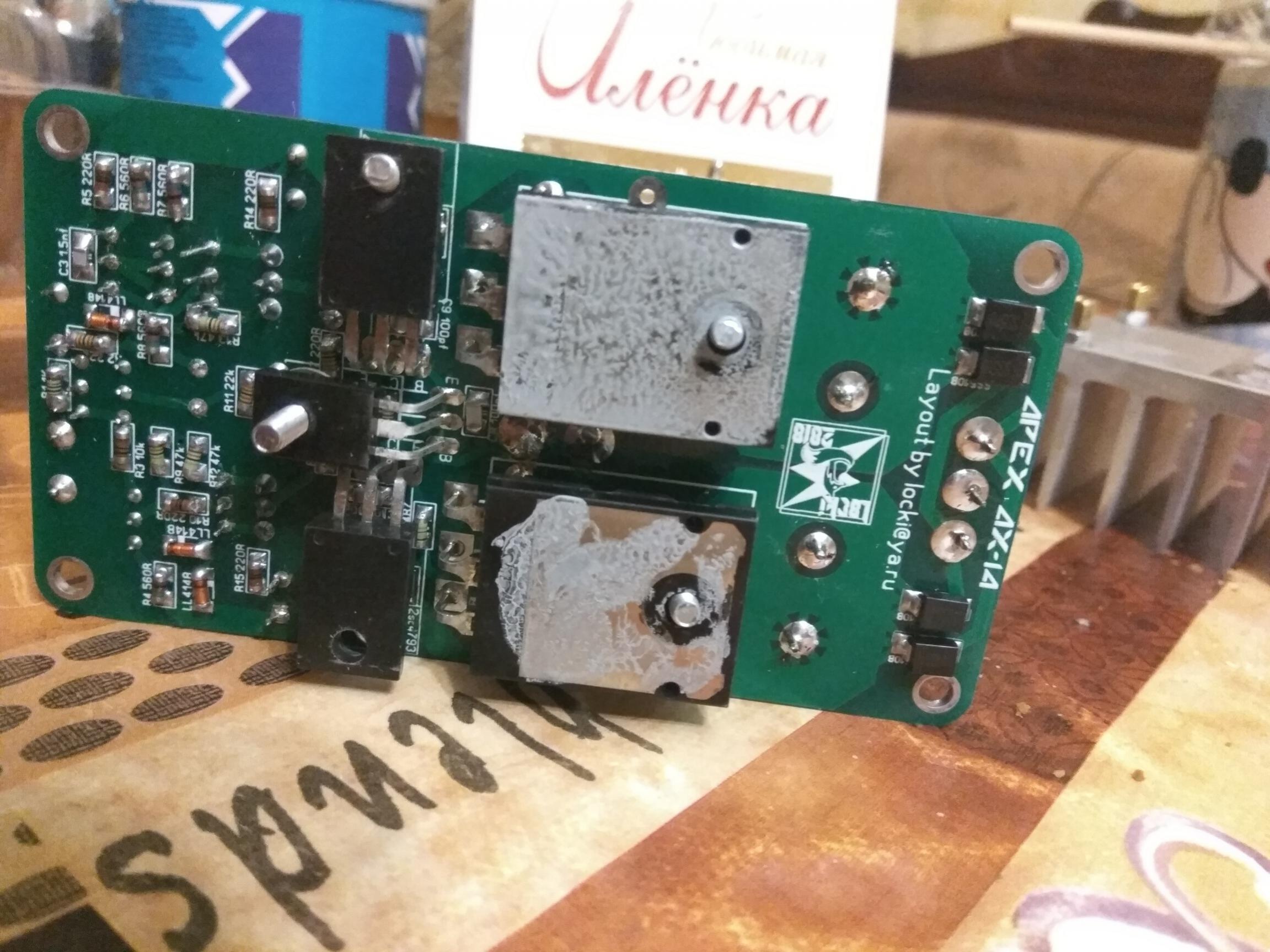

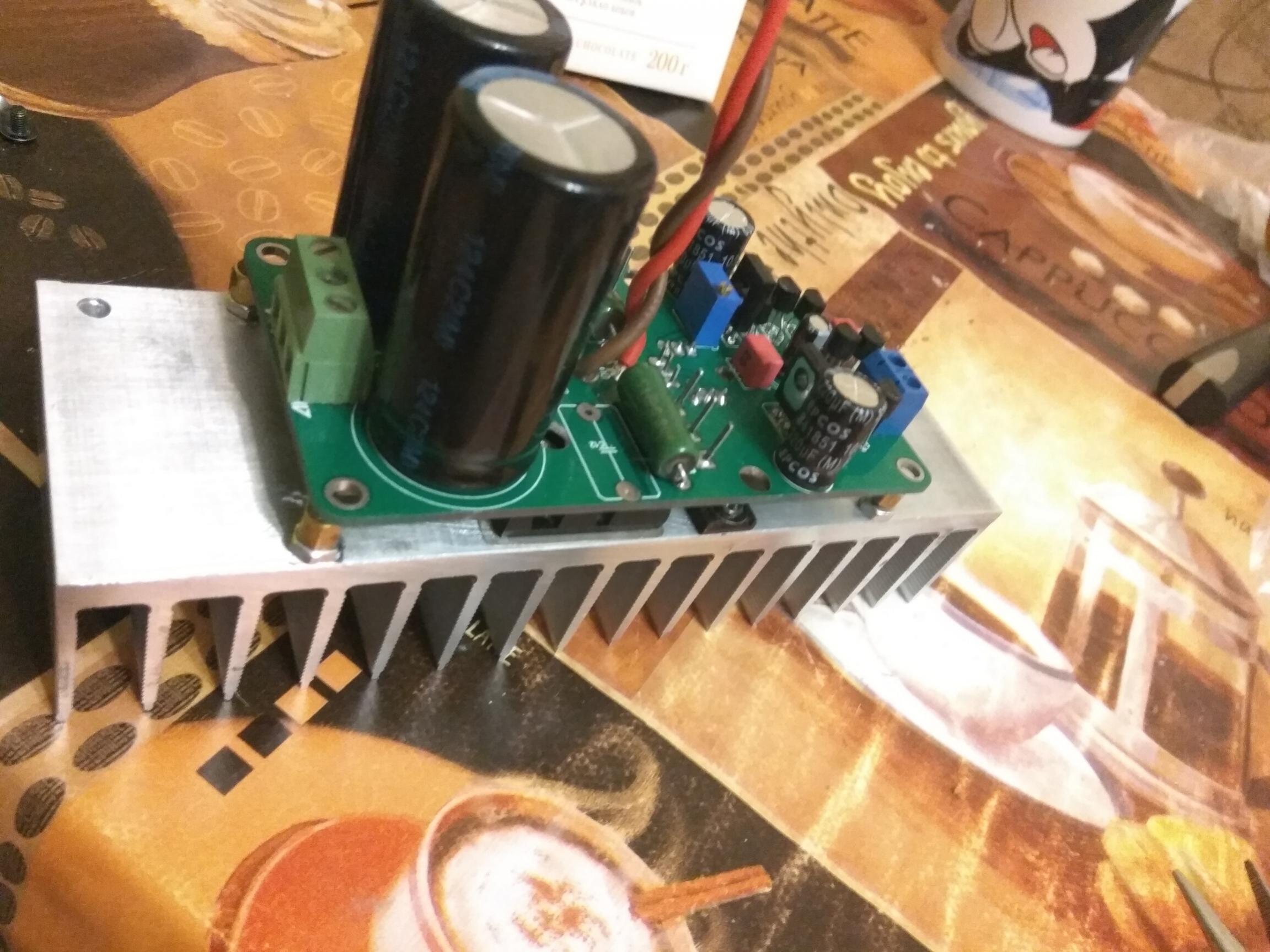

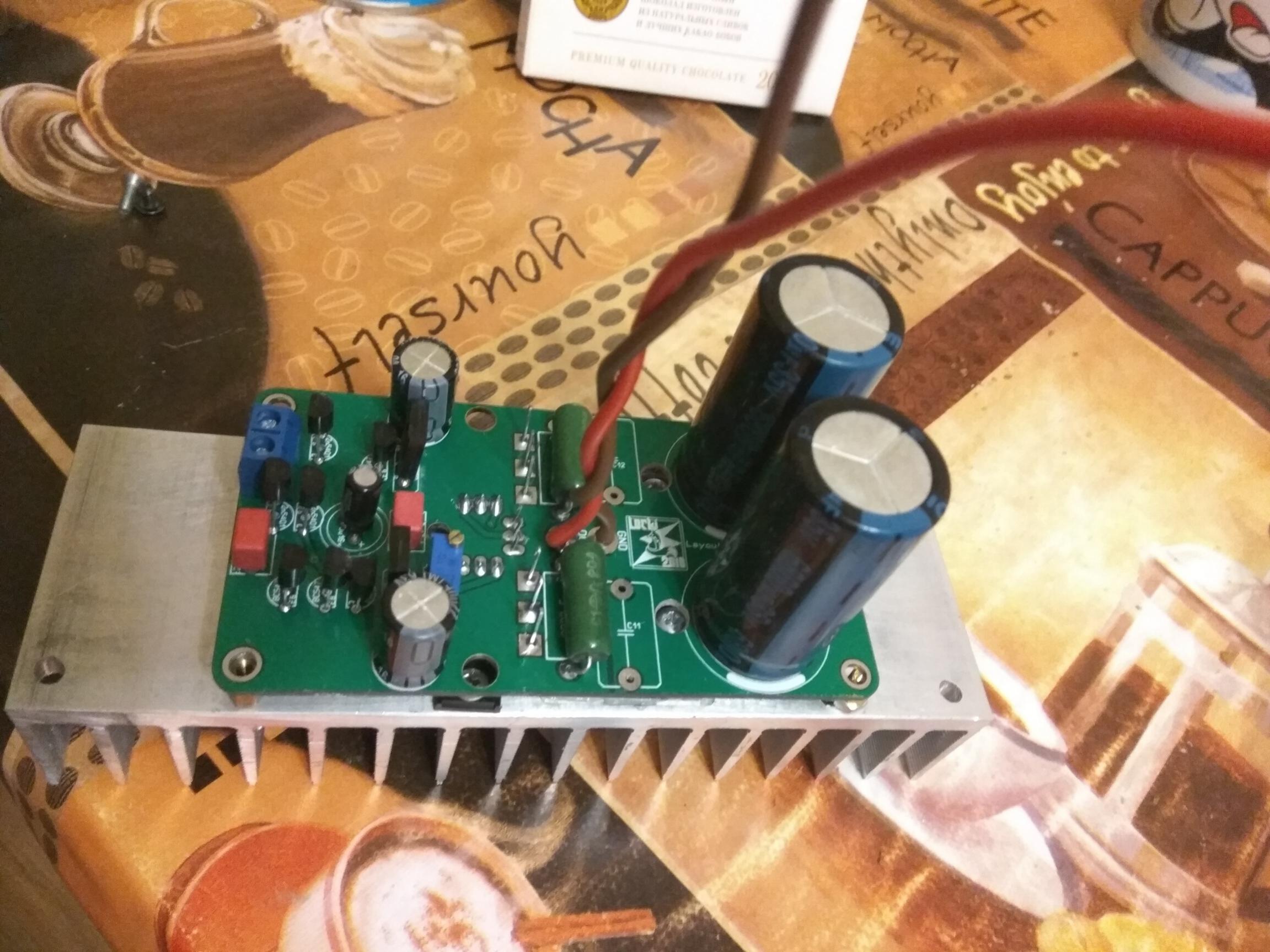

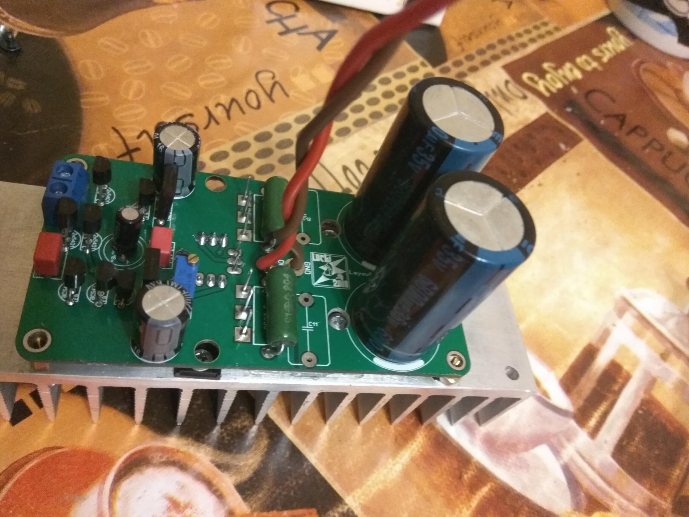

It all started when I decided to make my own, correct circuit Board instead of those that are in this topic. (printed circuit Board did 2nd time in my life-1st was TDA7294). And made a few mistakes:
1. transistors bc557 / bc547 in the Datasheet view from below, drew them upside down. It's easy to fix just by turning them.
2. So as not found mje340 / 350 decided to put their replacement 2SB649 and 2SD669, but mixed up pnp &npn. - )))
Now that everything is fixed, it still does not work. Maybe because something got burned (the smell was not) when started with an inverted transistors, or somewhere a faulty product. As luck would have broken multimeter, waiting for a new one. We'll have to solder and recheck....
This is my story-))) I Hope to achieve operation of the amplifier. Well, a few pictures
