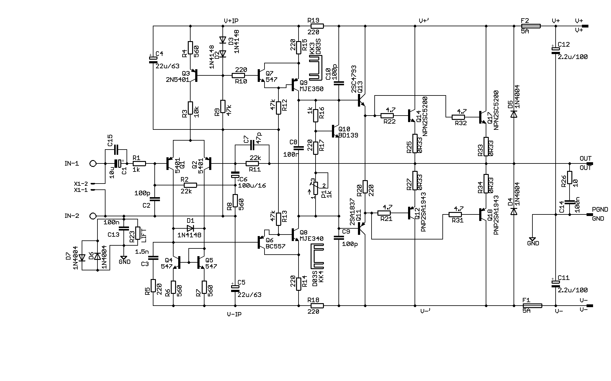

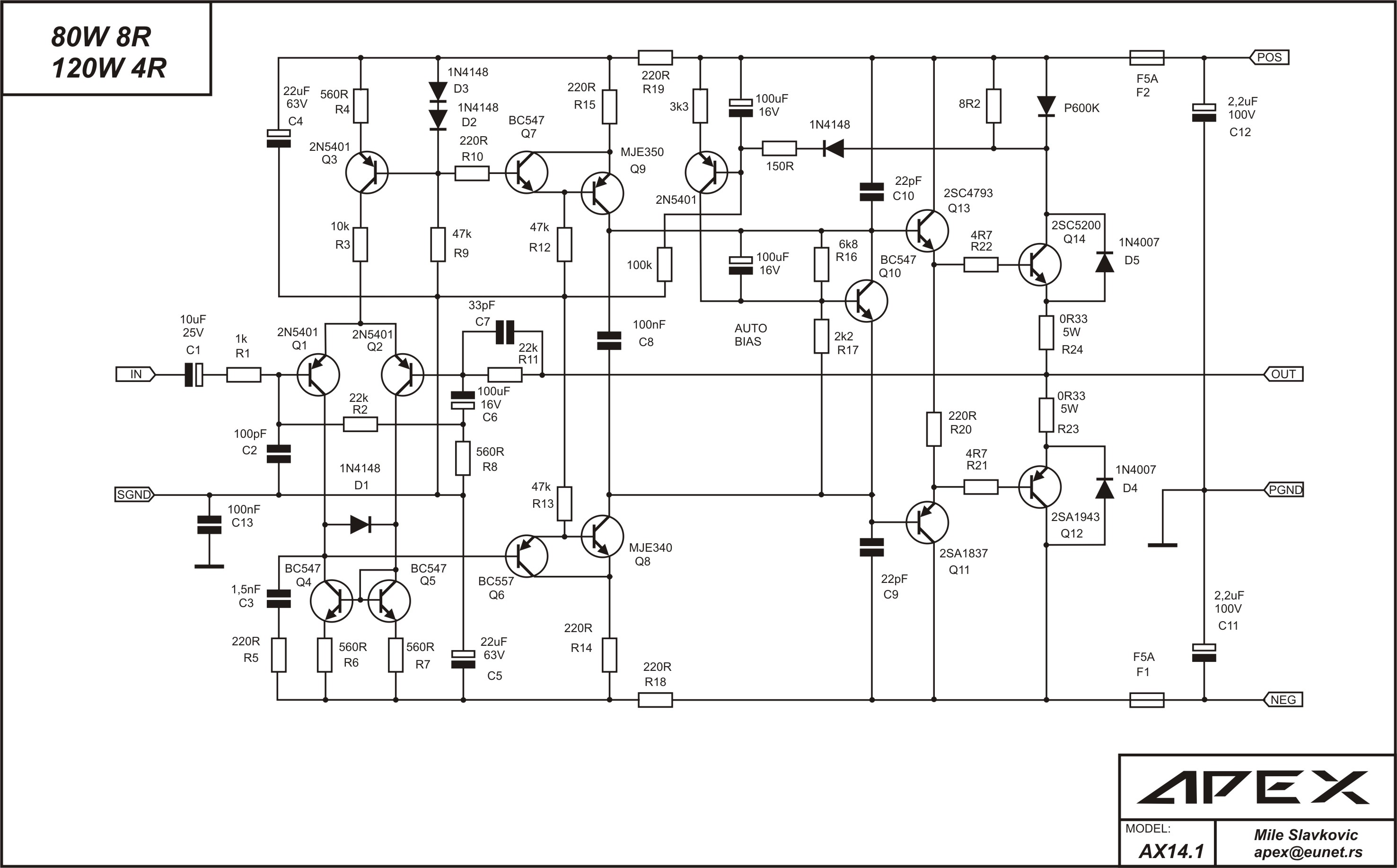

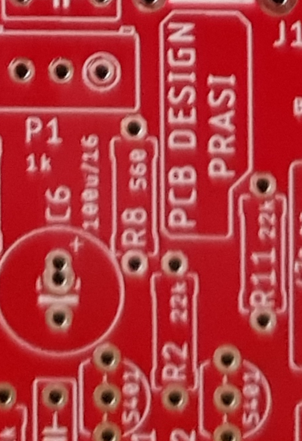

hi apex sir and everyone. in post 1 sch of ax 14 r2 and r8 right or in post 253 layout is right because in layout 22k resistance in place of 560r and 560r in place of 22k .which is right please tell me.
Read post #10 where someone points out that the values have been deliberately swapped.
R2 is 22k, R8 560.

I have also made a simple AX-14 board. Could you please look at it, to see if there are any errors, or things I could do better?
EDIT: The drill files created are wrong, all drill holes are the same.. so this is 100% wrong. I will correct it in V02.
Attention!!! This board is not working! I do not take responsabilities if you make them and it doesn't work!
If I'm finished, I can post final gerbers of course :)

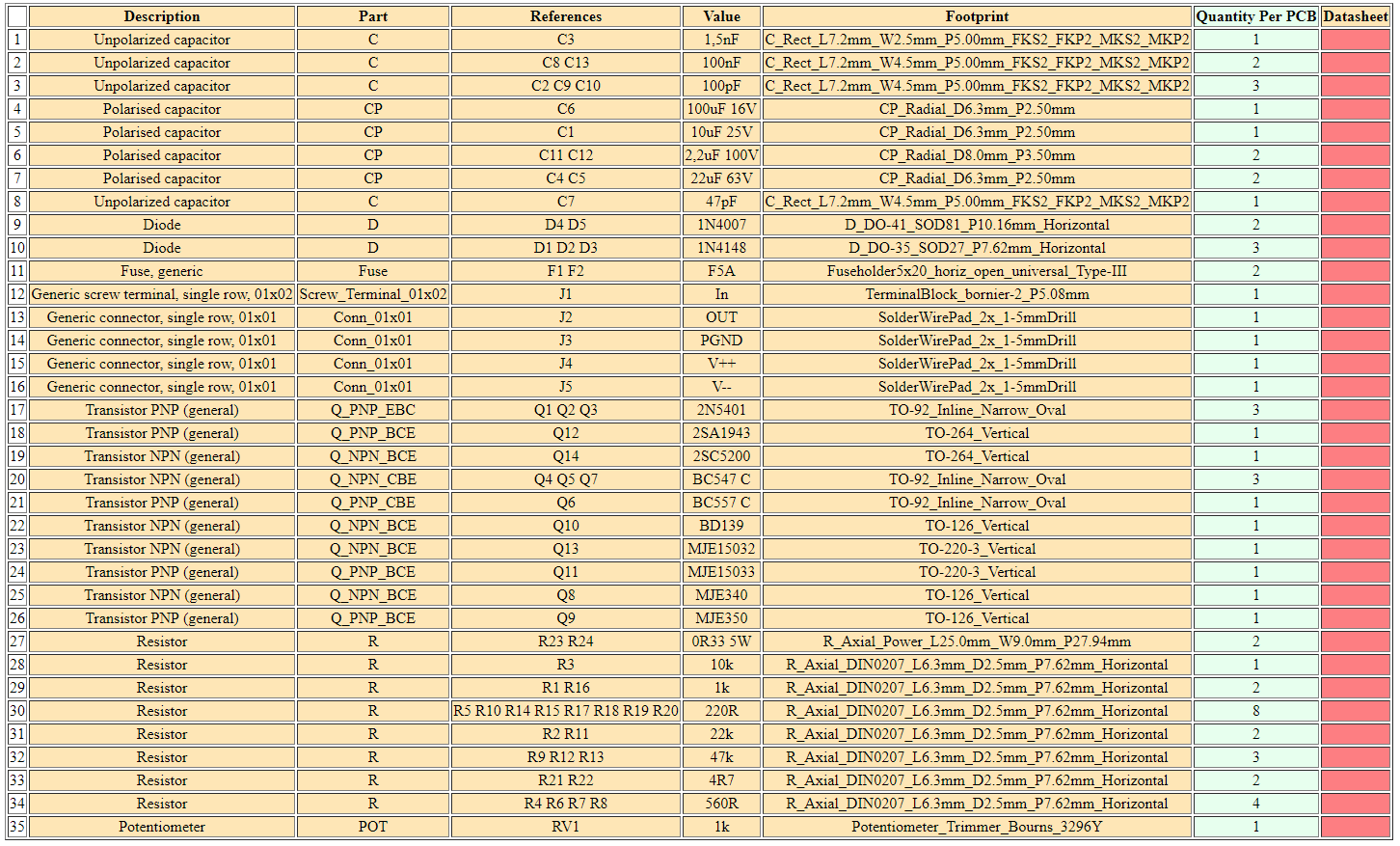

I also attached the BOM from which my build can be done.
