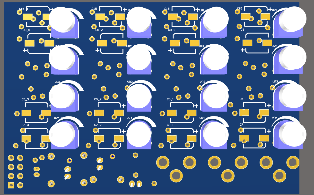

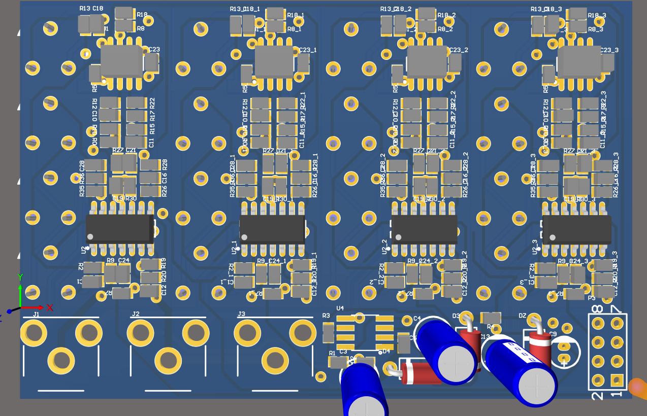

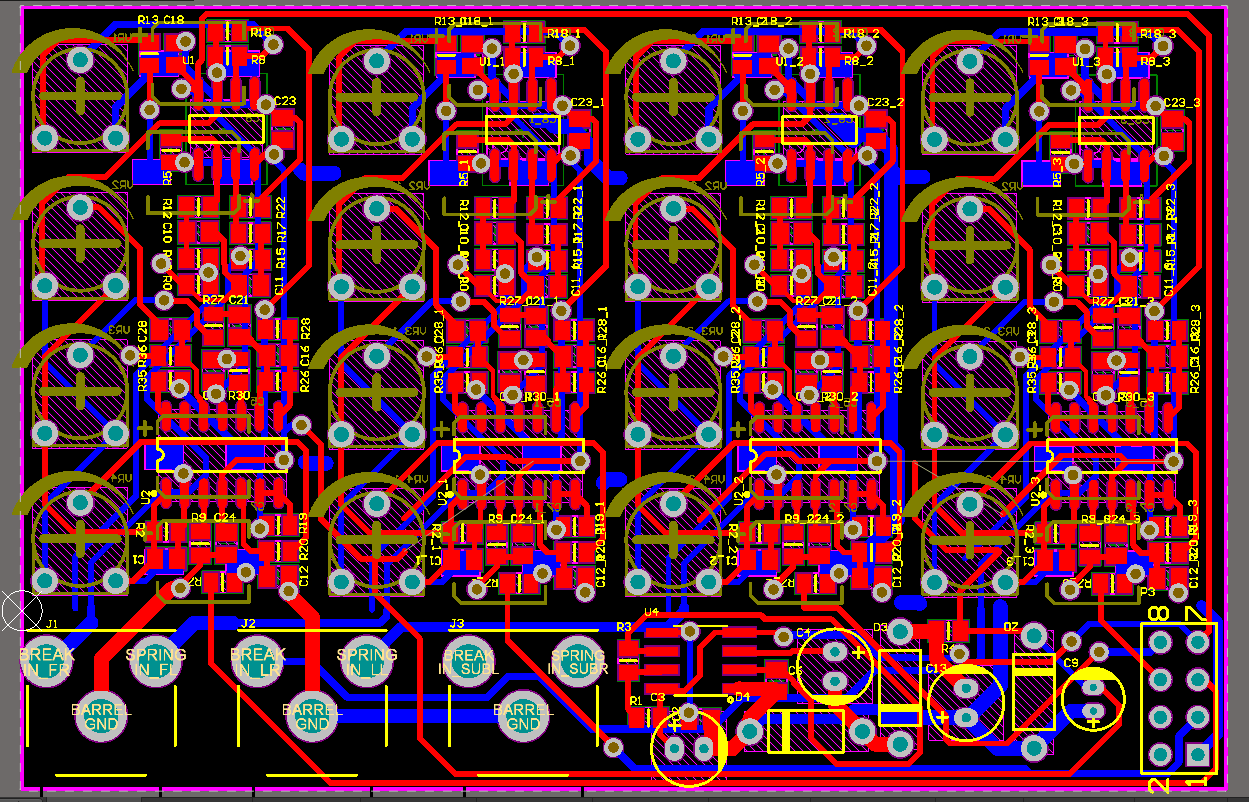

Hi
i tried design smd type of ML3
but it is not worked.
any one have a correct schematic for it?

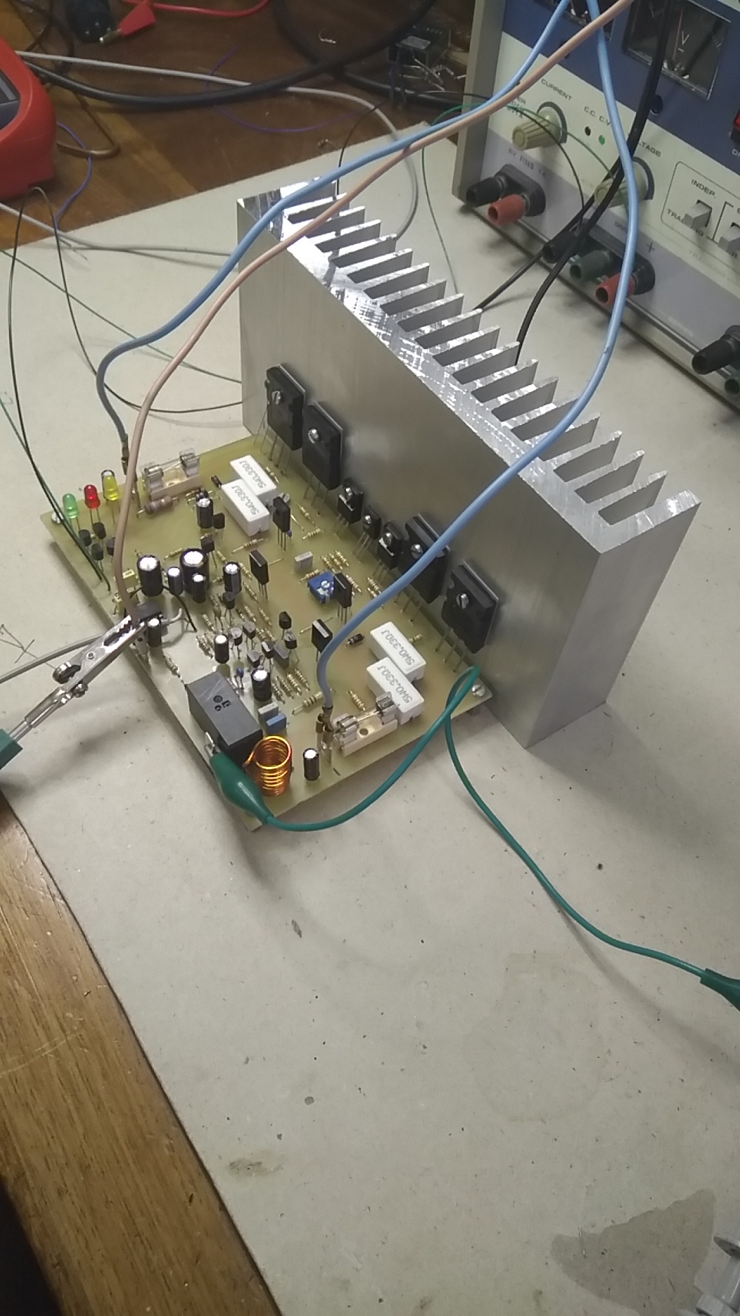

Good Day....
Thanks to Sir Apex for the AX20 circuit and a Big thanks to Kandimba for the PCB Layout....

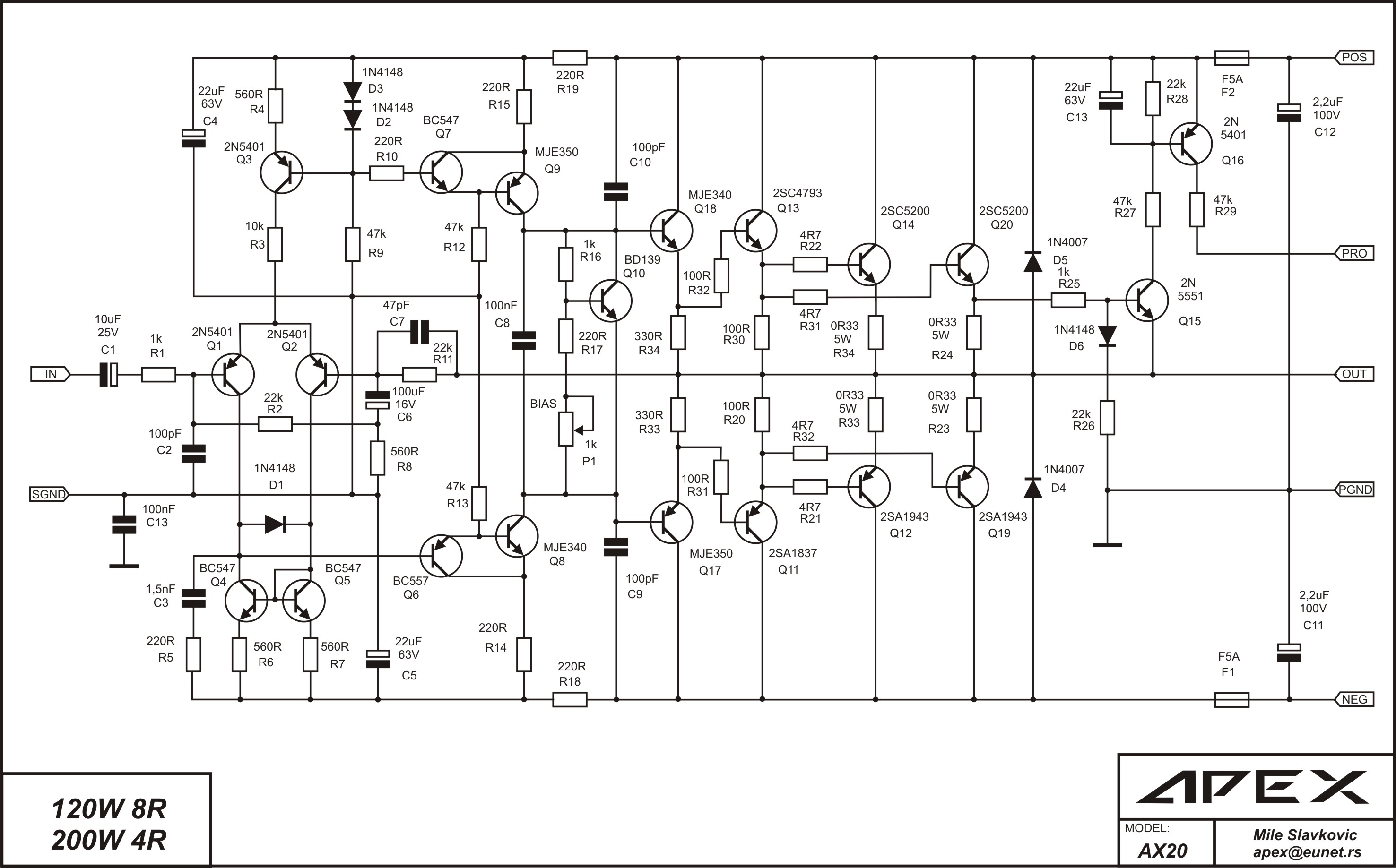

Completed AX20P....see pics attached....
Thanks Sir Apex and Kandimba.....
One question....how much bias current for this circuit???? How do I adjust the bias current??? Here is what I am doing....
I measure with DVM across 0.33R resistor. I use ohms law...V=IR...6.6mV=20mA x 0.33....Is this correct????
macd.....:D:D:D

Yip, math is correct !:)
