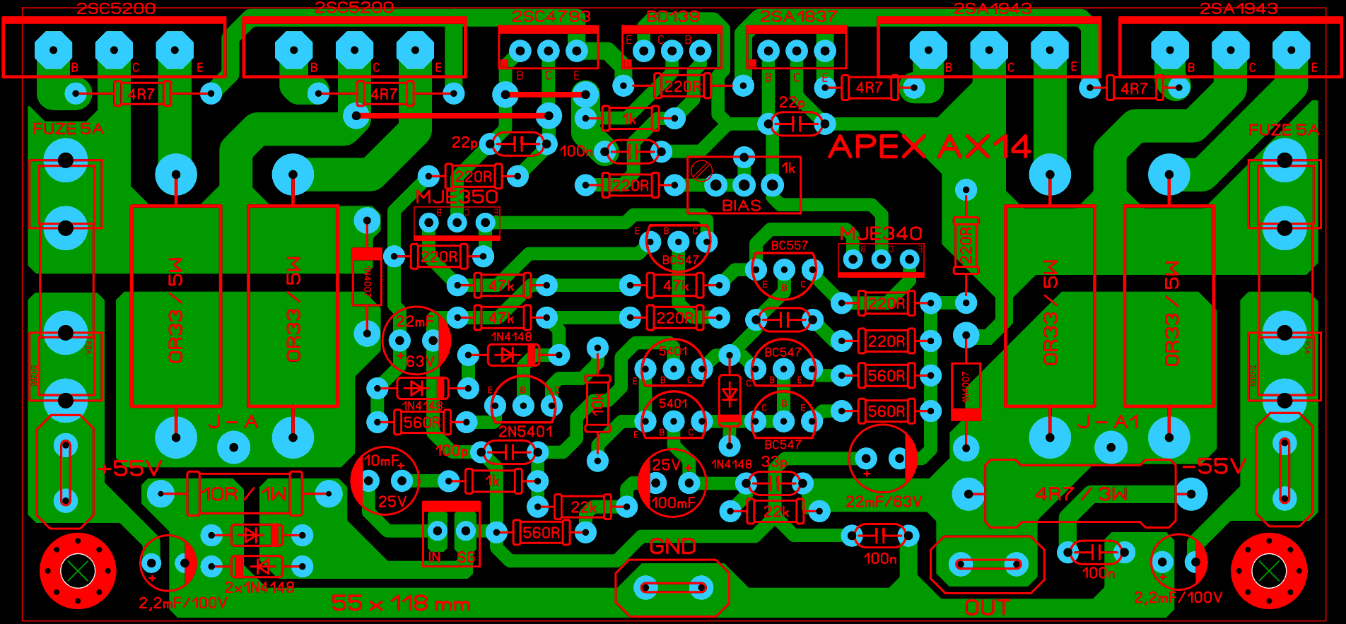

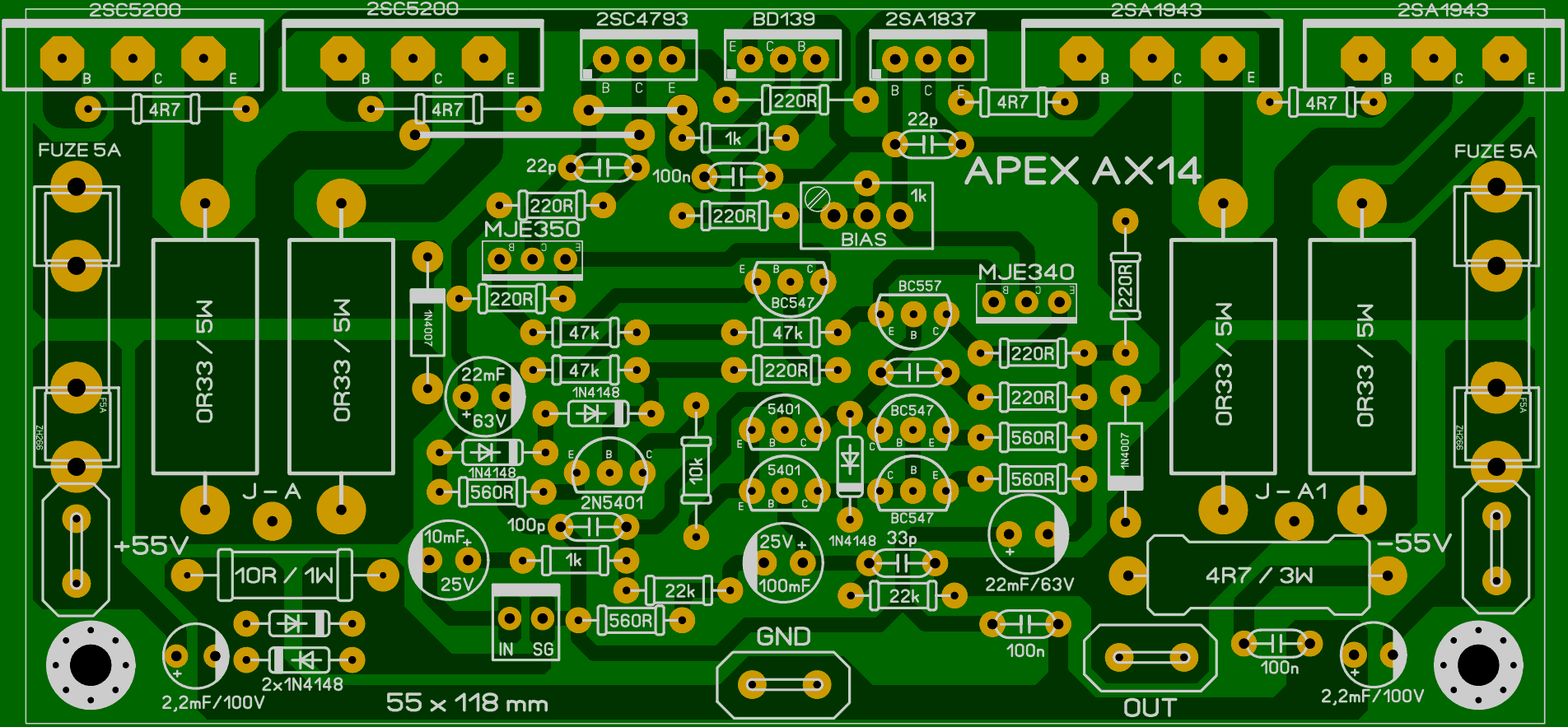

Another FH9 freshly packed and ready to serve. The sound is surprisingly good! Many thanks to Sonal Kunal for the pcb layout. The VAS transistors are KSC2690 KSA1220 because it's easier to mount fully isolated TO126. Bias is only 30mA (yes I know that it should be 100-150mA).

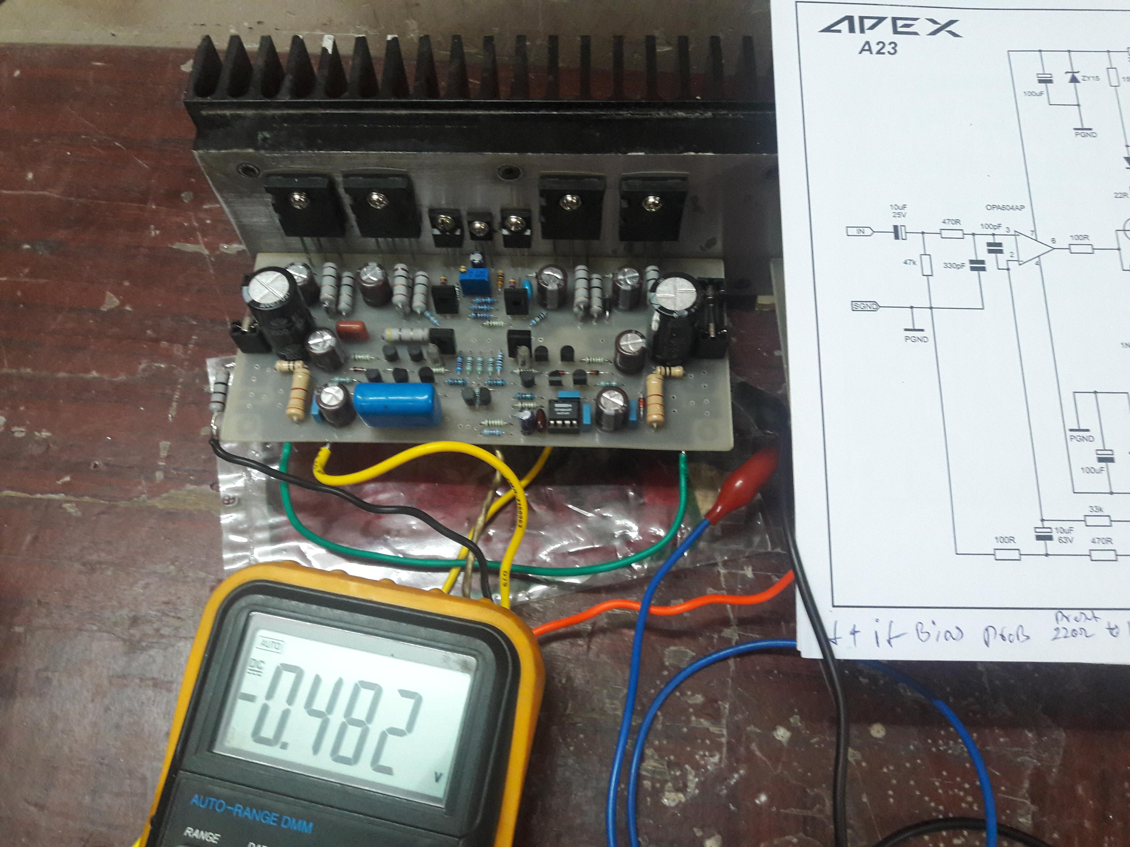

Hi Mr.Miles,
Just finished A23, Testing with power supply of +/- 45v ,Had bias problem and sorted out by increasing 220 ohms preset to 1k and 680 ohms to 820 ohms,,
Now able to set bias properly,,
Now I have DC offset about -0.482 V..
can you please help here....
Regards
Arasuk

Is the input gnd connected to power supply star gnd?Hi Mr.Miles,

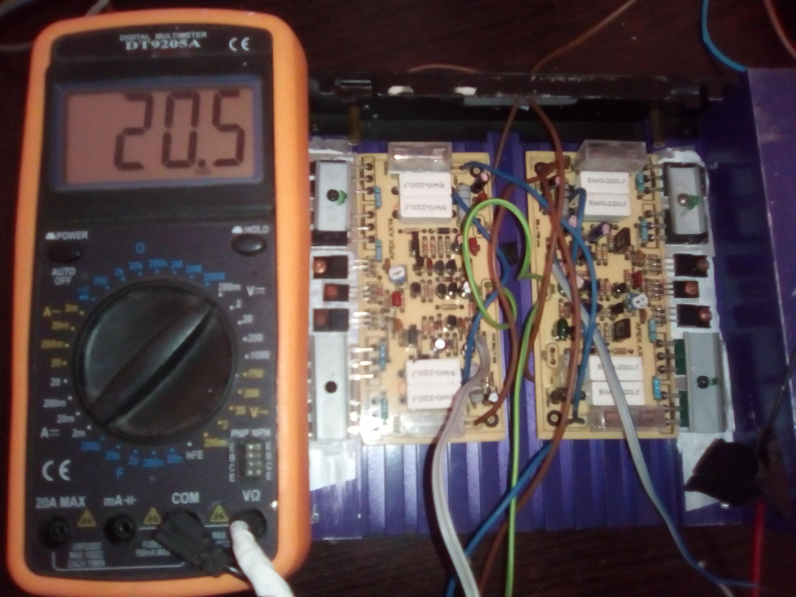

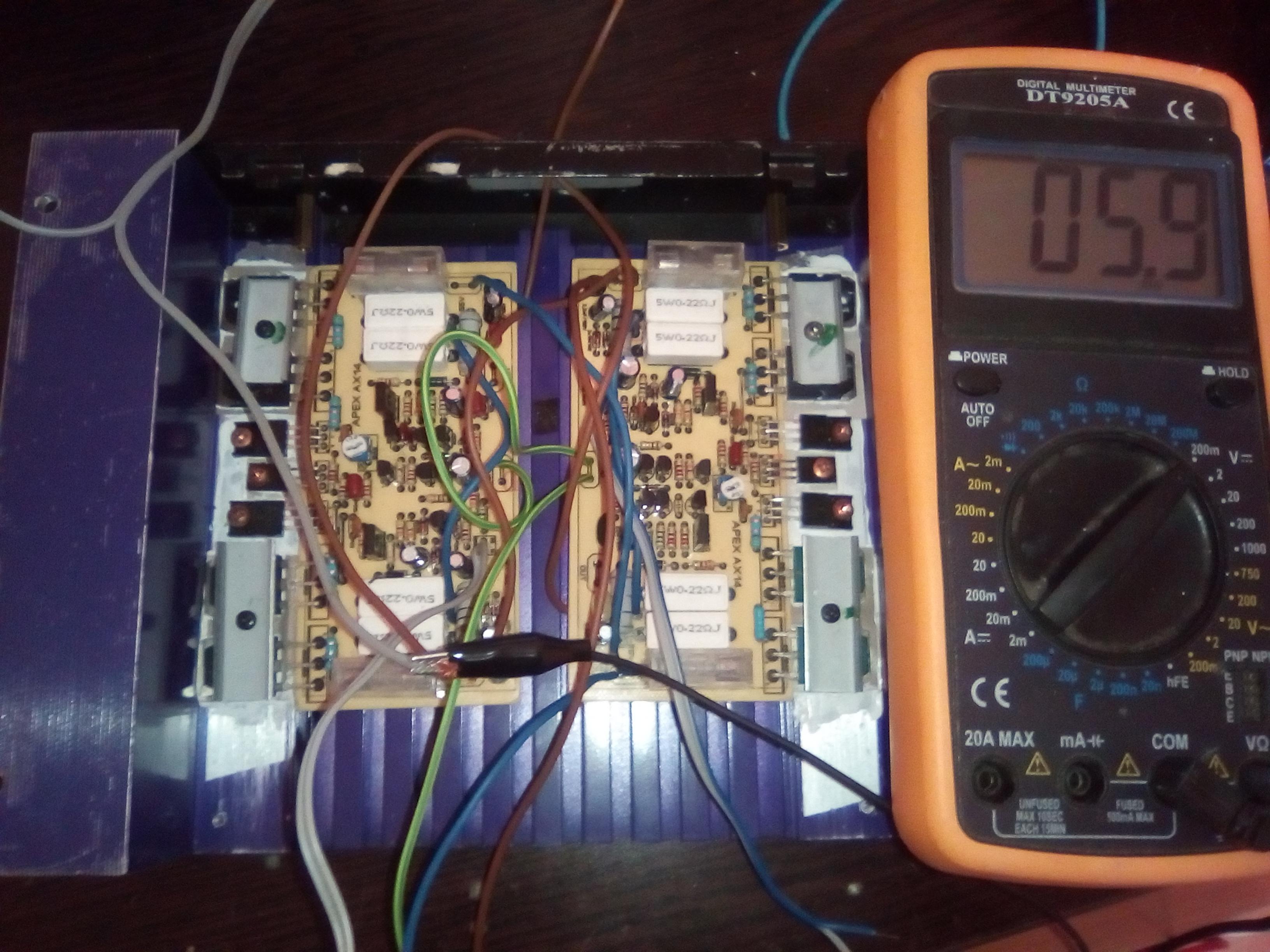

Hy Mr. Mile i have a problem with my ax14, for one module the dc offset is big
21mA and for the another is ok only 7mA. What is the cause? Can help my? I want to use this for car audio. Thanks
It's normal that you have different DC offset and those values are OK.
I tested the modules in the car and the sound produced by the offset is very bad with my canton RS 6 speakers. For home it's ok but for car bad!
