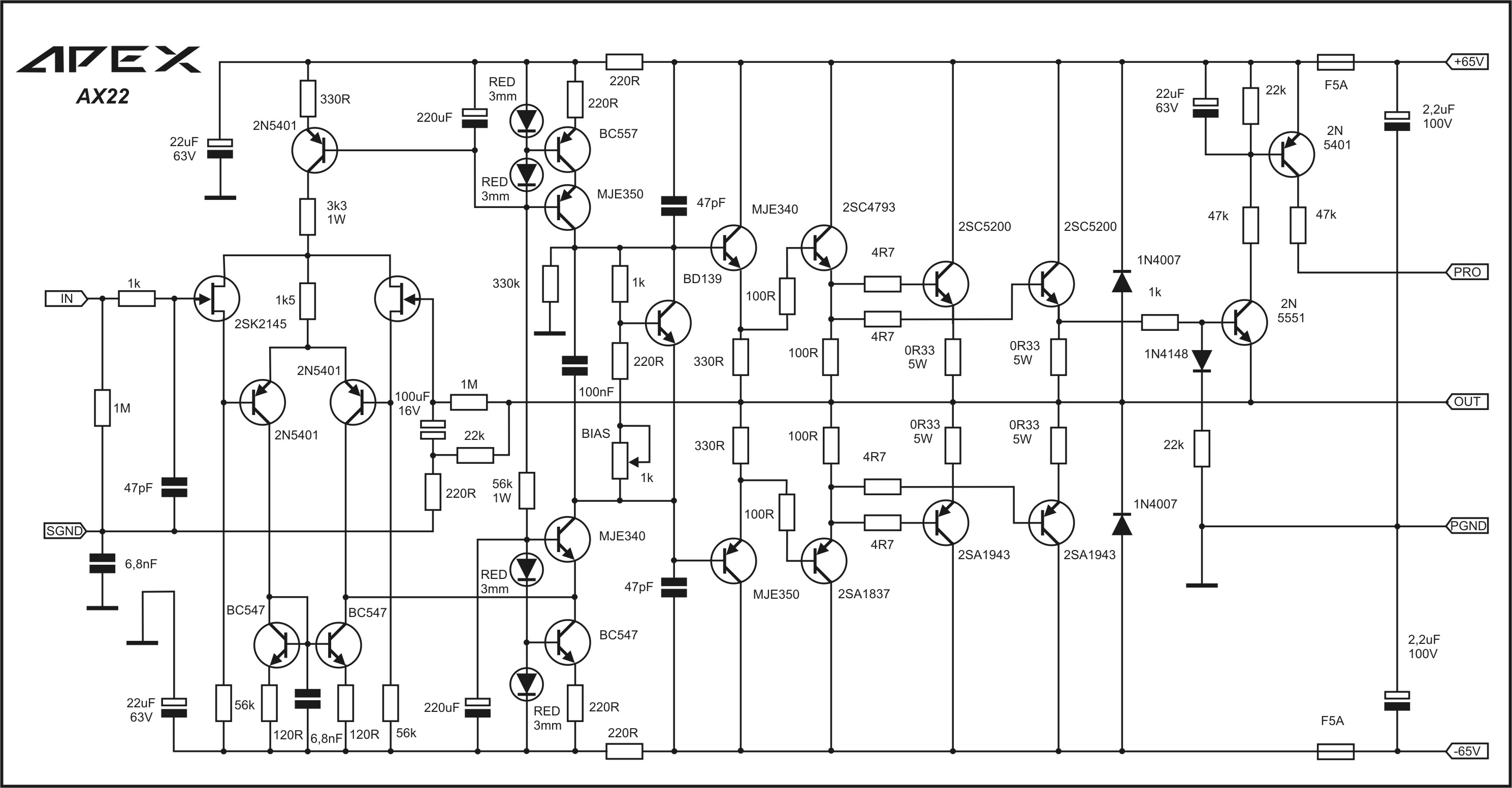

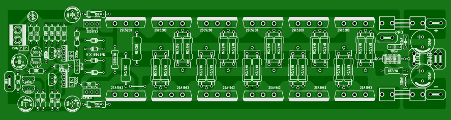

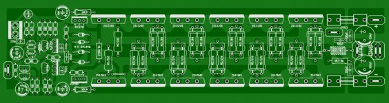

This is my simulation of FH12. Not tested.
PCB layout. Not tested.
Would be interested to build that!
Thank you for posting it.

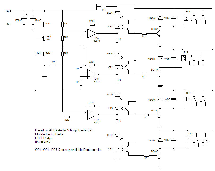

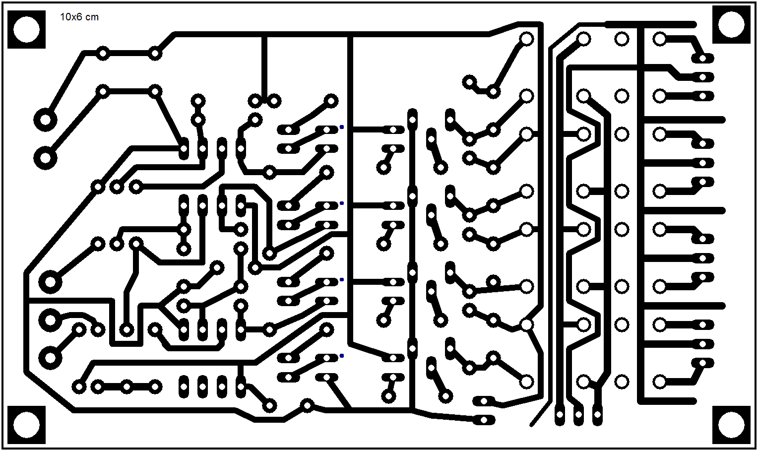

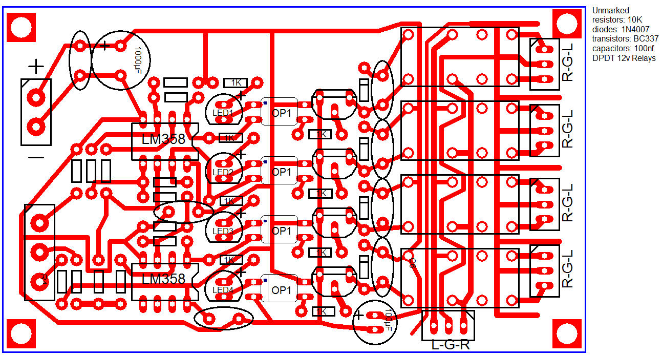

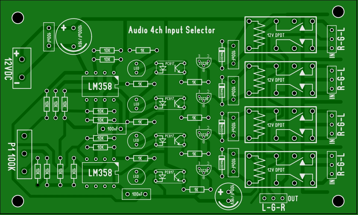

Selector PCB
I make copy PCB (SprintLayout 6) and added missing track to relay.
Thank you, Zinyx. Could you please post Gerbers as well?
thanks for sharing . good work
