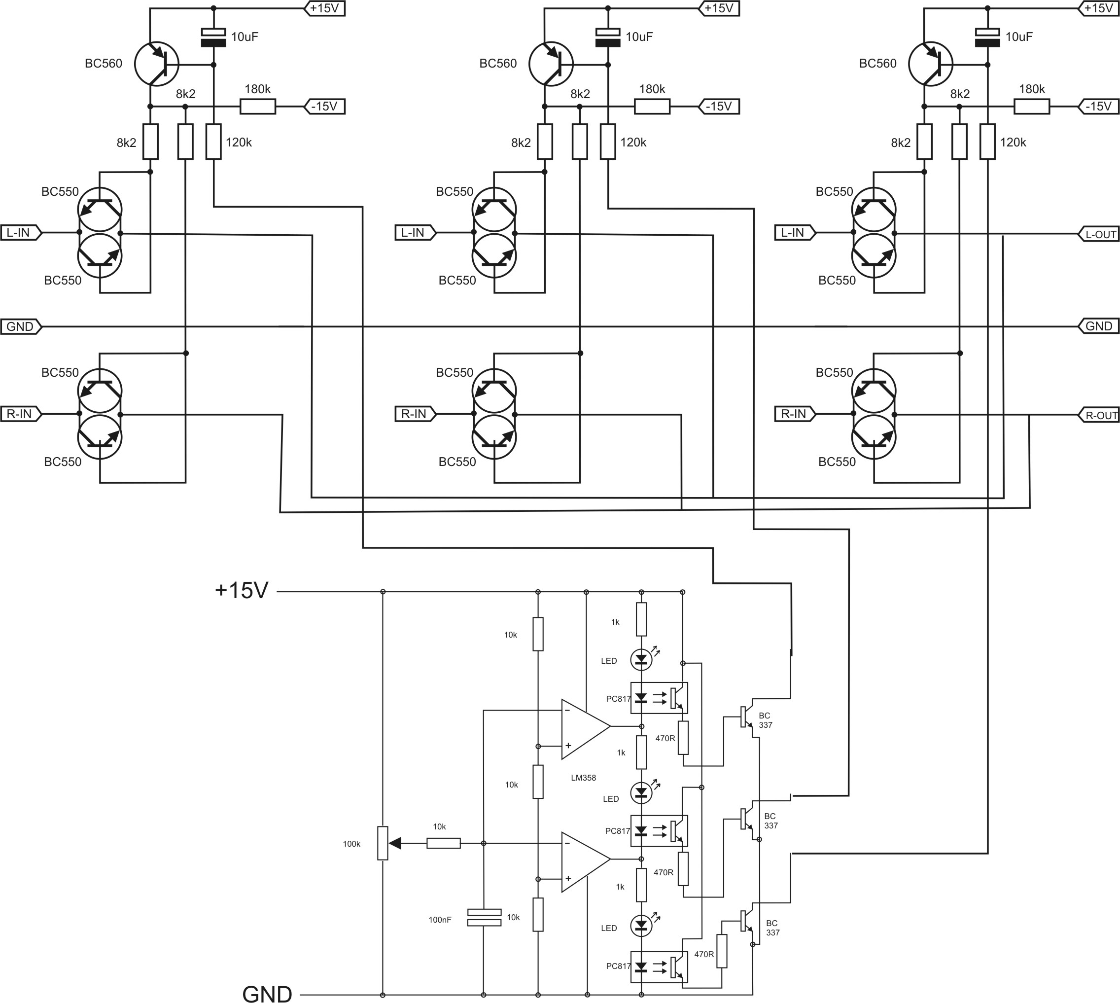

Sorry for not getting it - but where does the pot selector drive circuit connect to the above analog switch circuit?
Thanks.
You must use array of 3 audio switch and connect 120k to BC337 colector instead to gnd switch. Outputs from 3 audio switch connect in parallel (3 left and 3 right).

Audio switch with transistors.
hi
do you test this one swich?
is this worked perfect without bad quality in output sound?
hi
I am thinking of building this on veroboard to test out. BC550/560's are some of the finest small signal BJT's used in many state of the art low-noise, low-distortion pre-amps so I suspect they do not degrade the signal when used correctly.
I wonder if a LED and 4.7k in series resistor can be used to give visual indication of which switch is active?
