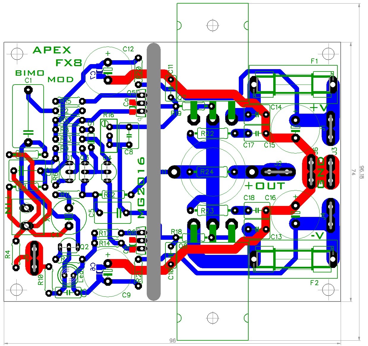

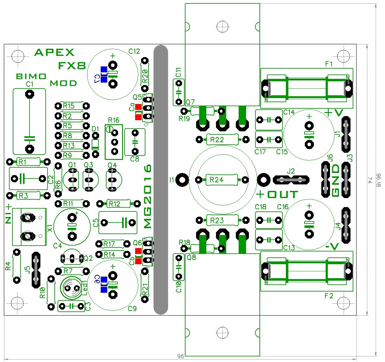

Boring days to home...perfect to play with routing soft.....intrepretation of FX8 bimo mod. OUTPUT devices are ALLFET ALF16N(P)16 TO264 devices (double die)

nice job Marc, one minor thing, R19, R18 pads are right over the mosfet pins. if one leaves the cut pins too long, it might short with mosfet pin. although chances of this happening is very minimal.Boring days to home...perfect to play with routing soft.....intrepretation of FX8 bimo mod. OUTPUT devices are ALLFET ALF16N(P)16 TO264 devices (double die)

Yes prasi, i agree, just to pay attention when building...

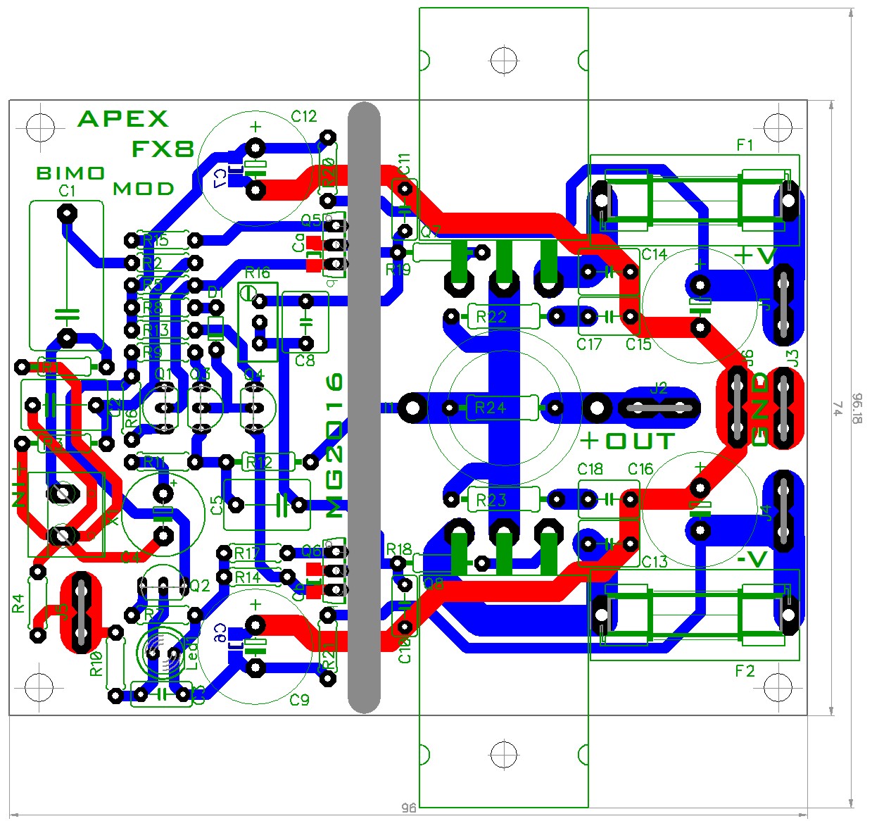

Little change according your advice....
Remove balance pot and add jumpers...[/
Give me a pcb TB3 pdf file thanks
I'm attaching iron transfer PDF. If you need photo resist let me know. I added jumpers for the balance pot.

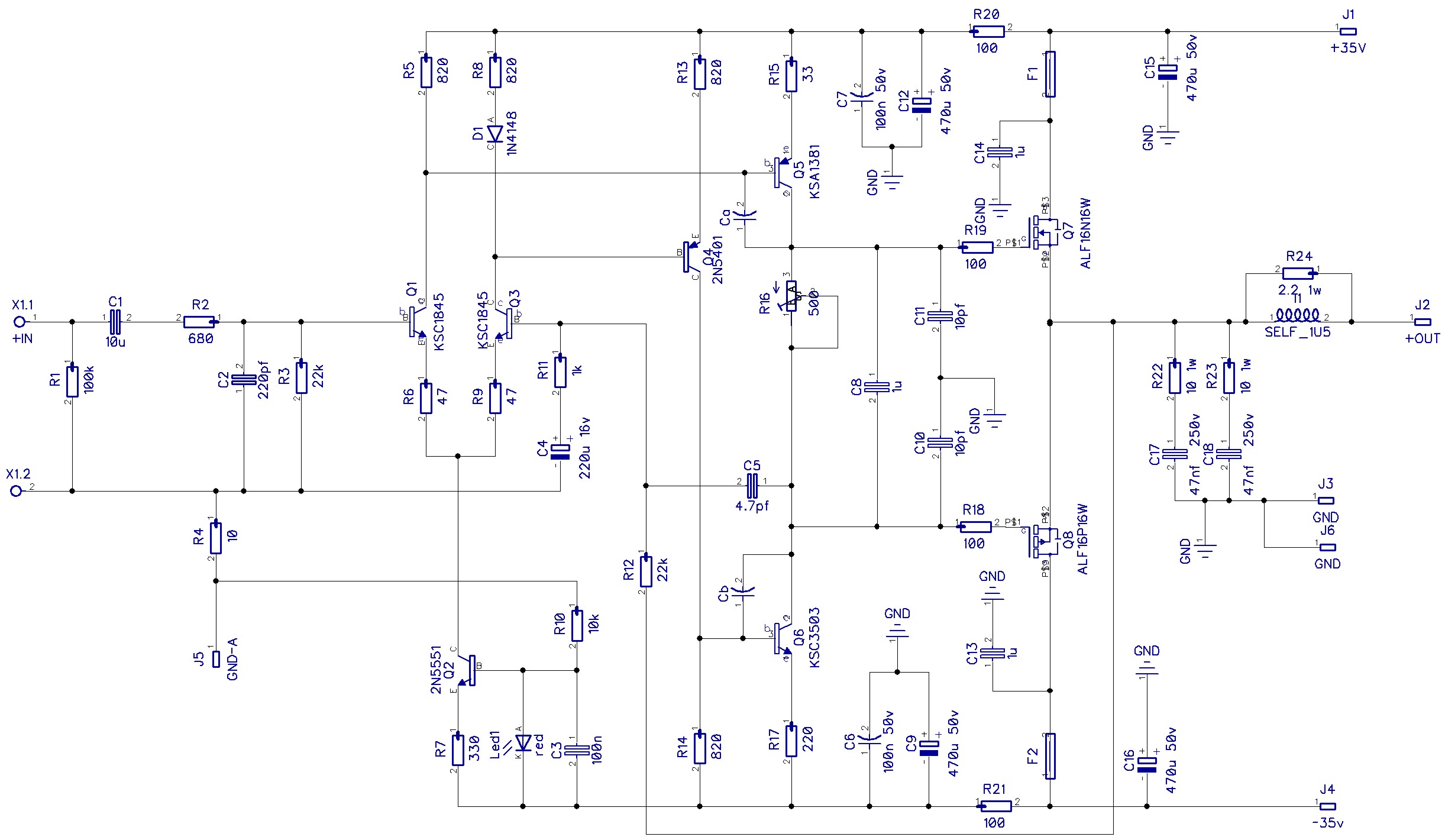

Very nice board. Does double die Allfet allow higher rail voltage and more power output?
More current for sure......Lazy Cat use them in his first one. Holton use them in his HPA-NXV200L R4.1 module :
The NXV200L R4 Advanced module now uses dual die lateral MOSFETs for even more power output and ruggedness
I want to use them instead of 2 single die per rail..

the double die devices are rated as 250WVery nice board. Does double die Allfet allow higher rail voltage and more power output?
That using my standard model gives a maximum output power of 125W
Sum Pmax = 250+250 = 500
Max output power for mosFET stage = 500/4 = 125W
that could be into 16ohms or into 8ohms or into 4ohms or into 2ohms.
You select the Supply rail voltage to give whichever output YOU require.

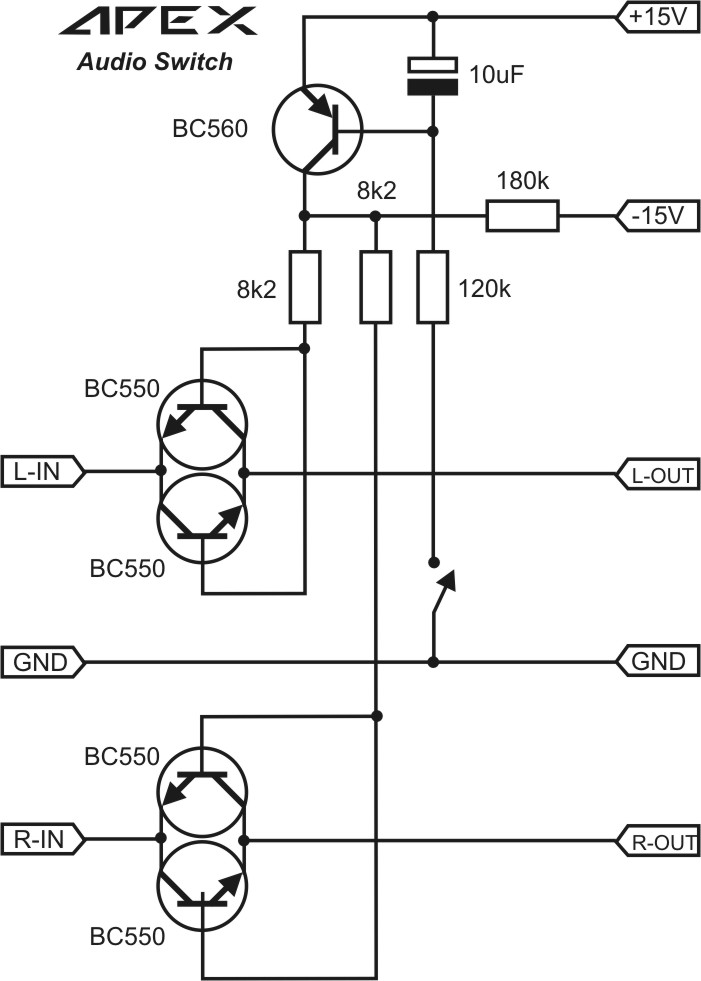

Audio switch with transistors.
Greetings mr.apex sir
Pls share audio switch with 4066 ic crcuit
thank you, disturb you tell me the value of 2 transistors

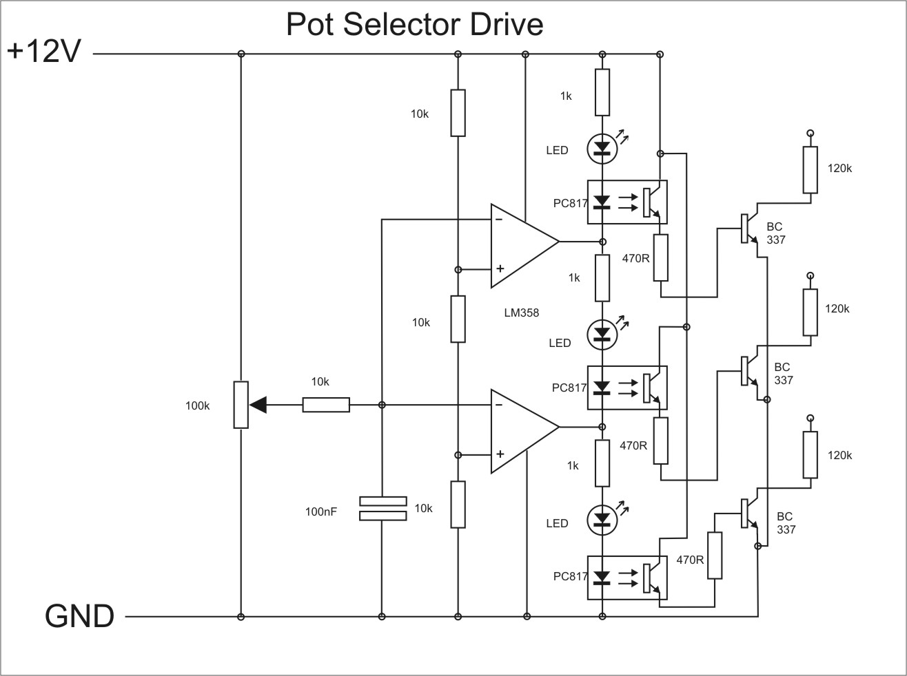

So one could build an array of these for an analog input selector with no hard contacts in signal path? Cool.
Yes connect outputs in parallel and you have audio selector, you can use pot selector to drive this switchers instead relays.

Should R17 be 33 Ohm?
How does a pot drive the input for a paralleled gang?
This is drive circuit... 120k is from audio switch.
