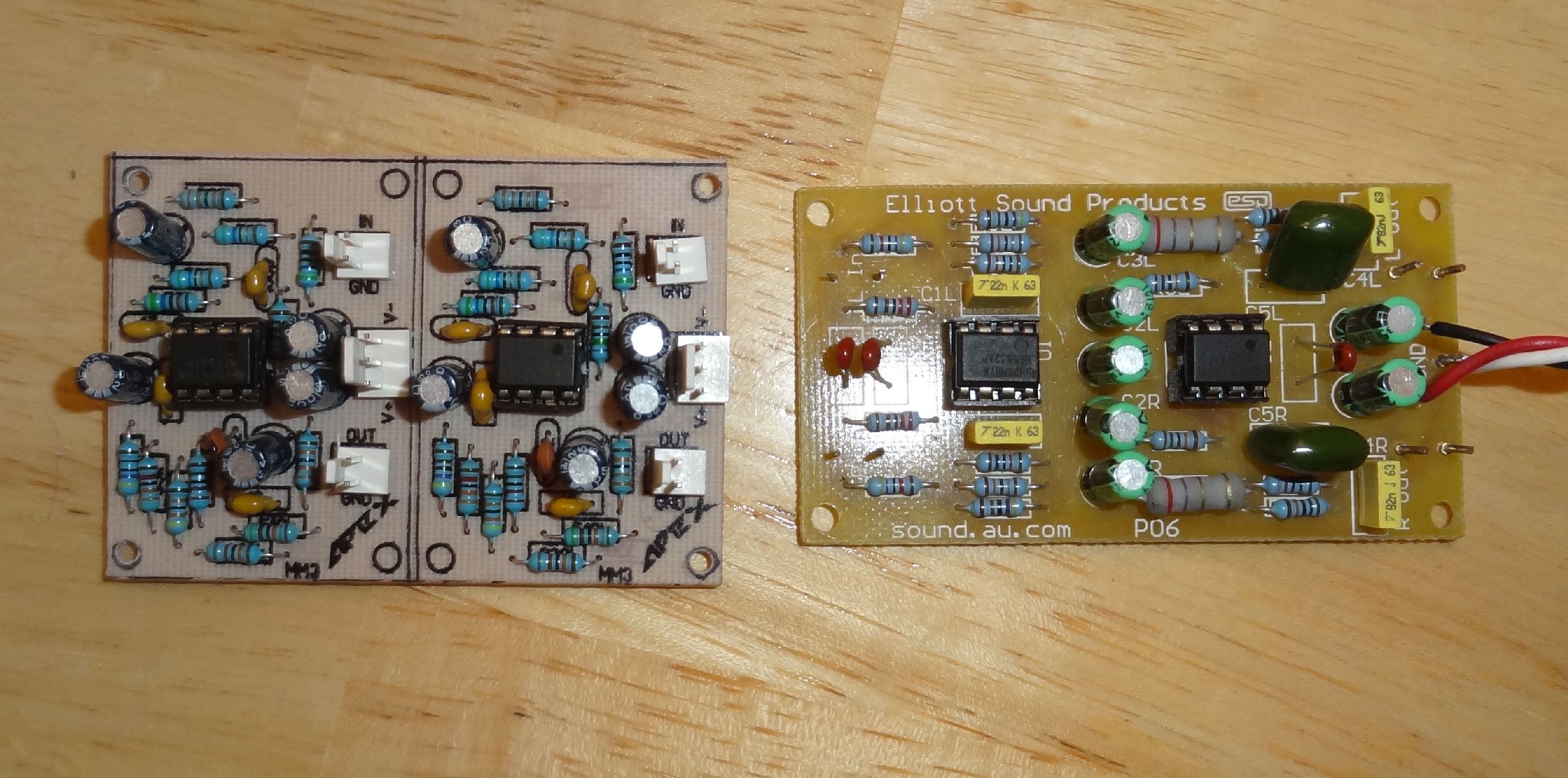

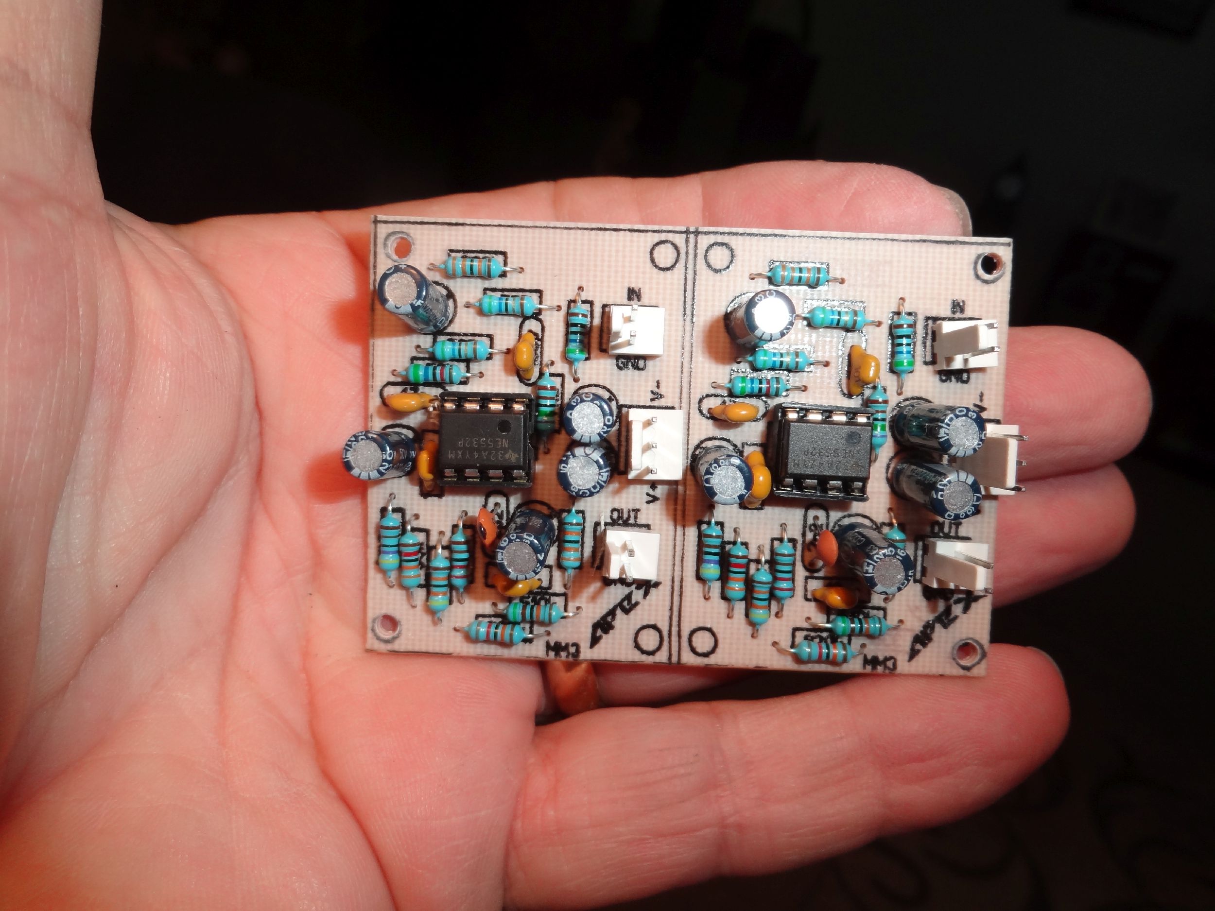

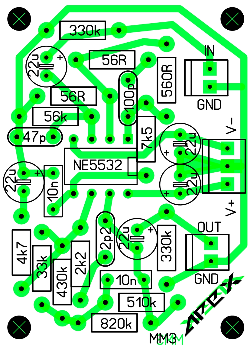

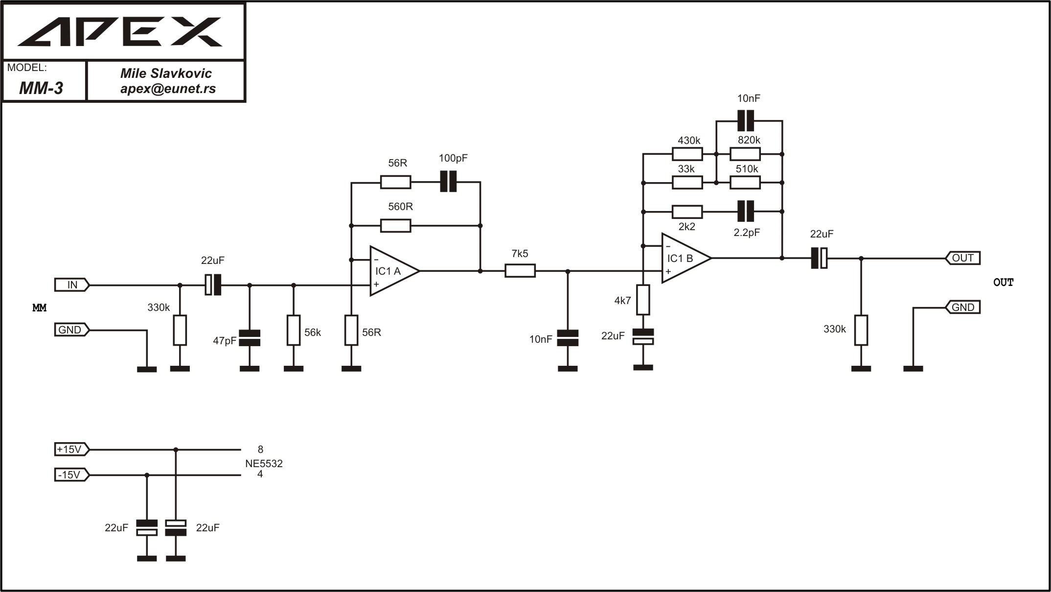

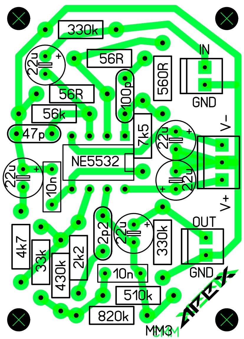

I decided to go with the MM3 phono circuit for this. It is much smaller. It looks like the circuit will be at least as good as Rod Elliot's P06. I etched and populated them this after noon and will get it tested soon.
Blessings, Terry

Nice work, use 10nF MKS

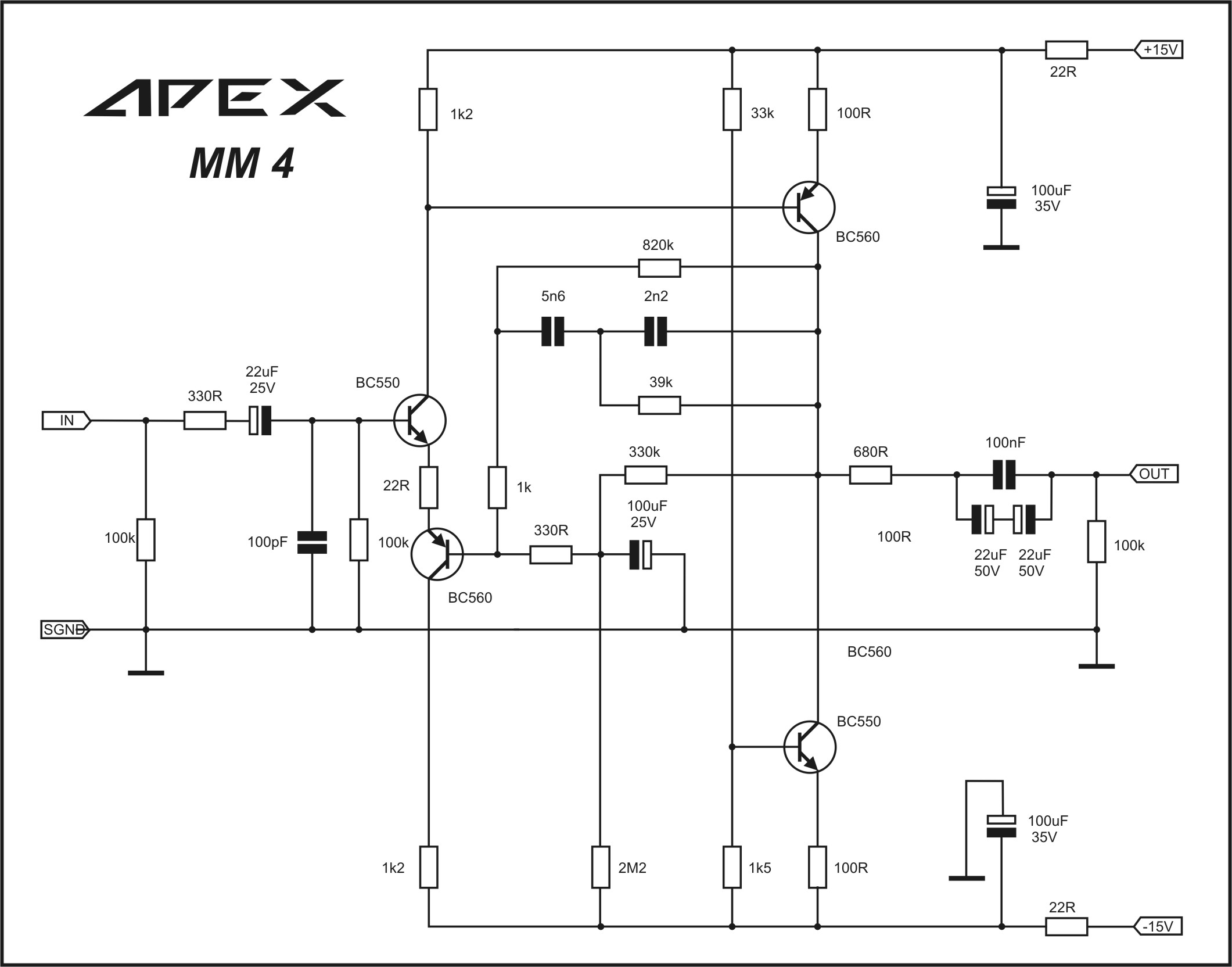

Mr. Mile,
1. Would you recommend a output coupling capacitor for SB 3.1 pre amp? and would a 10uF NP be sufficient?
2. for the zener shunt supply, would it be ok to use 24V zener for 24 VAC supply voltage?
reg
prasi
10uF with 100nF in parallel will be OK... like in P6 and MM4
24VAC after rectifing give about 35VDC... 24V zener will be OK but I use 20-22V zener or 28-30VAC.
Regards
That is cool looking - nice job, Terry.
Yes, dual mono for beter channel separation.
Terry is a master of diy etching , layout is really nice and compact. congrats!Terry, very cool. You never cease to amaze. What you and x do in a few hours takes me days.

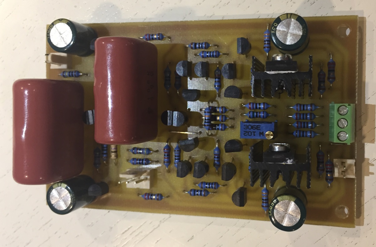

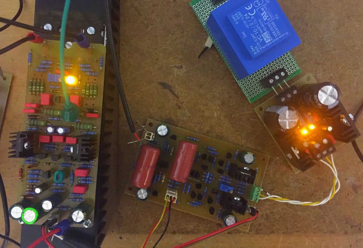

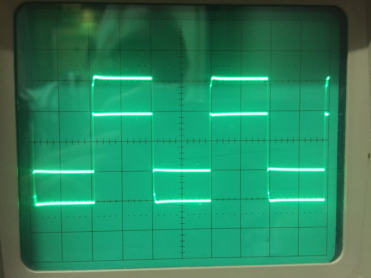

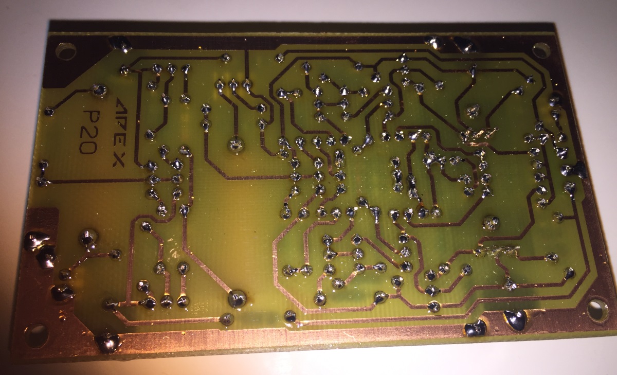

Hi, here is the P20 finished. I have not tested much yet, but it sounds very good. Here are some pictures together with a FR50. The square wave looks so bad because my cheap signal generator is so bad . The picture shows 50kHz. P20 is recommended! I'll try a little more tomorrow or later.
regards Olaf

Nice work, with 1k trimpot you can set THD to minimum.
What is PSU for preamp?
Regards
