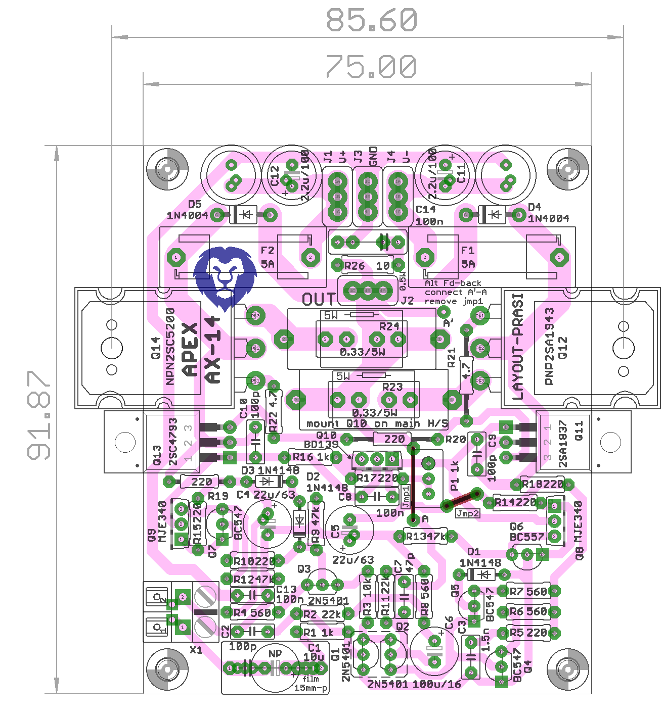

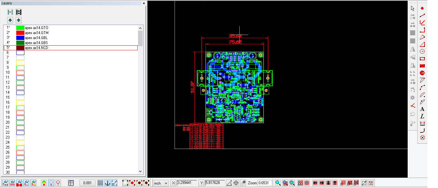

Here are the gerbers
reg
Prasi
PS: Not tested

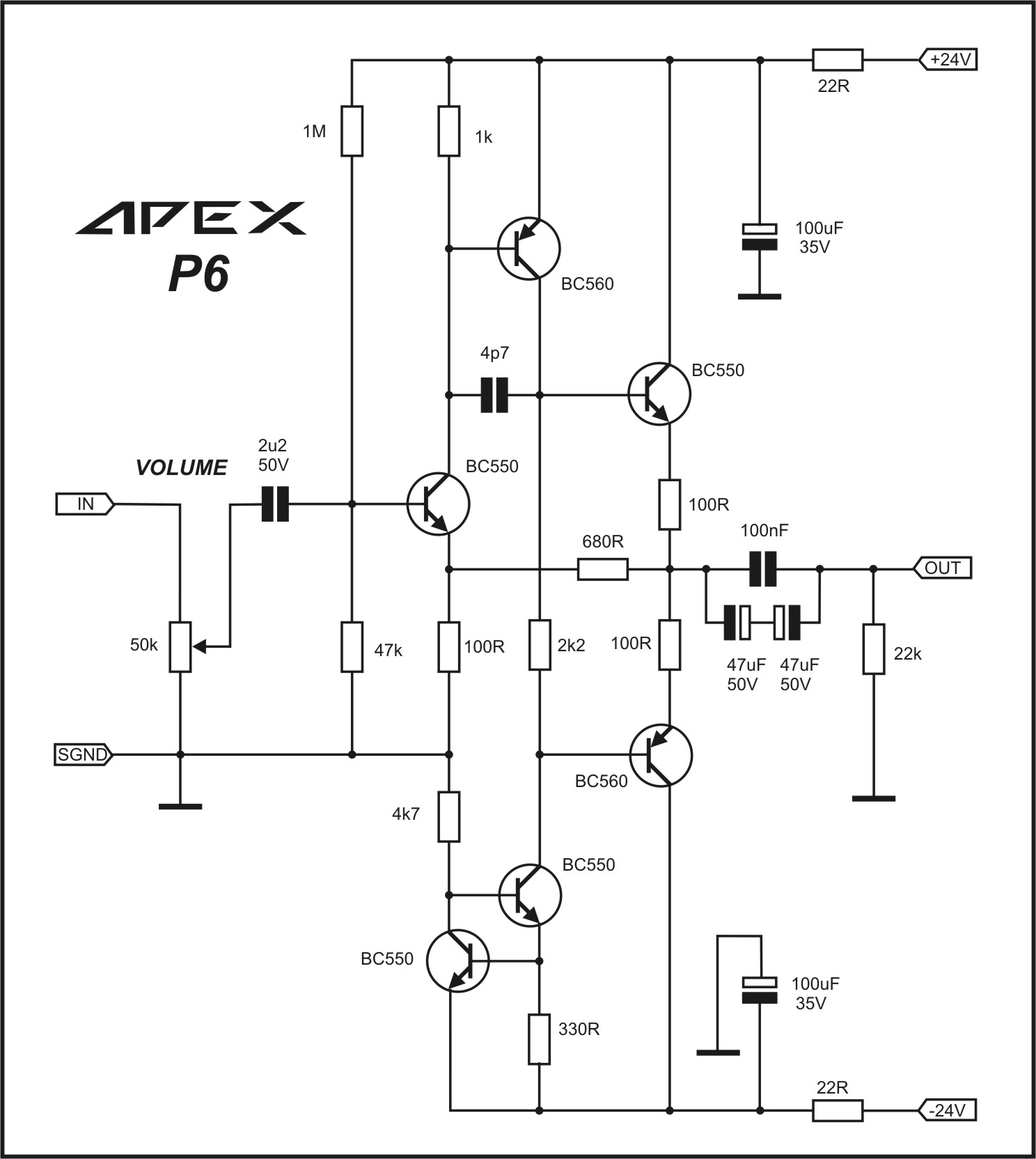

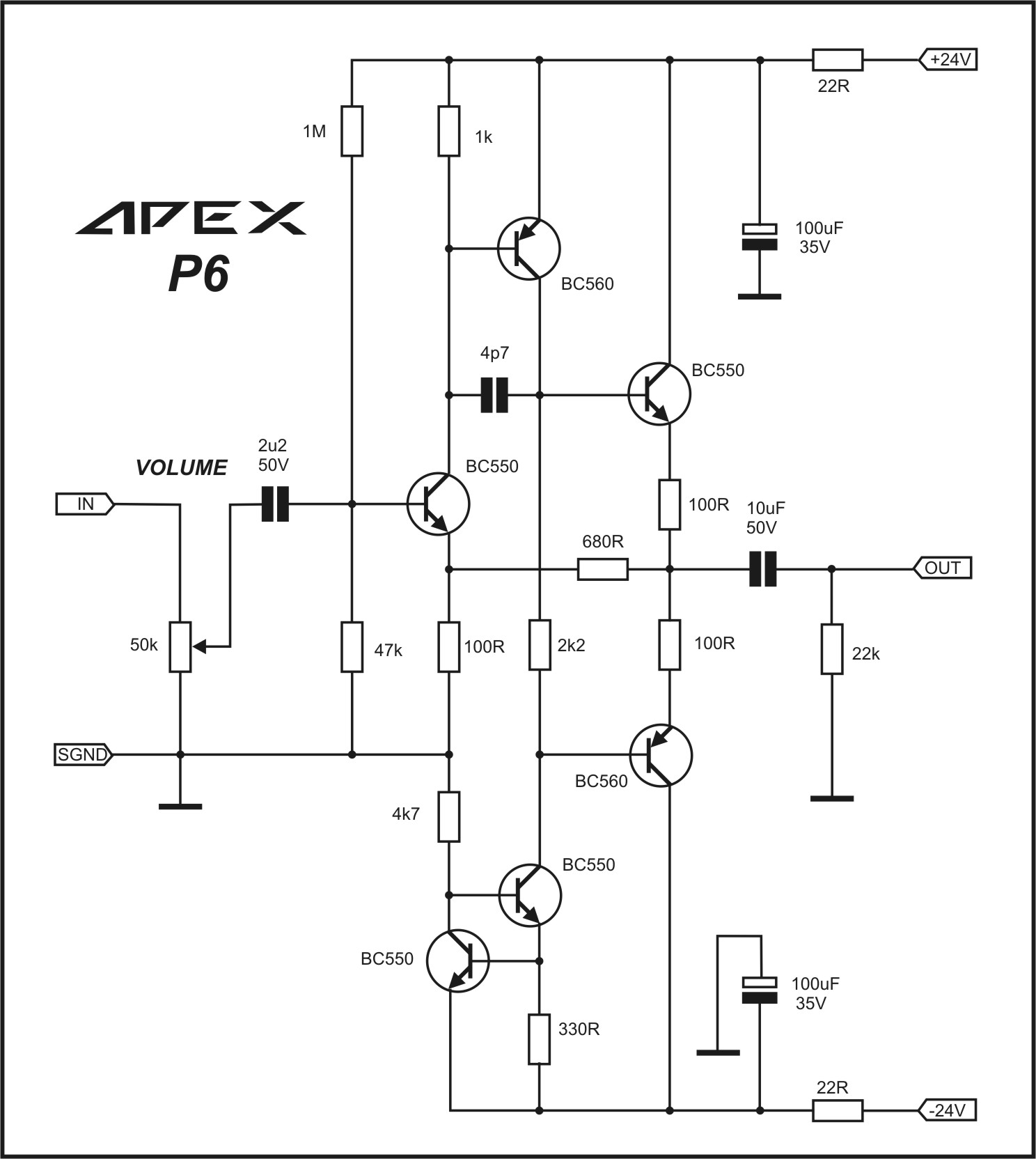

Sorry I wasn't clear. I was referring to preamp circuits without coupling caps on the outputs, not power amps.
I have questions about the PX6 preamp.
There are 2 polarized caps, 10uf and 220uf.
Is 16v low esr enough?
I presume the 10uf cap is for DC blocking. If I block DC, should I have a DC blocking cap on the FX8 amplifier?
What should be the best place to put the DC blocking cap? The preamp? The amp? both of them?
many thanks!

haven't seen px6, but generally, if dc blocking cap is on power amp, is enough. no need for it on preamp...Hi,

You don't need both.Hi,
many thanks!
If you have both, it is more flexible if the lower quality one can be bypassed.
Dual RCA outputs, one AC coupled and one DC coupled (and labelled) is ideal.

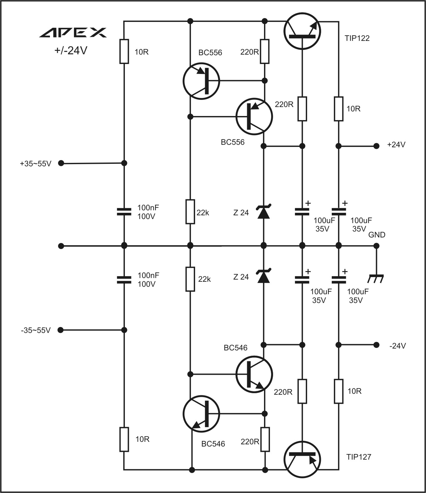

Hi Mr Mile,
many thanks for this update.
If my understanding is correct:
1/ I can now put 7824/7924 regulators on my 35VDC PSU. It is a valuable update.
2/ There is two caps to block DC : 2u2 cap at the input and 10uf cap at the ouput
Do I need these caps as I already have DC blocking caps on my amplifier (electrolytic + orange drop) ?
If yes, Is it better if I copy what I did on the amplifier : polarized cap + orange drop ?
Many thanks.

Use this +/-24V regulator, you need blocking caps for proper input bias.
Regards
