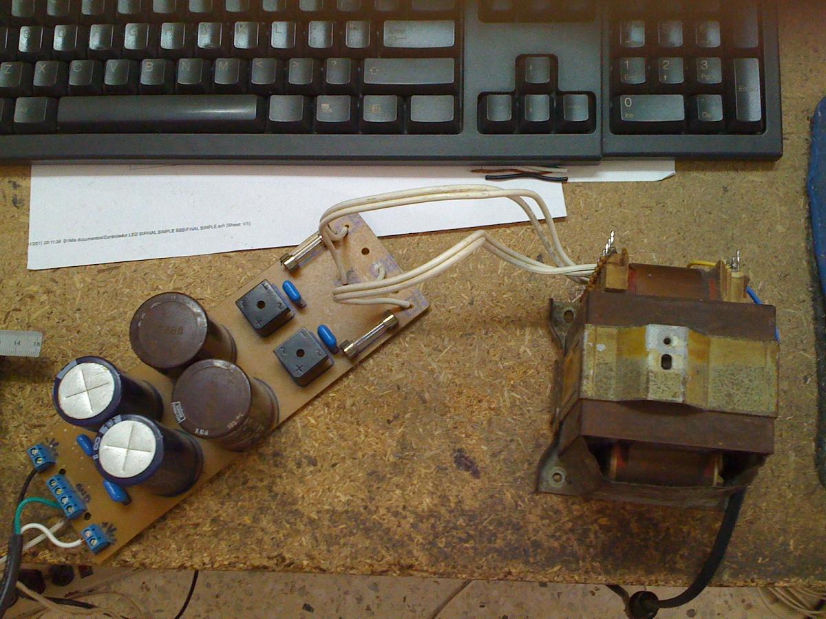

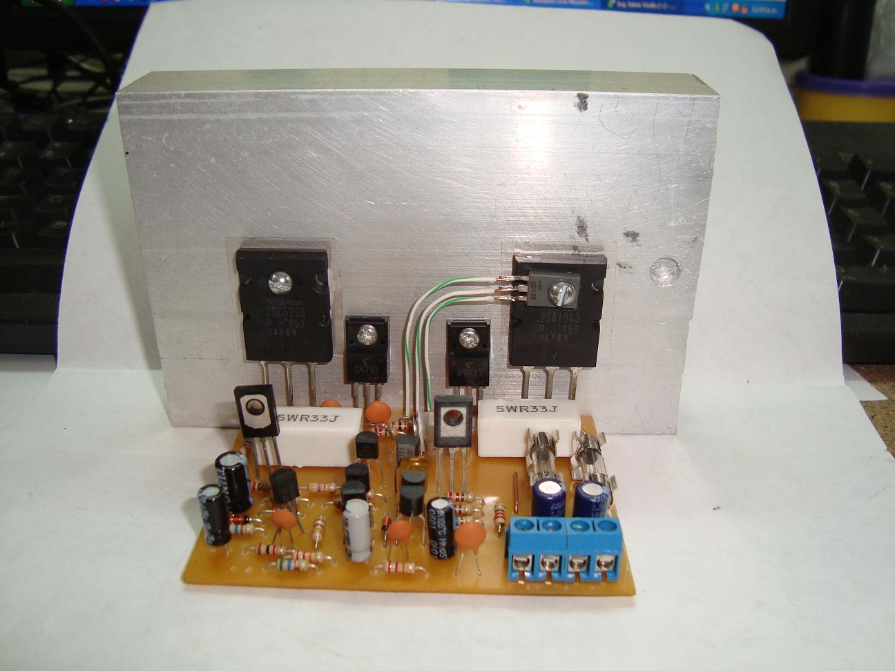

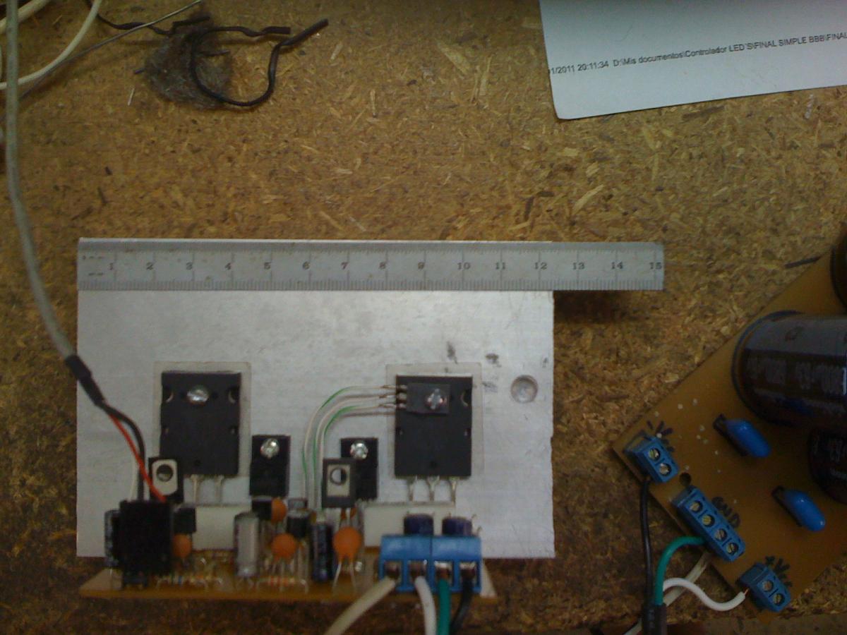

Thanks to Mile for sharing this amp, I built it last week, now I'm testing it, and wanted to share some images and comments.
I'm testing it with a 15 inch pa speaker, and with a 12 inch "home" speaker. I like better how it sounds on the 12 inch, I feel a little more bass, mid and high almost the same. The 12 inch uses piezo tweeters and the 15 inch uses 8 ohm, 1 inch driver.
Trafo is 41+41 Vac, from an old aiwa, rectified is +/-57Vdc, with 10000+6800uF per side, dc offset on output is 6 mv, normal heat while working, but i couldn't measure bias current on the 0.33 ohm resistor, don't know why, i just left the bias adjust on the middle...
I'm planning on using this as a "backup" amp, or for small parties. Next week I'll start the other channel. Price: less than 15 dollars on components. Heatsink, trafo and power supply were recycled from old projects.
When I finish the other channel and the case, I'll post some more images.
Greetings
Luigi

Nice work, I suggest to put BD139 on pcb and connect to the heatsink directly.
Regards

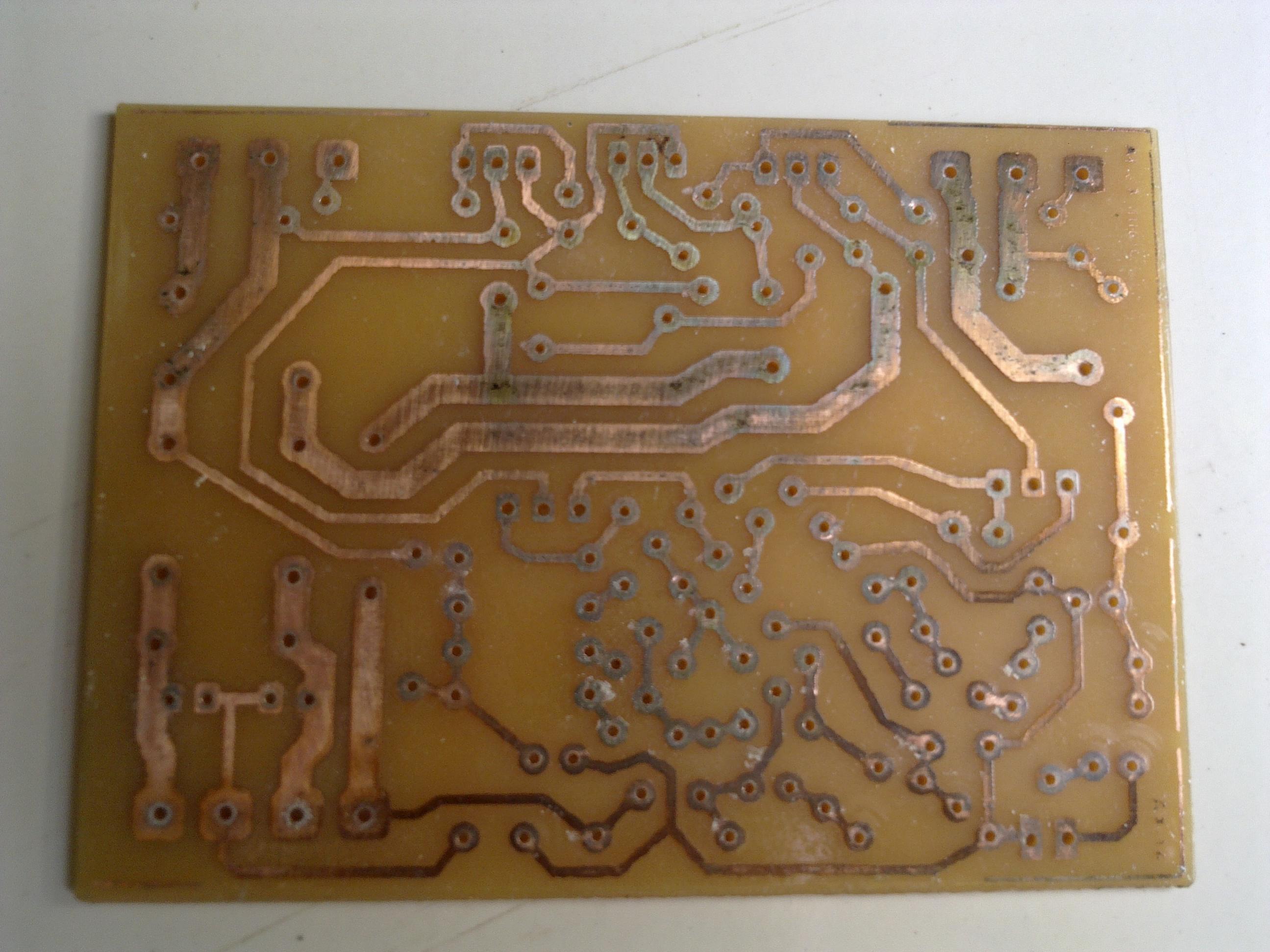

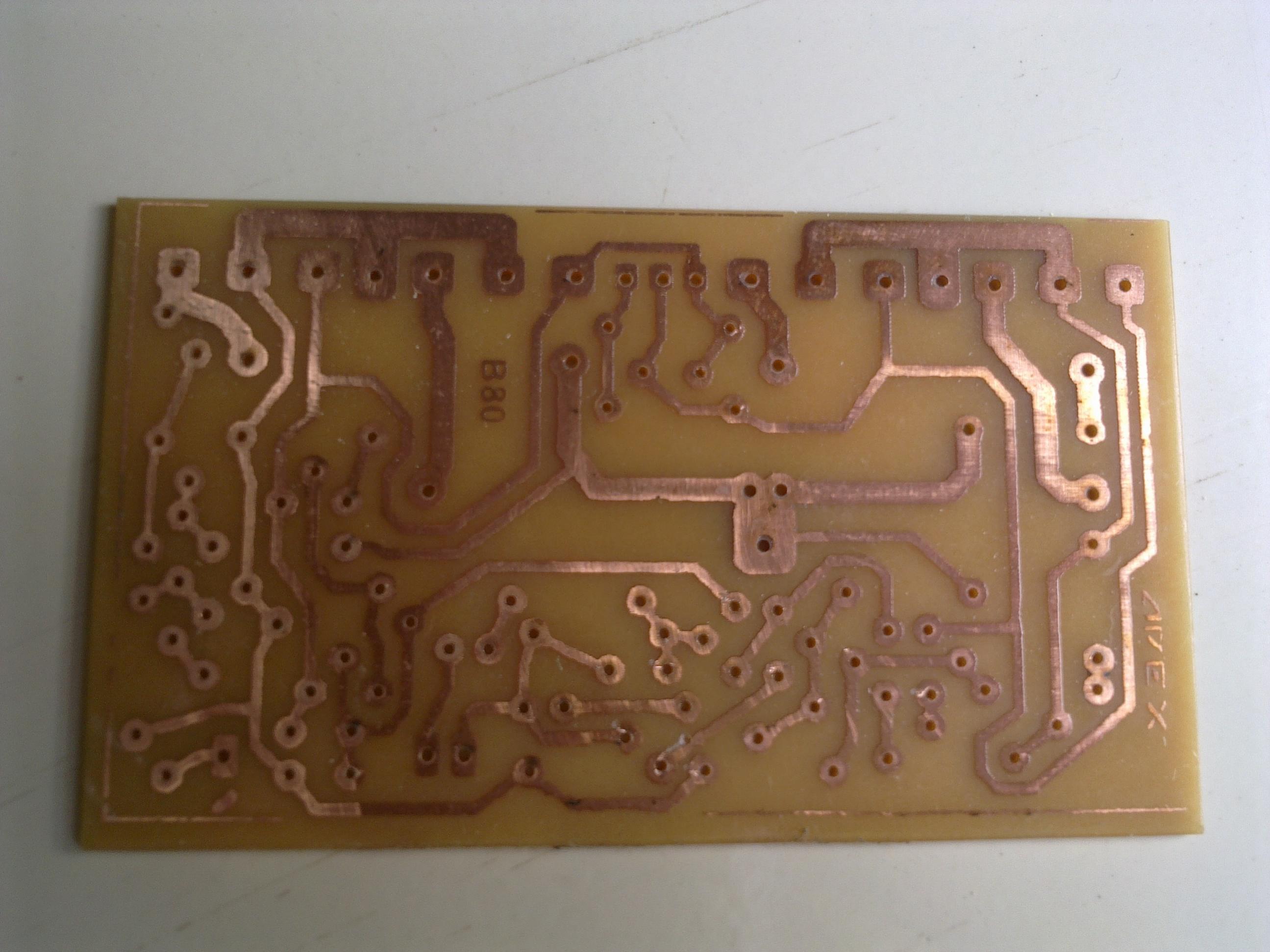

My PCB Apex AX14
Thank you Mr Mile to share the PCB. I just finished printing pcb APEX AX14 and B80, I want to use standard components which are not FET Final to build this power. if I could get the layout of its components?
thanks in advance to Mr Mile. Greeting
http://www.diyaudio.com/forums/attachment.php?attachmentid=213002&stc=1&d=1299484536
http://www.diyaudio.com/forums/attachment.php?attachmentid=213003&stc=1&d=1299484536

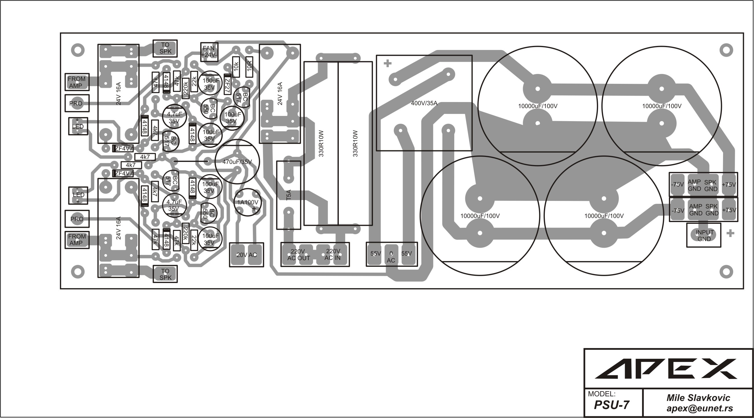

Good ampPlease let me know where I can find PCB Files? I have 2sa and 2sc transistors, and this is a simple amplifierPlease how it sounds?
Post #708, and read the thread for more info.
Regards
Regards
Thanks Mile, it's the first time I've put this transistor that way, but I've seen some other designs where this transistor is over one of the final transistors to sense the temperature directly, and wanted to give this a try. What would be better, over a transistor or on the heatsink?
Luigi
Luigi
It's wrong, temperature on plastic case is lower than heatsink temperature.
