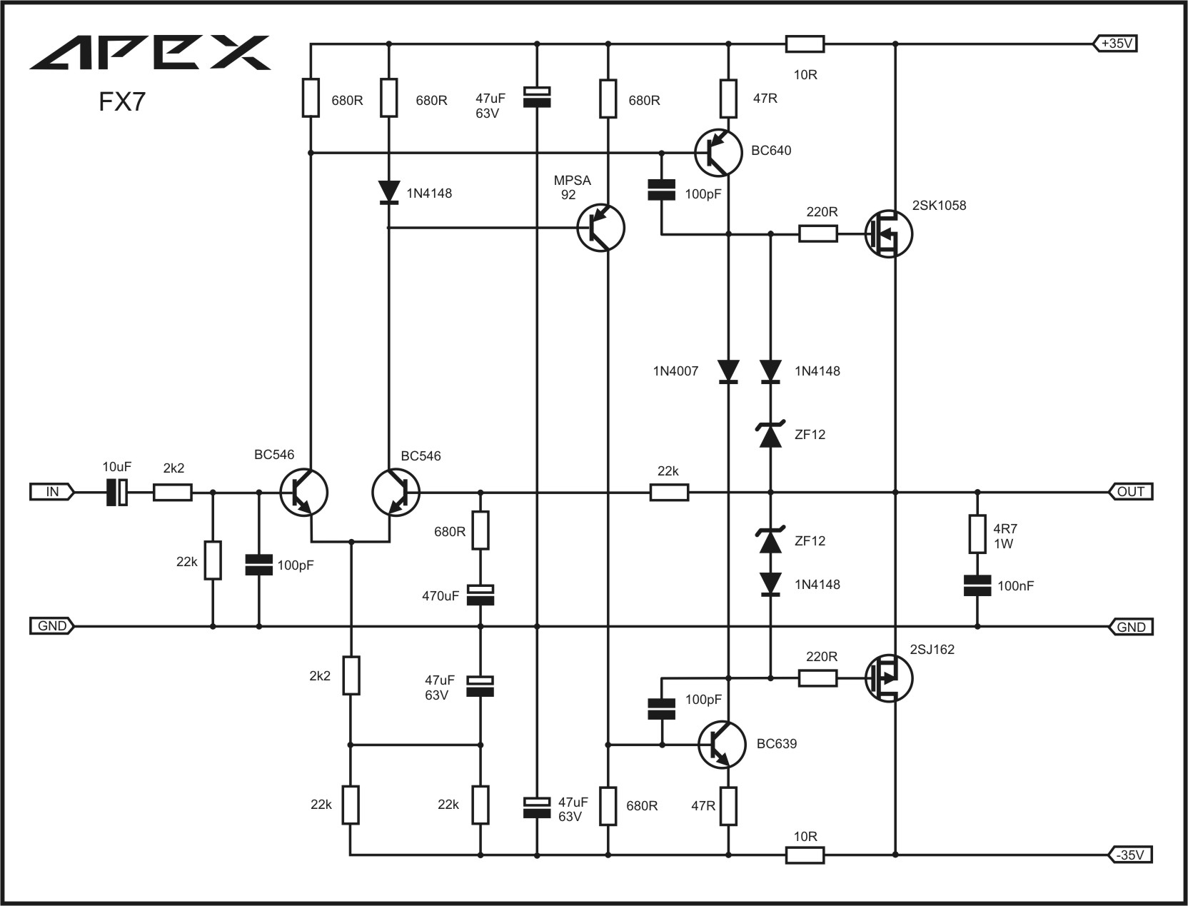

I would like to suggest a few changes.
Omit C6 initially and test what it does after first build.
Replace C9 with a pair of inverse parallel 1n4148
Replace D4+D5 with a red LED to indicate ON. Select R9 to suit.
For C8=3u3F, then C5>175uF
Maximum reliable power is approximately: Sum of all output transistors Pmax @ 25°C divided by 4
i.e. one pair of irf240/9240 gives ~ 150*2 / 4 = 75W per channel.
Choose you supply rail voltage (and mains transformer) to roughly equate to that maximum power.

This could be a good method to compare amp FR, but always using the same speakers, speakers themselves behaving over entire audible spectrum. Ofcourse I am no expert or even an EE, can the same info be obtained from an oscilloscope or some other means? This could answer bass/ low bass/ low highs/ great highs, etc questions.The sound quality is from my listening impressions with base FX8 on left channel and modified on right channel and I switch back and forth but using right input to amp at all times. Of course in mono is all that makes sense.
There is quantitative data in terms of frequency response measurement with calibrated mic at same position with same speaker, only amp changing. It is measurable difference in bass response and lower HD in mids and highs. For some reason, the lateral FETs have a rising distortion from 1k and up. The same board with the mods and hexFETs have lower distortion. This means it might have been rather high to appear at a speaker (>-40dB or 1%). The shape of the response is pretty much the same above 300Hz, with the hexFET more bass response below by about 1.5dB and deeper extension by a few Hz.
I really need an amp distortion analyzer and would like to make a DIY one somehow - suggestions welcome. I am thinking a USB audio digital interface with a resistor voltage divider network and measure signal on dummy resistor load vs a mic?
Regarding cost: MPSA42 is $1.00 for a bag of 50, genuine IRFP240 and IRFP9240 are $4.50 a pair.
latFET are $15/pair
