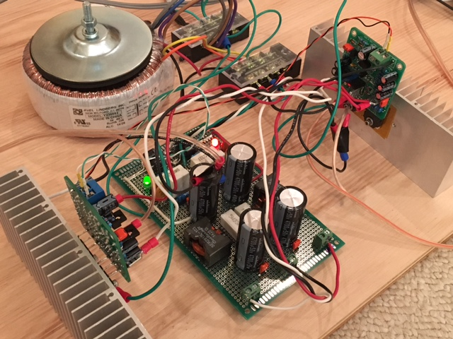

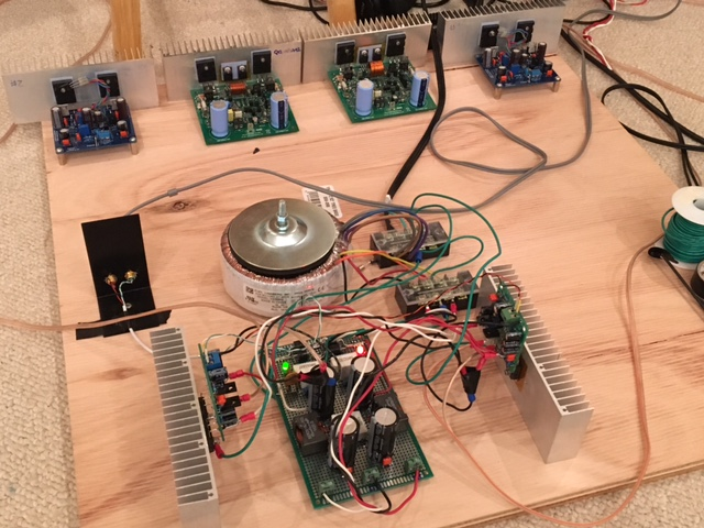

I built up the second unit and adjusted gain to be 36x (20k/550R) and this gain is perfect - great dynamics and no audible distortion. I was missing a 1k pot so used a 5k pot and found that you really have to twist on the screw to get the right bias. When I first turned it on I had 25v across the 10ohm external safety resistor and it took a lot of turning to get it to 1v for 100mA bias.
Listening to it now, maybe on 5 tracks total, so far, very very good amp - actually, excellent amp. Very happy with it. Stereo sounds great.
You can see this is the test bed with a Dx and inverted JFET Circlophone in background.
Closeup of FX8:

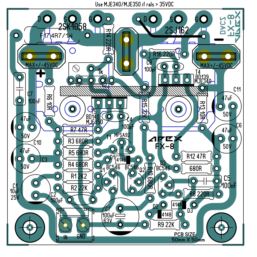

Please show us a photo if your amp is indeed smaller than 50mm square. Did you go to SMT parts or just turn on resistors and diodes on end with a long leg from the top? I don't see how you can squeeze this much smaller (leaving off 4 diodes doesn't make it that much smaller).

That's a nice layout - sans zeners. Are the extra holes under the pot for different types of pot pinouts?

that extra holes are for fixed bias resistor after adjustment thru trimpot.
Unfortunately I don't have the required software to connect my Samsung to computer, so no pictures for now...
If I can get 1/8W resistors then that is my preferred size. But no SMD here... For series FB resistor I intentionally use 1W... Compensation caps (Miller's) are always direct on TR pins below PCB... This time zobel is below PCB to avoid trace inductance...
I consider the estate around the driver and mosfet very important, so no protection diodes there...

Latfet amps IMO tend to have insufficient "drive". This is what makes it's design hard... Even tho not critically, gate stopper (and especially source resistors) will only worsen this. As long as oscillation is taken care of by providing less loop area around gate and source (less parasitic inductance/capacitance), the gate stopper can be made smaller...
Can you give guidance on the layout of the three wires/traces to feed the output mosFET?................ As long as oscillation is taken care of by providing less loop area around gate and source (less parasitic inductance/capacitance), the gate stopper can be made smaller...
Nothing special, only shortest trace possible. Easier when the latfet is arranged in "90 degree" ala First-One or PeeCeeBee V2. Sometimes I used 1/8W resistor directly on the gate pin hanging above PCB (P2P).

Sorry, I think I've probably used the wrong words when I said "loop area"...around Vgs... Compact layout should minimize this area.
