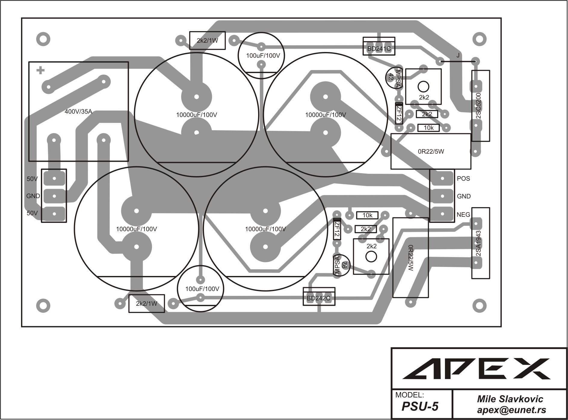

hello sir apex can u share this power supllies in pdf or image pcb layout

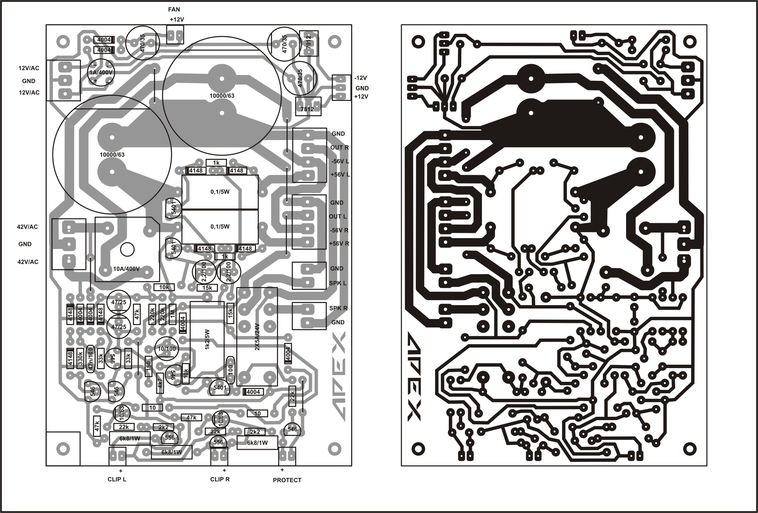

HELLO APEX SIR
CAN I USE THIS PSU-PROTECTION WITH THE SUPPLY OF 36.0.36AC SECONDARY .ANY CHANGES TO MADE?
FOR AX-14 THE POWER SUPPLY ONE PAIR 4700/63V FOR ONE CHANNEL ENOUGH OR ONE PAIR 10000/63V?
WHICH PSU/DC PROTECT U RECOMEND FOR AX-14 .
HELLO APEX SIR
With 2x36V AC only use 1k/5W instead 1k2/5W.
For AX-14 use one pair 10000uF/63V per channel, and I suggest Regulated PSU.
