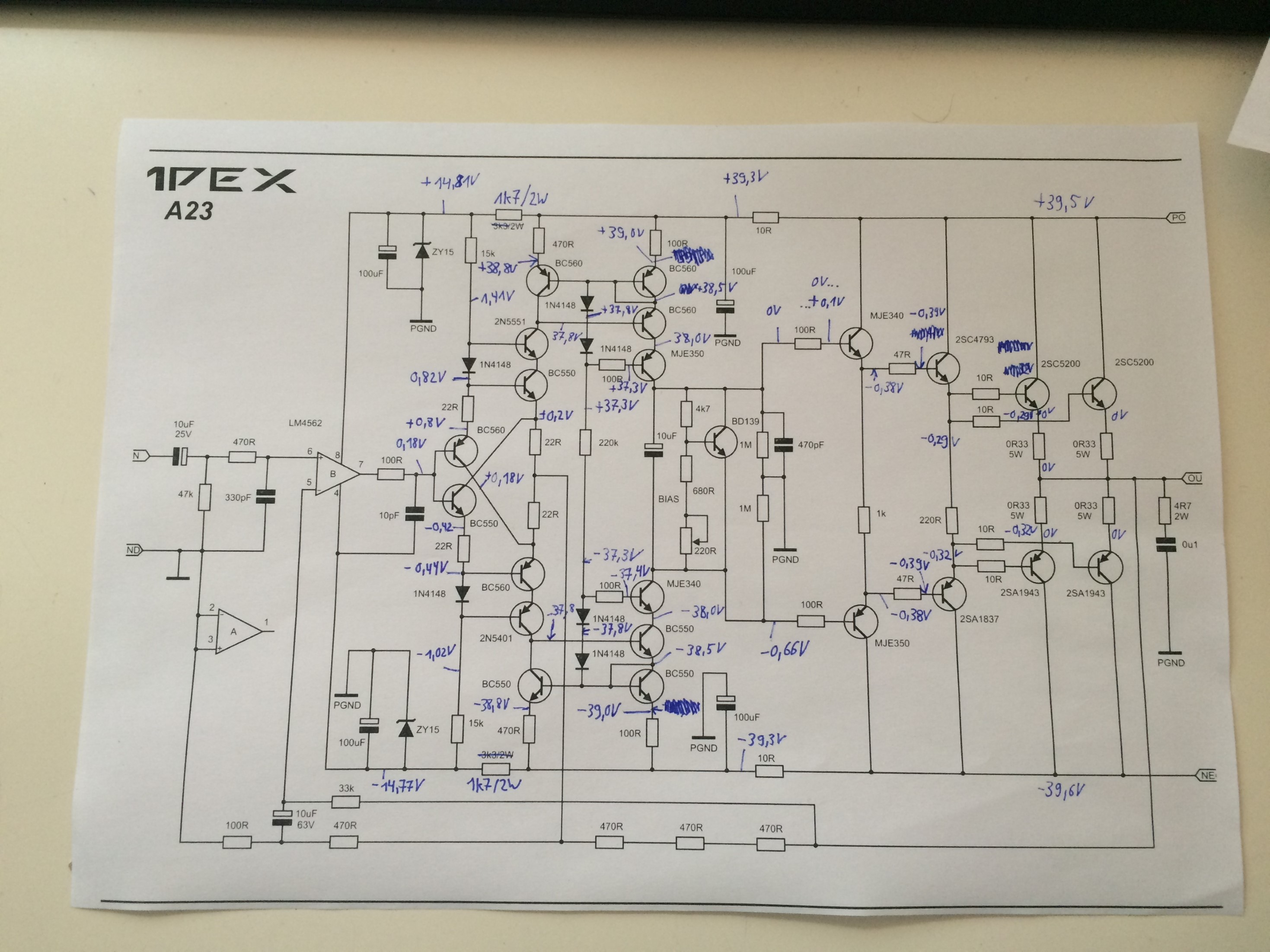

With my Apex A23 Board i added 3K8 resistors in parallel to the 3K3, resulting roughly in 1K7. Now I'm getting +-14,8V at the Opamp. But I still can't get any bias current in the output stage on any trimpot value between 0 and 200R.
I've just taken some bias measurements in the attached picture. For me seems like the input stage is a bit asymmetrical and the bias servo voltage is a way too low. I appreciate any help :).

There must be wrong resistor value 4k7 or 680R in Vbe multiplayer.
Vce on BD139 must be from 3,5V to 4,5V.
