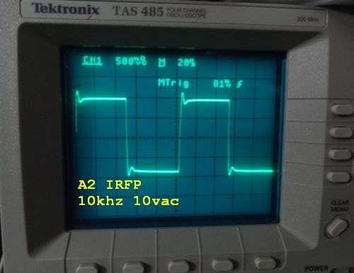

could you add one capacitor change at a time and post your heavily damped overshoot results for each single change?
And then all three added together?
This type of overshoot is very typical of the last few amps I have built and although I can reduce them slightly, I seem to be unable to remove completely. I seem to be adding the comp adjustment in the wrong place.
Then when I add a tiny bit of load capacitance the not properly compensated amp rings badly.
Seeing the results of three different comps may help me understand what's happening in my amps. 4 in a row had similar bad behaviour. The most recent NX is the first in over a year to not show this.
Still4,
Yes, go-step-by step with compensation mentioned by AndrewT,
we must firstly compensate the over-shoot a little bit,
then eliminate one half-period of settling time, but not decreasing SR so much in same time
sistem is now PI(D), with integrator @cca 5,8-6usec (cca 170KHz)
micro-diferenciator is our roll-off BW
The amp is fast (look the settling time), and this is OK!
1. C12
-if you can, put C12 to the other side of the R15 (not to out of OP-AMP, but involving the 47R in the local compensation), !then look at scope!
-then increase C12 by 4p7F then by 10pF... !every change made - look at scope!
2. C11 is our roll-off but also is involved in "I" constant,
-put in series with C11 10K, !look at scope! :)
-increase C11 by 22pF then another 47pF and so one... !look ...! :)
3.At last you must change C10 and/or R21, this is the dumping comp for "I" freq, put 470pF, then try with 1nF leaving R21 unchanged.
With best result then we must trimming R21 to ideal scope response

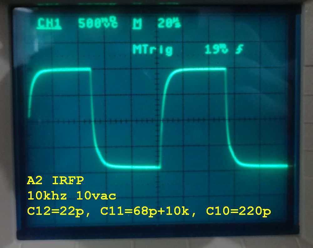

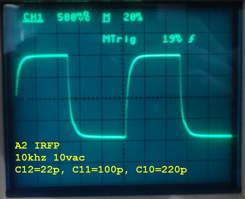

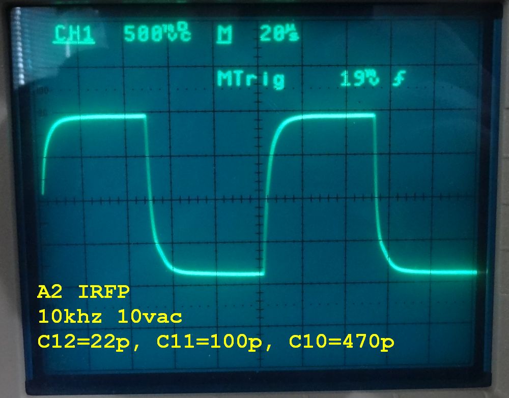

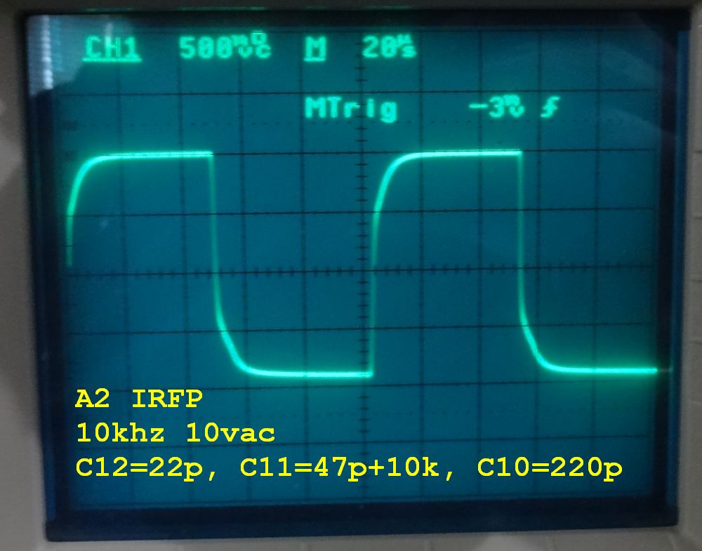

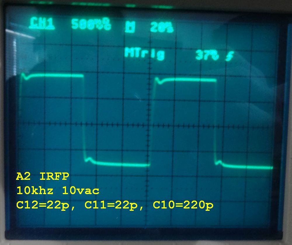

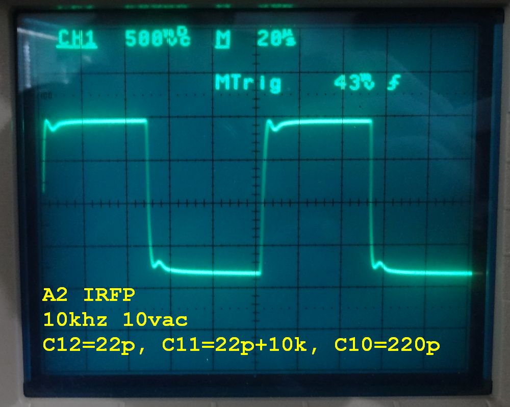

Typing is waaaaaaay easier than soldering. So is sim work. This is what I did so far. I didn't move C12 BTW.

Scope graf with C12=22pF, C11=47pF+10K, C10=220pF looks good, but sligthly to mach comp.
Try to use C11=33pF(27pF)+10K, then playing with that R +/- (use a trimmpot 100K)
a little bit to achive only an small overshoot (read the trimmpot value - take nearest stnd R)
At last you must play with C10+R21, for R21 use the same trimmpot 100K, with C10: 220pF - 470pF - 1nF
The goal is achive square with fast SR, no or just little overshoot, no settling osc period/half period and no osc with 8R0//220nF reactive load.
Regards Still4, keep doing nice works
Dragan
EDIT: try move that C12
With this A2 we are limited/narrow in BW, so don`t expect "perfect" square wave response @10KHz ( or even @ highest freq ),

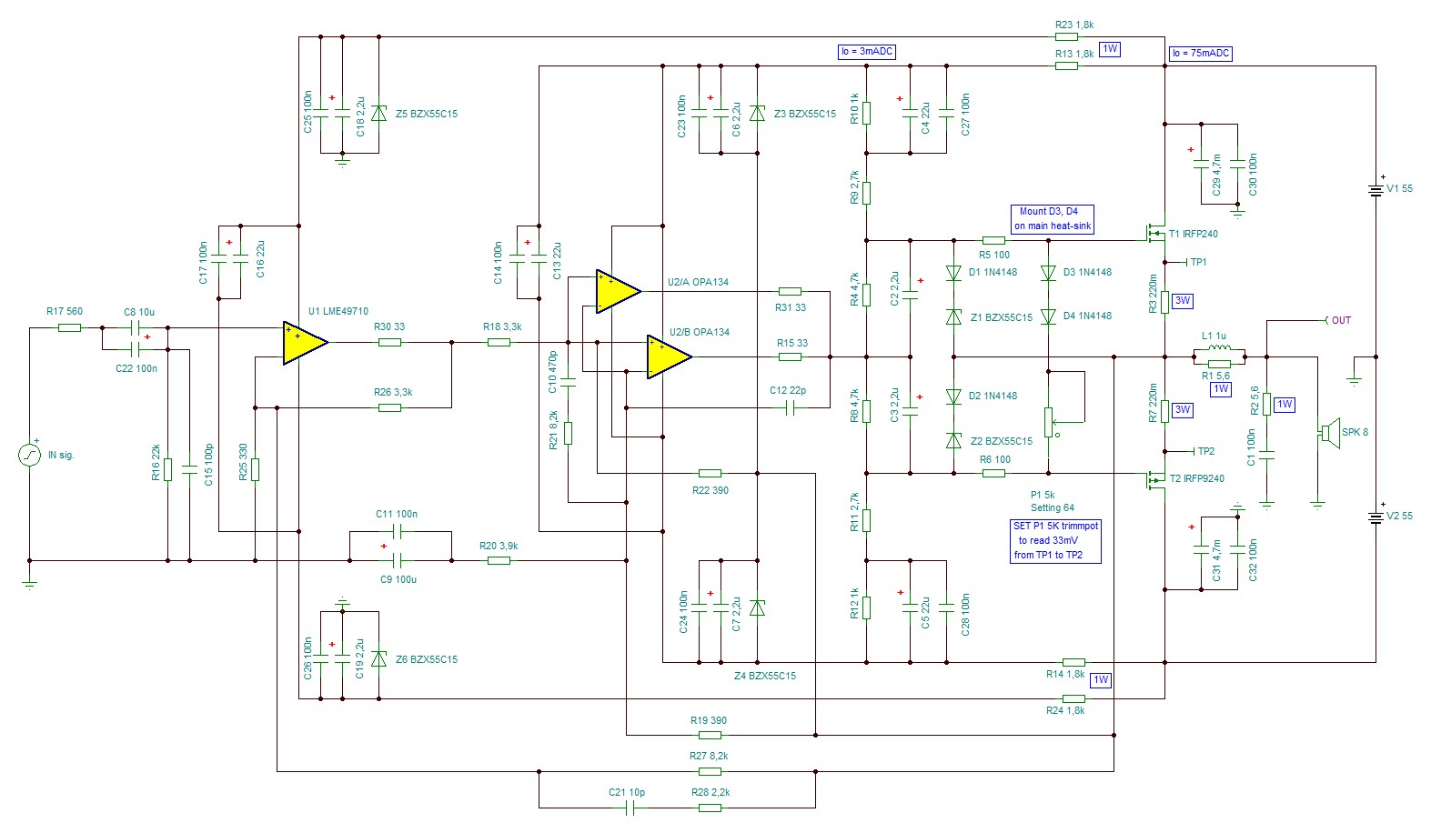

Look at this variation of A2,
uses double OPA2134 for cca +/-70mAp-p drive for output stage (more mosfet pairs, "taught gate charge" ,highest dI/dt drive, ...etc!)
and the gabarits/dimensions and price are same, but now we can lower the gain of "VAS" stage, with acquisition in wider BW.
In front there is LME49710 with stnd +/-15-18VDC supply respect to GND, with tree functions, input buffer with gain,
control local NFB, and most important global NFB-PID supervisor with excellent performans.
Now we got almost 370KHz BW @(-3dB) roll off, plenty for needed high harmonics and good BW for much better square wave response.
Phase in audio section is flat 0° +/- 2-3°
THD is about 0,001% @1Waverage (we call this RMS :) ) with 8R0 non-reactive load.
Input voltage noise is under 10nV/sqrt(Hz) like preap :)
SNR 106dB@1KHz
PSSR more than (-)105dB on both pos and neg rails 100Hz ripple
Klipping almost at supply rails.

What is the reason for the added 10k resistor?
-is there floating-bootstraped opamp driver supply respect to output

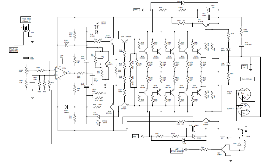

I will play some more, but with BJT output, which looks better to me :)
MC2 E15/25 output stage schematic attached. This is absolutely the same concept in case of the driver stage.
Sajti
