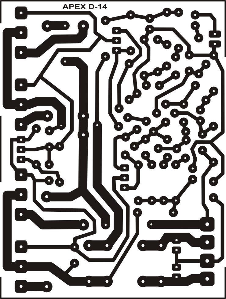

irf trannies are not available at the place where i stay.2sk1530-2sj1201 are very costly they cost 22$ a pair here. Where as 2sc2922-2sa1216 are available for 8$ . so amps based on these are which i would like. can d-14 be used with sanken trannies-2sc2922.
please post pcb of d-14
Also is there any difference in output or sound quality when we use 2sc2922 -2sa1216 in place of 2sc5200.

D-14 use darlingtons, 2SA1216/2SC2922 (if not fake) can be use for B500.
Regards
Try ApexAudio's TIP147-142 Darlington based Amp.. Tip142-147 are cheap in India about Rs.45/- each and the Amp also sound good.
AX-12 from post #135 use TIP142/TIP147, but TIPs can be use for D-14 also.

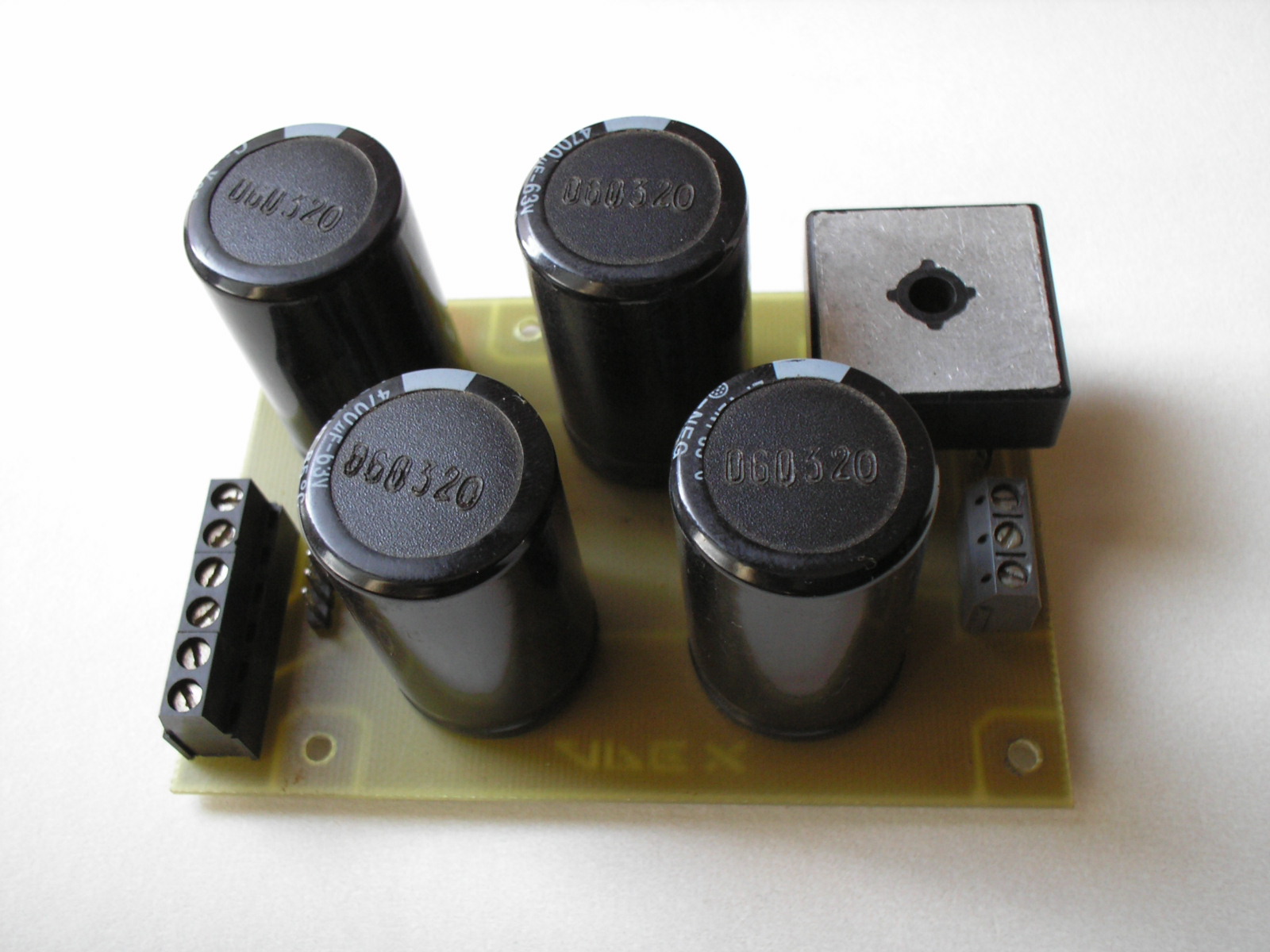

This is PCB for amplifier PSU with 4x10000uF/63 and 35A/400V bridge recifer.
what is the pcb size?
PSU pcb from post #90 size: 105X70mm
